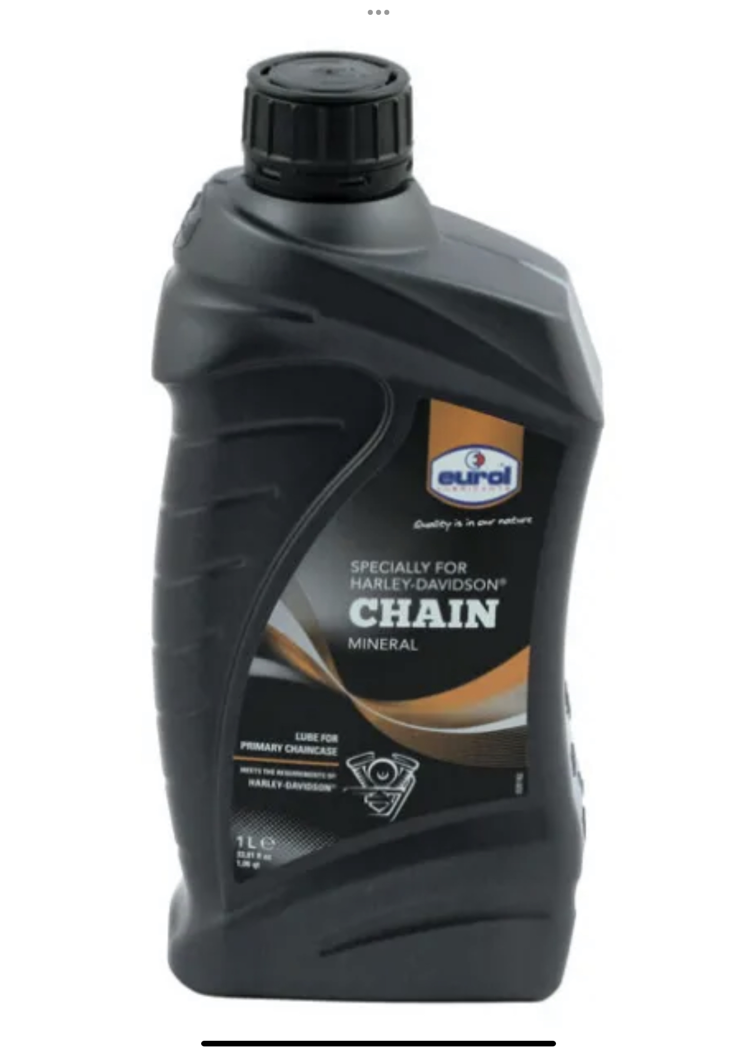

Eurol primary chain oil is…
Eurol primary chain oil is another one recommended for Harley Davidson - I have been using it for a long time without problems. Around €8+pp for 1l on ebay.
