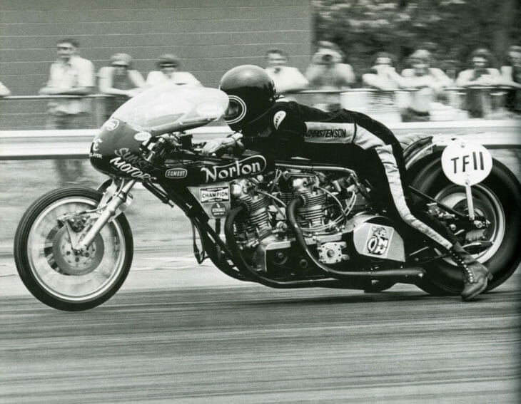

Hogslayer!

Don't forget this ran on standard Norton connecting rods!
Hogslayer, the man who built it John Gregory told (me, not sure who) , that in the early 60s they ran nitro burning bikes with the early 650/Atlas rods that had less meat around the base, the Bracebridge Street jobs, and he never had one of those break either, he said it was just important to have them torqued up to spec, and that the 500/600 torque figures were not used, as he thought this was the problem with the bigger motors, people got the torque figures confused, i.e. tightening up Alas rods to the smaller capacity bikes figures.
