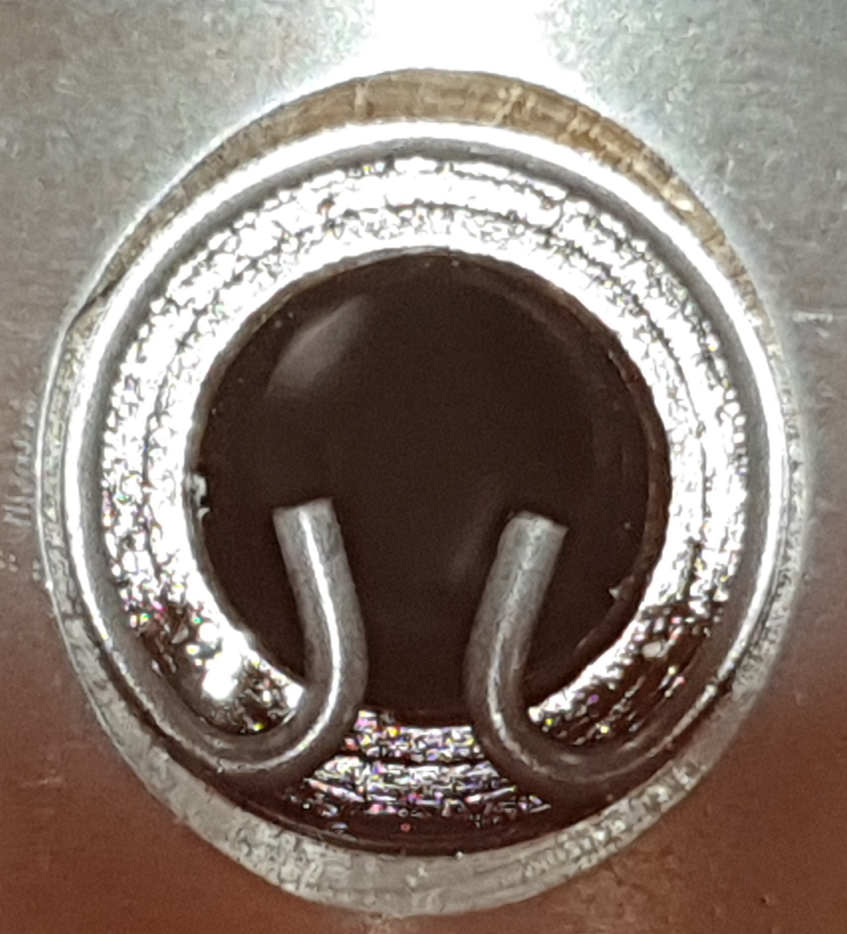

Can anyone please assist? I can't fit my JP piston unless I can source a pair of JP circlips. The picture shows GPM clips...they are only about 1/3 engaged. They seem to be 1.5mm when JP are 1.4mm diameter. So far I have drawn a blank with the usual suppliers.
The pin is 11/16".

The JP I'm trying to fit is from Australia. The badly damaged one ( which is now the wrong shape) is NOS English Heppolite.  Alan...it seems like what are known as the Seger type are standardised, but wire ring types are not. The JP ones seem to be 1.4mm wire with one end turned in at a right angle. GPM are 1.4mm with both ends turned in as loops. The Triumph ones I saw yesterday are simple broken circles only 1.2mm wire and I believe the pistons have a little notch so you can get the tip of a small screwdriver beneath the wire to remove it. USA Wisco are much the same. People write "never re-use" but they don't seem to stock and sell spares.

Thanks very much to all who responded. I finally found a correct pair. Meanwhile I have learnt a lot more than I expected about gudgeon pin/wrist pin circlips, snap rings, seeger clips and the wide variety of wire sizes different makers use.  For future reference....GPM wire clips can be bought new from RGM. They are 1.5mm wire size, and have both ends turned inwards. JP wire clips cannot be bought separately from pistons unless you or the dealer (Thorton) order from Australia. They are 1.4mm with one end turned in at a right angle. Rectangular section 'Seeger' clips are to a standard (DIN) and were used by Hepolite when it was Hepolite, and perhaps are used by them today. Wiseco (US) and others use wire 'snap rings' which do not have ends turned in. Their pistons have a little notch into the groove so a screwdriver tip can be used to extract the ring.  All very non standardised. The first lesson (if there is one) is: never lose a piston circlip! The second lesson is: don't bend it permanently when fitting but also when removing, just in case you need it again.
