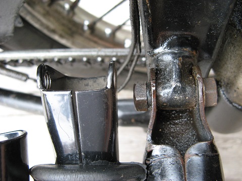

My 51 ES2 is missing the right side pillion peg mounting lug; called the "B4/686 Frame pillion footrest lug". See page 69 of the Norton Spare Parts List, bottom of Plate Y.
I have been hunting for this lug but realize that unless I find an ruined frame and rob it for this one lug...I will have to take off the existing left side lug and fabricate a replica.
In the meantime, I ordered new footrests and rubbers from the NOC but they are quite different from my remaining original; see photos. They have the same threaded hole on the left side, but they are 1" instead of 3/4 centers and the internal diameter is VERY different. As if it was meant to fit a much wider lug.
So...am I missing something ? Is there an earlier and a later period foot rest ? or is my existing left side foot rest NOT a real Norton footrest ? It had an ancient John Bull rubber on it but I did not expect the metal part to be wrong. I can cut and bend down my new foot rest to fit but that will be a fair amount of drilling and blasting...perhaps there already exists the correct sized part ??
Can anybody enlighten me ?
and (grasping at straws here)...does anybody out there know where I might find one footrest mounting lug.
Grant MacNeill, Toronto
Attachments IMG_3240.0.JPG IMG_3243.JPG technicalHi Grant. I have a 52 ES2…
John, Thanks for confirmin…
John, Thanks for confirming that my one remaining lug is original and correct. If by some miracle I find old pegs that are 3/4 spaced then sobeit but I think I'l take your advice and make up spacers to fit the new pegs.
Easily enough done but I'm also faced with making up a replica lug for the other side which will be a bit of a chore. A recent ES2 "chopped" plunger frame on eBay went for $350 plus shipping which is more than I'm willing to pay for the one lug ! (grin).
Thanks, Grant in Toronto
Shame your in Toronto Gran…
Shame your in Toronto Grant. Fairly straight forward item to make up on a lathe. John

Hi Grant. I have a 52 ES2 with original rear rests and are identical to your first image, 3/4 inch wide lug. Depending on your desire for originality, two spacers could be made up to keep the new part central. John
