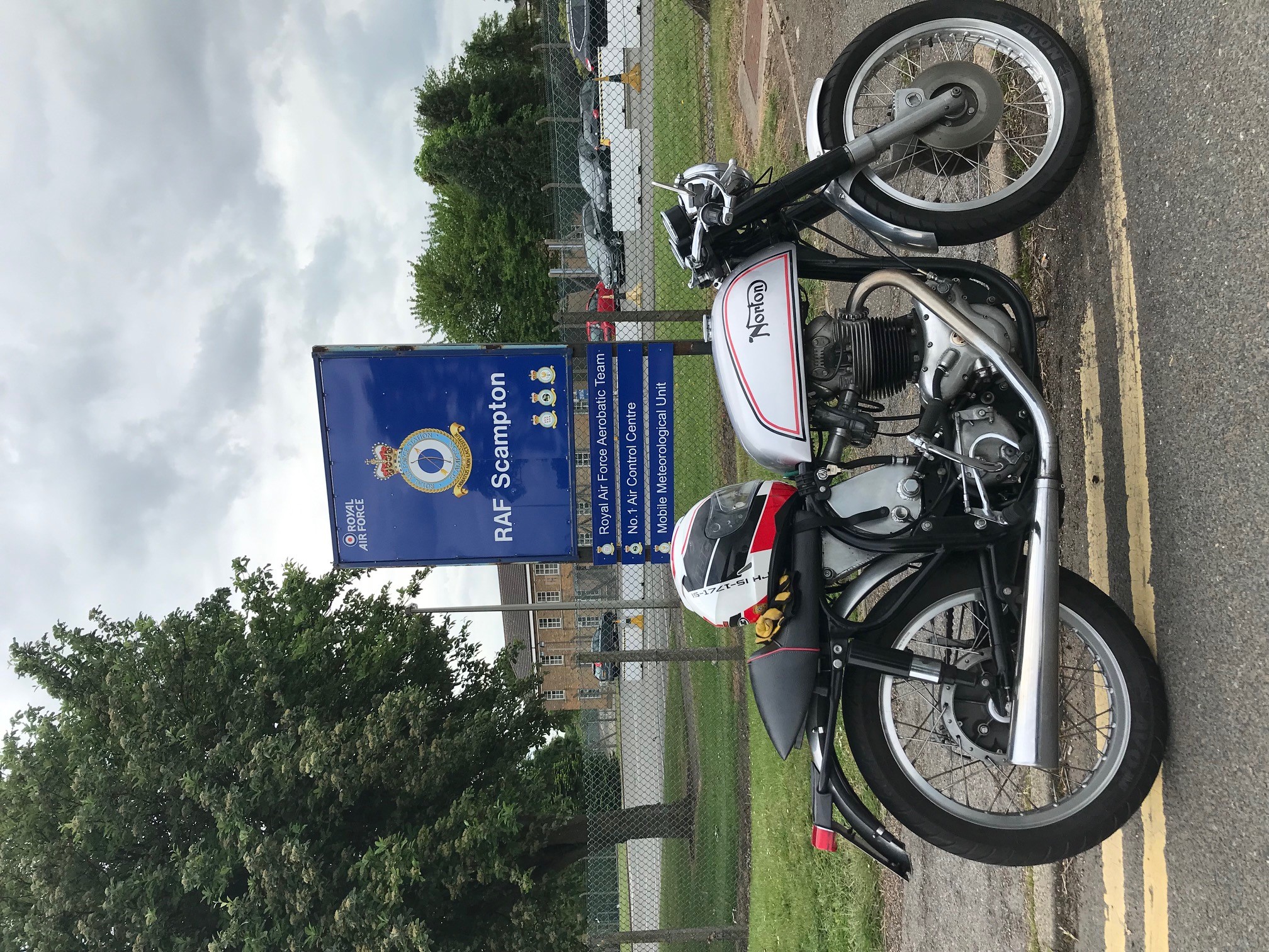

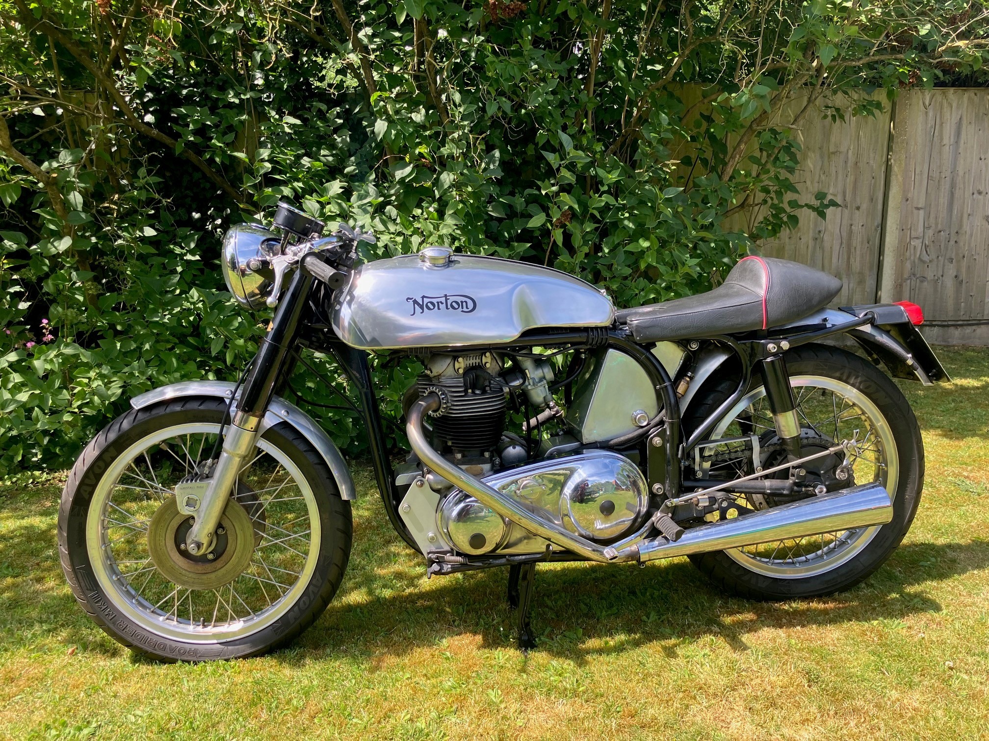

Hello William, first I apologise to you for not responding to your request to contact you. Your bike looks great and is a credit to you.

and very nice looking machine!!
