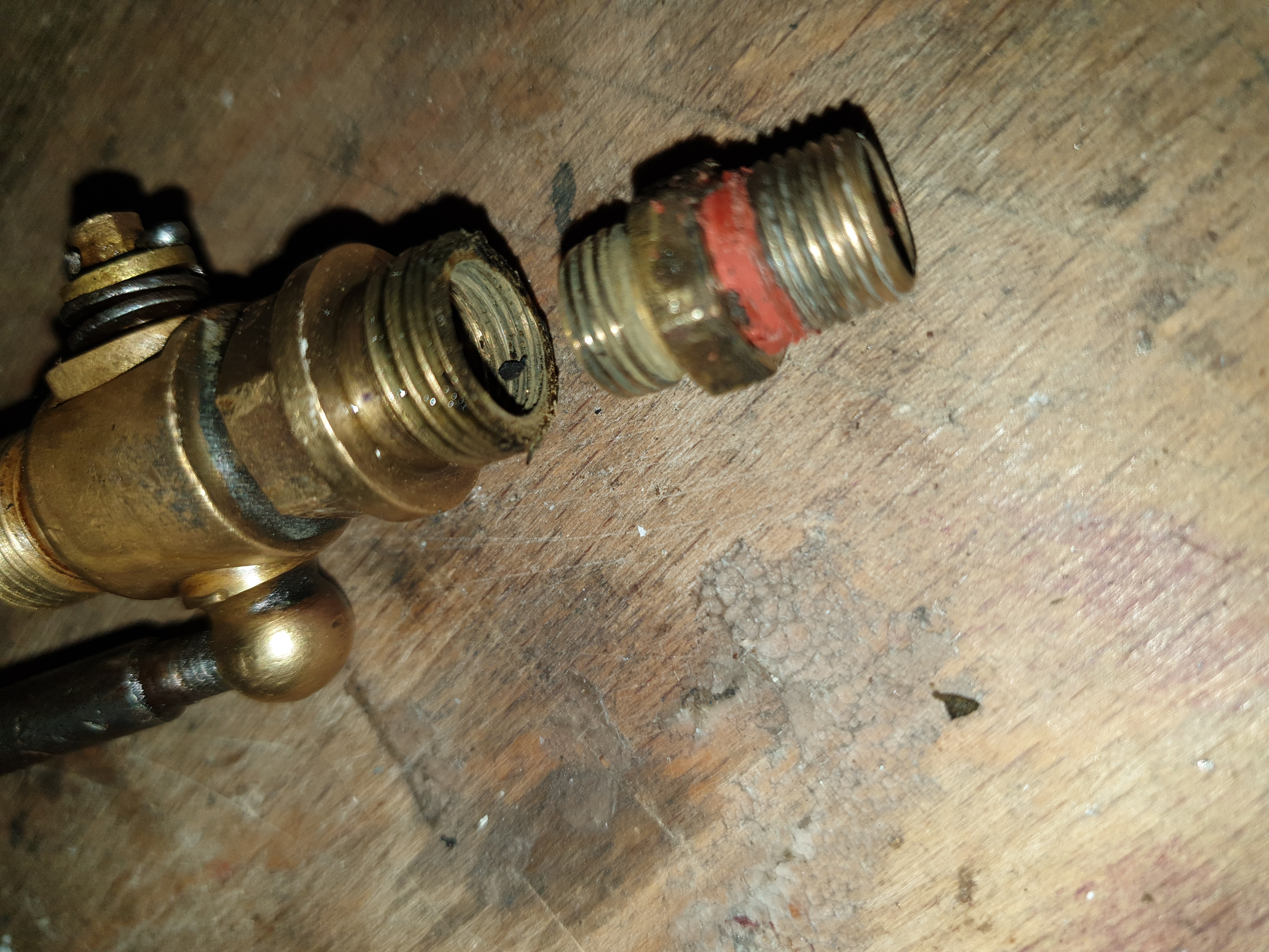

I am following the fuel tap threads with interest as the tap in my newly purchased Jubilee leaks and as the image shows, the previous owner tried to seal it with some kind of shalak. My simple view is that it's the wrong tap!!!
Any thoughts or comments appreciated.
Also be good to see what the tap SHOULD look like, so show us yer taps!
 The  bottom thread is 19 tpi  but 7/16" OD  with a  bsp/gas thread form.   From a BSP perspective it appears to fall exactly between 1/8 and 1/4 BSP.    (but with the same bore as 1/8 bsp !!.  All very interesting!.  Can't imagine why they used such odd sizes.  If it were mine I would consider drilling and tapping the tank to !/4 bsp  so I could use the commonly availiable   taps with 1/4 bsp top and bottom.  ( if there is enough metal ! )   Or you could buy my spare correct  tap!!

This is what I've uncovered this afternoon, I believe the tank fitting is 1/8 BSP  the other end, fitted to the tap, looks straight...
