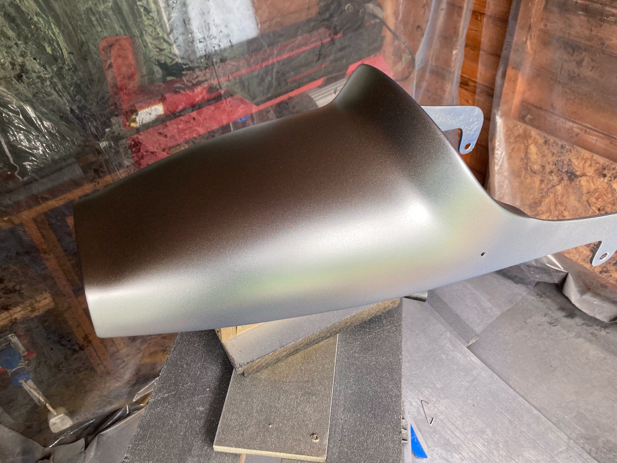

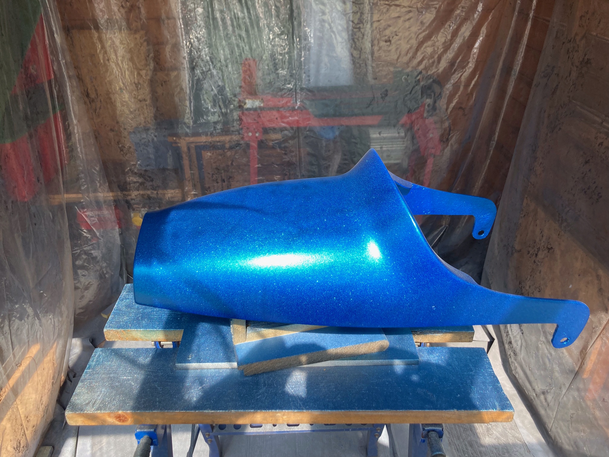

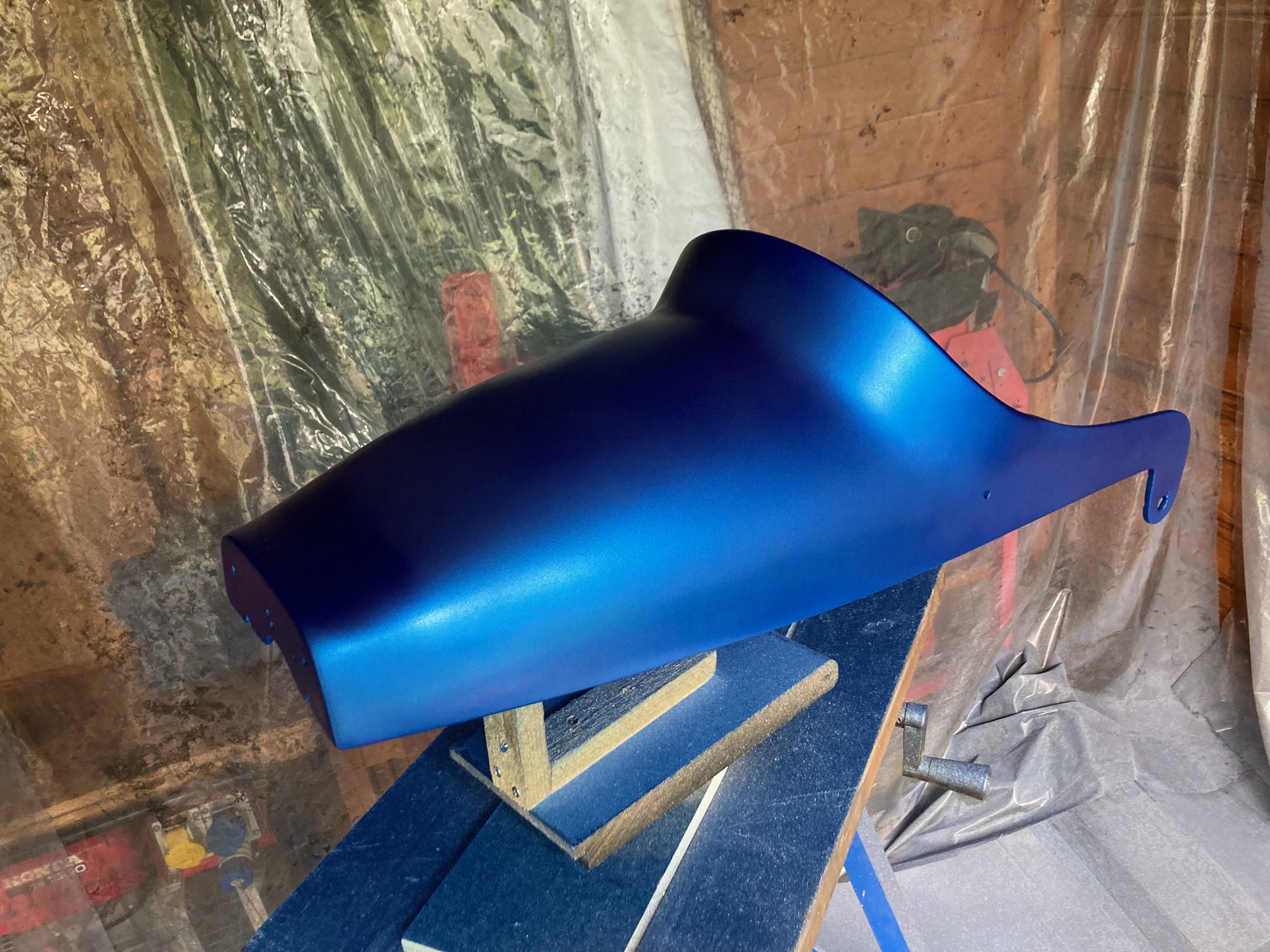

I have a similar situation. I have a good Fastback tank in original Fireflake blue that has never had ethanol in it. I plan to use it for a while with E0 petrol before going to the expense of painting it. So I wanted to paint the tail to be an acceptable match. I used rattle cans from Custom Paints. Using a coarse silver metallic, followed by their metallic blue base and then fine blue flake. I am now in the process of clear coating with their 2k product. The colour is close to the original and is the best I have found so far.
I have attached some pics of the stages. Feel free to message me if you would like the exact paints I used.
