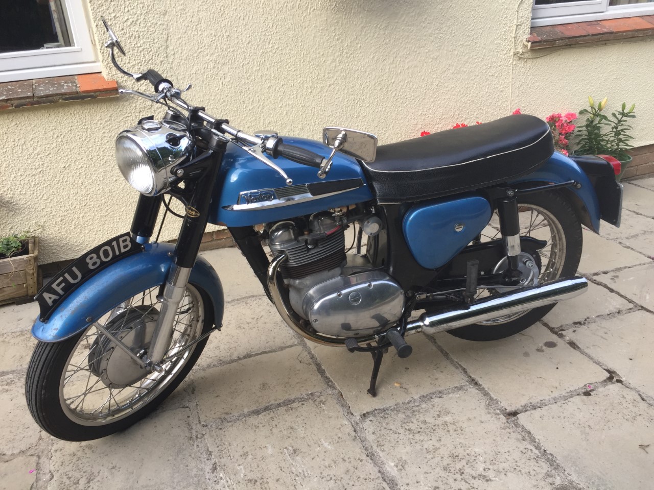

Gave the Jubilee a bit of a wash in the sun today, she’s no show pony but shines up well!
dan
Out in the sun
It's looking really good Dan…
It's looking really good Dan and love the Roadholders! How's it running? What a shame the Jubilee wasn't marketed with decent set of forks and front brake - how does it handle?

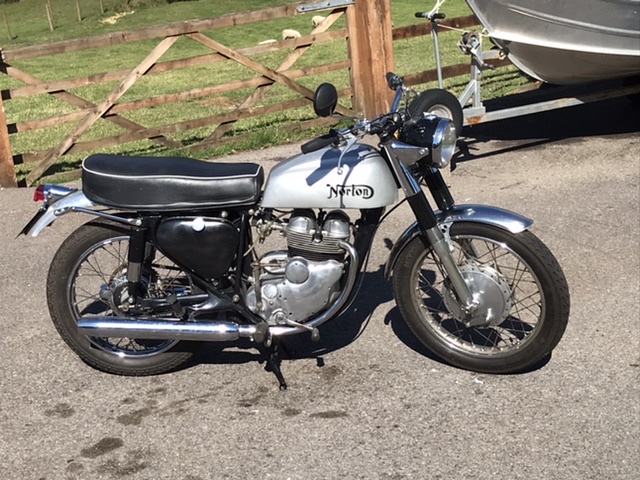

I took my Navigator out for the first long run of the year down to our boat near Dartmouth in company with my son on the Royal Enfield Bullet. They were both very happy cruising at 55 to 60 for the 140 miles there and back. A good opportunity to check out all the deep maintenance and new parts of recent months - photo attached.
Navi really pampered this year with a full service, replacement timing side cover with cleaned and serviced oil pressure release valve, new seals, filter and oil changes, electronic ignition retimed accurately using a strobe, new exhaust pipes from an excellent ebay source, and Feked silencers and clamps (fitted perfectly and the kick start actually misses the right hand silencer!), new NOC shop rear shocks and rear wheel refurbished and rebuilt beautifully by Steve Somerfield with new stainless rim and spokes from Central Wheels.
I hadn't met Steve before but highly recommended (his details are on the NOC Services list), as are the Feked and ebay parts - if people want the exhaust pipe source let me know and I will dig it out. She's now running really well so once work allows, the cafes are open and restrictions eased a run out would be great fun!

Hi Uli, good luck with the…
Hi Uli, good luck with the re-build, just a thought based on getting to know my Navigator over three years. If I was running a freshly rebuilt Lightweight engine in I would be gentle with the revs through the gears and avoid running it for any length of time over 45 to 50 mph and avoid letting it labour at low revs or get over hot until I had done 500 miles. I would then change the oil and clean the filters. I would then gradually increase my use of the performance / revs until I had completed 1000 miles. I hope that isn't stating the obvious but with 60's engines running in is really important to avoid seizures or excessive wear! Nick

Nicholas it’s running well although I need to adjust the tappets I think. It handles well with the roadholders but the best thing is the front brake! It will get some rebuilt jubilee forks when I come to rebuild the navigator, but I’m busy with this at the moment.

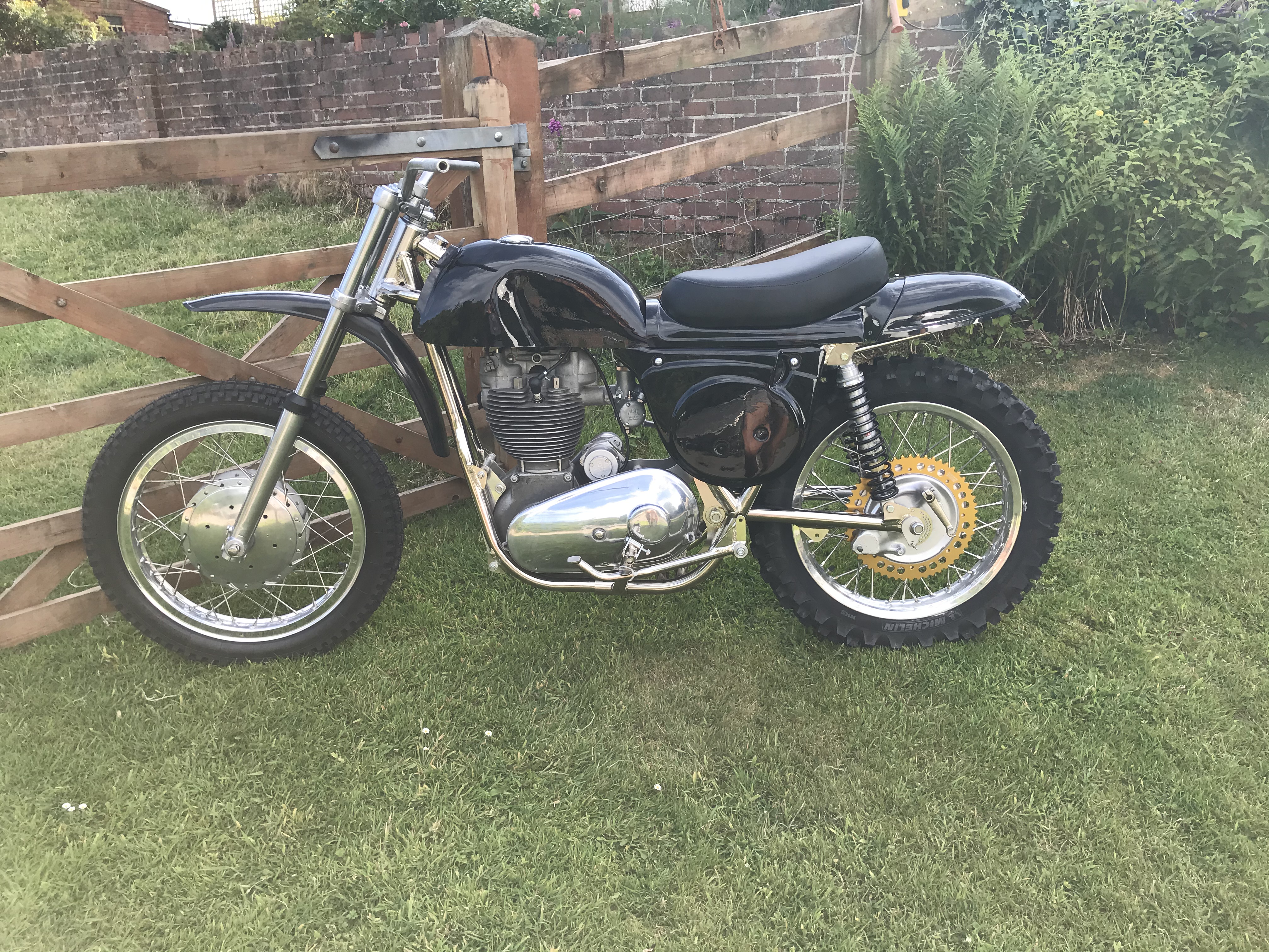

Hi Dan, almost anything is better than a Jubilee front brake but you are right, the Navigator front end must transform the bike! As for tappets did you replace the cam followers when you rebuilt the engine? Everything I have read and heard over many years says that much of the Lightweight 'tappet' noise comes from worn cam followers. But I've never heard a report back from someone who has replaced them to say how much of a difference it made so I am rather loath to invest in replacing mine when my Navigator isn't that noisy and is running well! Frankly I've always found really careful tappet adjustment makes a huge difference although I don't think a Lightweight engine will ever be 'mechanically quiet'. I would welcome any feedback on cam followers. As for the ES2 Scrambler - that looks fantastic! What frame have you used - is it a Rickman? Nick

Yes it’s a Rickman frame kit…
Yes it’s a Rickman frame kit made by Wasp, it’s fitted with one of Mike Pemberton’s shortstroke 520 motors and a Matchless box, BTH mag, new mono block carb, new Norton clutch sitting in royal Enfield chaincases, Why Norton couldn’t make them like that I don’t know, they have a giant o ring seal, one bolt fixing and primary chain tensioner so no moving gearboxes!
Still much to do but making progress.

That sounds a fantastic…
That sounds a fantastic combination Dan, and I can confirm that Bullet chain case and seal is an absolute peach - I've never had the slightest hint of a leak and it's an attractive casting that polishes up well to! A stroke of genius to use it. As for the BSA 44 I've always had a strange hankering for one of their very last 500cc singles, the street scrambler B50SS which they rather controversially called the Goldstar......it uses the engine that CCM developed into their fantastic competition engine in the late 70s and 80s. Sadly they are difficult to find in half decent condition and very expensive when they do come up.....I can dream! Nick
Jubilee and Roadholder forks
Dan,
The Jubilee looks great.
Did you ever post a topic on this forum about fitting Roadholders to your Jubilee or did it come with them?
am thinking of fitting Roadholders to my Jubilee if I can find some and it would be good to know what is required to do this.

Hi Dennis Yes I did, my…
Hi Dennis
Yes I did, my jubilee box of bits came with them, I faffed around with a Navigator down tube which gave me the steering lock but meant I needed a spacer on the head steady mounting. But basically it’s an easy fit with either downtube and full width hubs/wheels are easy to find. Alternatively buy a Navigator!

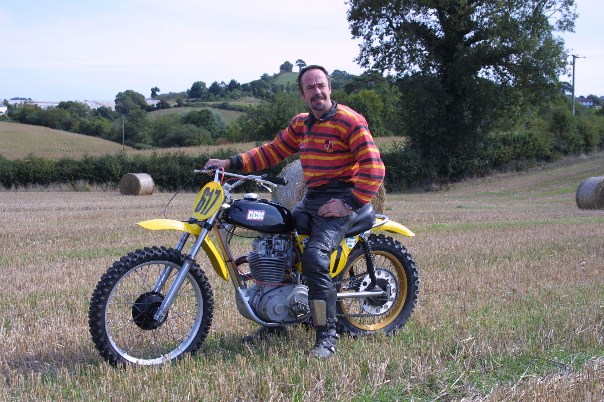

Hi John This my mate Ian’s…
Hi John
This my mate Ian’s CCM, nice but expensive!
Thanks Dan....
Thanks Dan, yes a Navigator is the answer but I am a short rider and had to adapt the Jubilee to ride comfortably using lowered rear shocks and a thin racing seat. I would not want to do that to a Navigator!
