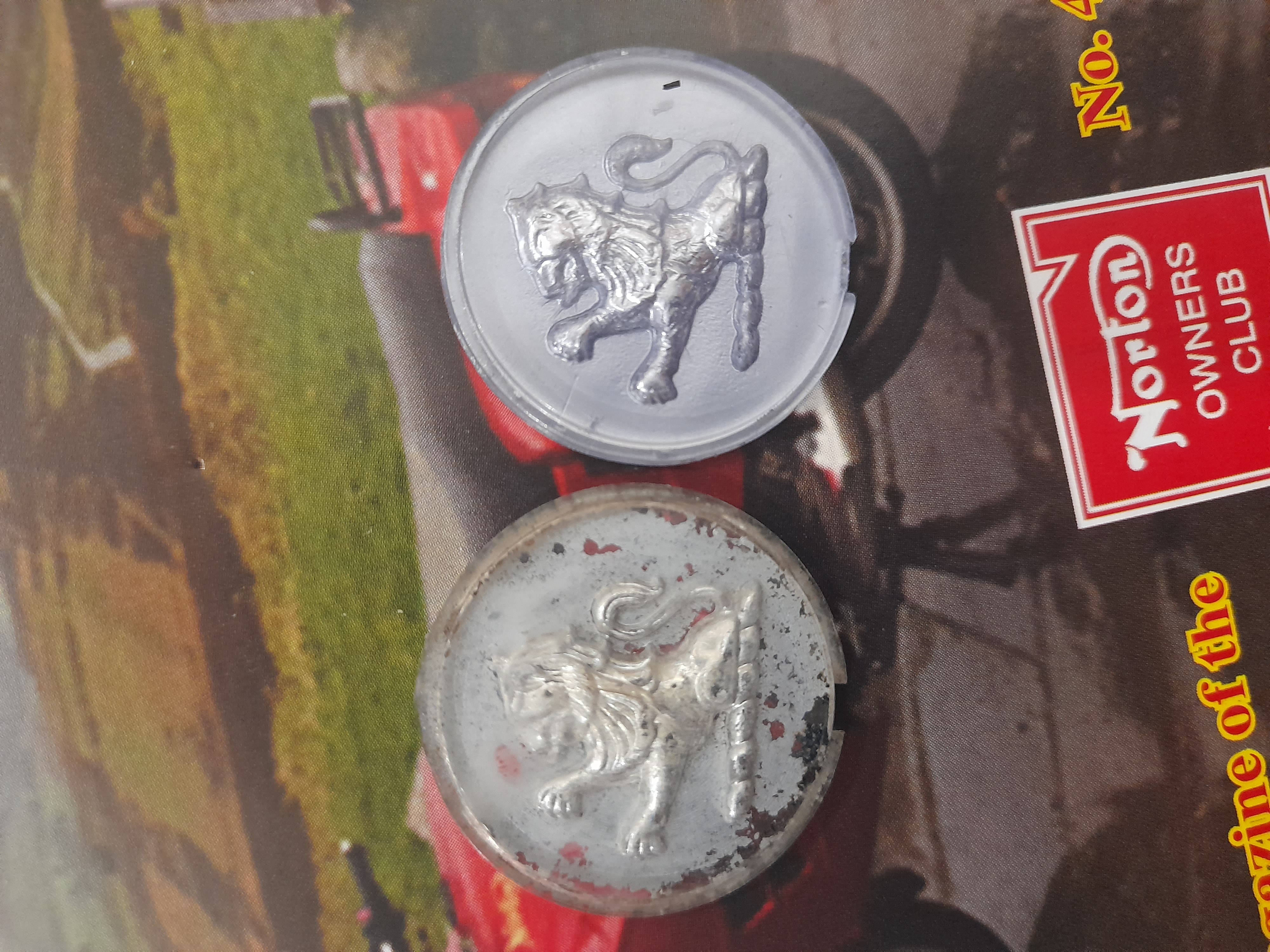

I have an original Lucas medallion but it needs some restoration. I think i can sort out the paint however it has a crack down the centre near the lions mane.
Wondering if anyone knew how it could be repaired. Thought maybe a windscreen repairer could inject it with clear resin but not sure.
I dont think the aftermarket medallions look right so want to try use the original if possible.
Thoughts and advice on its restoration most welcome

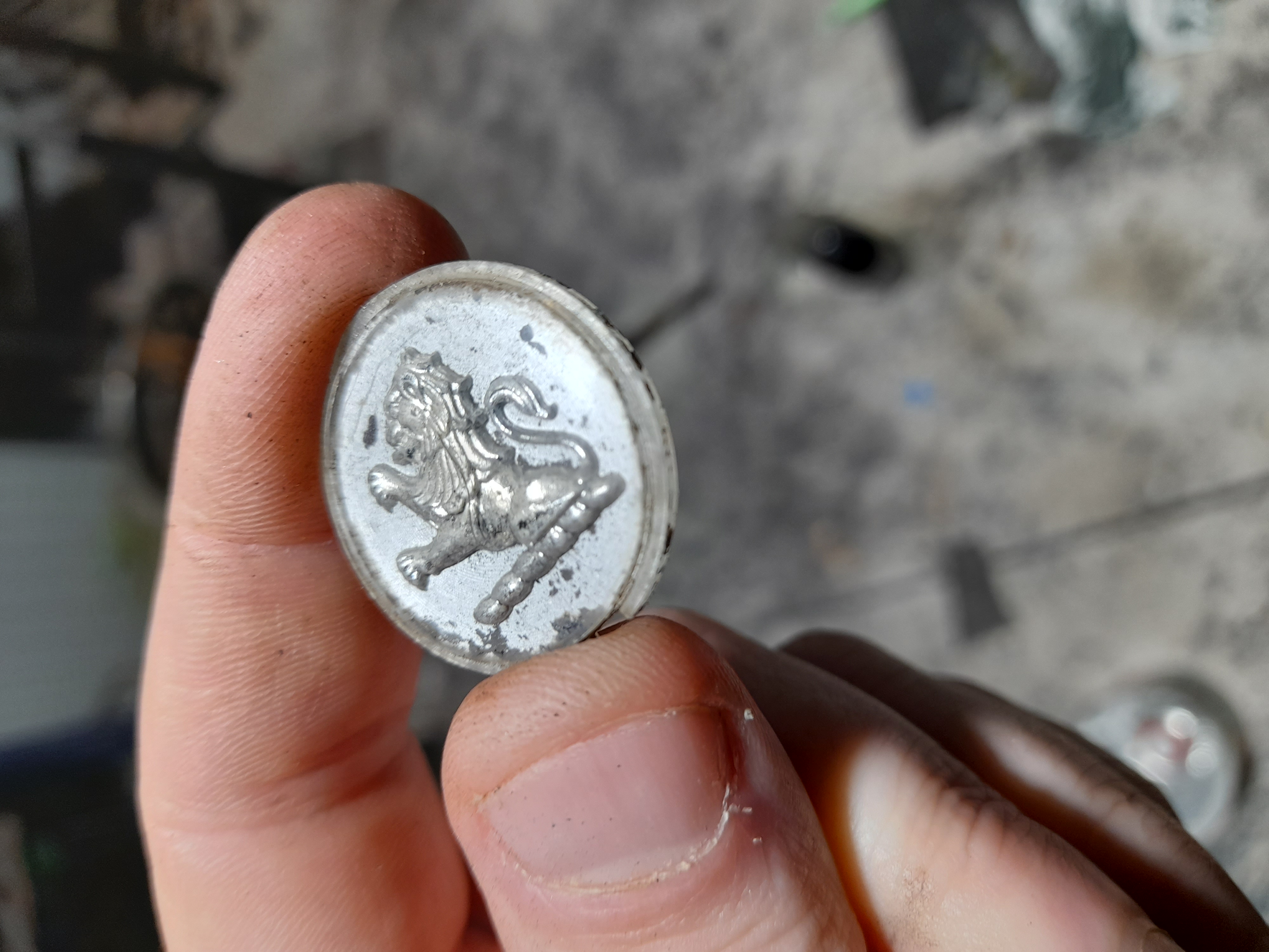

Thanks for the tips. At this stage im going to Keep the original one to the side and play with some repos.
A lot of the repos are almost identical matches but come pre painted. Lion and surrounds painted the same grey. Not very nice.

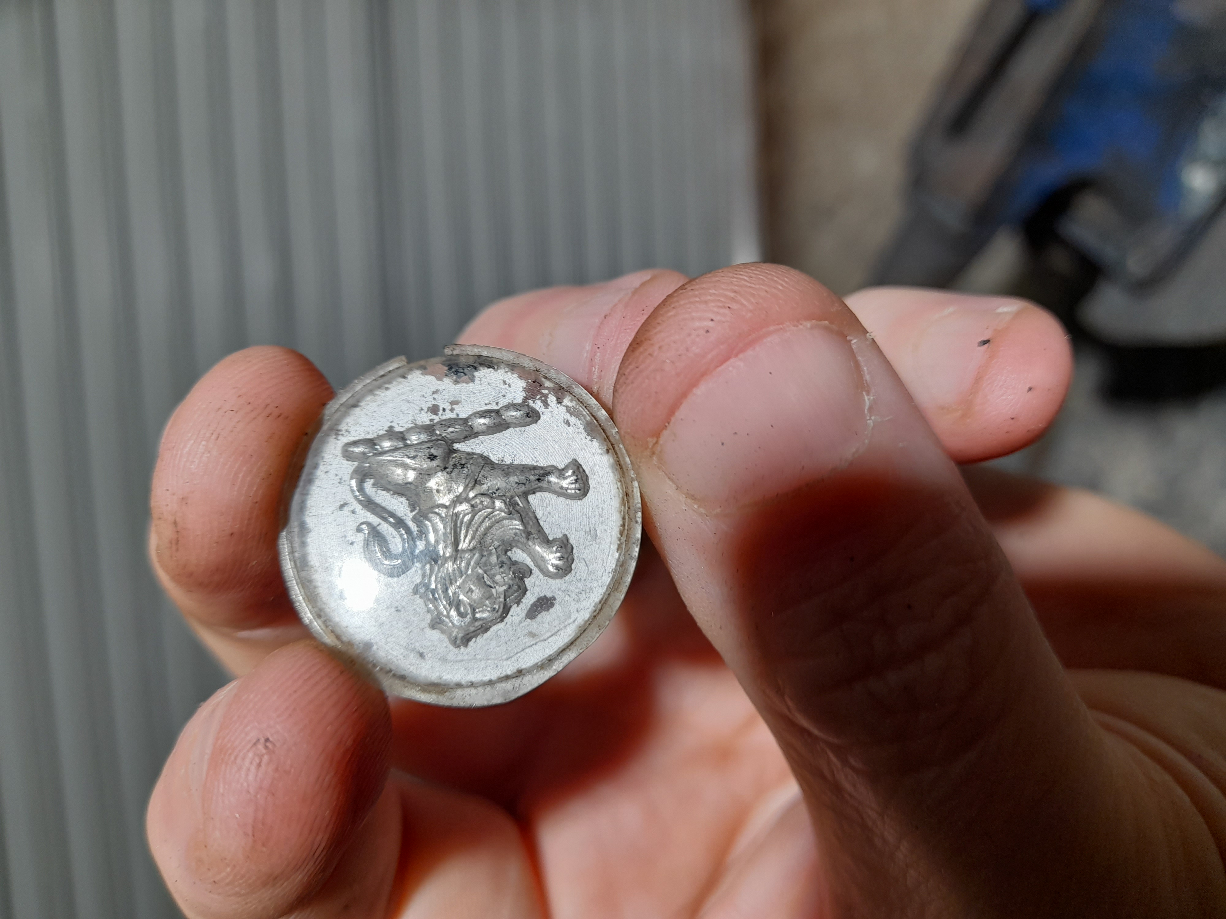

Using non acetone nail polish remover and cotton wool buds, i stripped the medallions to clear. I tried various silver paints in the lion but it just looked grey, the original seems to be metallic. I then got a chrome pen and used that on the lion. Unfortunately the chrome only shows on the side exposed to air and when you reverse to look at the medallion its grey. I then tried chrome spray paint and it was the same result.
My most recent attempt to get a similar finish was using a sponge and silver paint, dab at it to paint the medallion background. I then used a little clear silicone glue in the lion and pushed in some chrome foil. It seems to be my best shot to copy the look so far.
