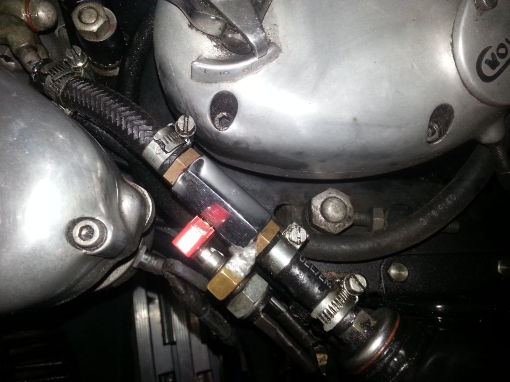

I have seen a particular oil tap on another bike (photo attached) and I would like to buy one to fit to my 1959 Model 50 - can anyone tell me where I can buy one of these ?

Looks like a standard wash…
Previously David Cooper wr…
Previously David Cooper wrote:
Looks like a standard washing machine delivery pipe ball valve with adaptors to take a spigot for the pipe and to carry the male thread. I have one almost identical on my Dommie but it also has a switch operated by the lever. I wouldn't feel safe without the switch...look on this site for all the warnings and tales of woe!
I have a similar one - picture attached (sorry it's upside down...)
Thanks David. But, alas, I am unable to open/see the photograph !

Incidentally - this is set for coil ignition so it cuts the power (opens the switch) when shut. With a different cam it could close the switch to earth the mag when closed. But I don't know how that would work on a single with no convenient electric circuit to make and break.
