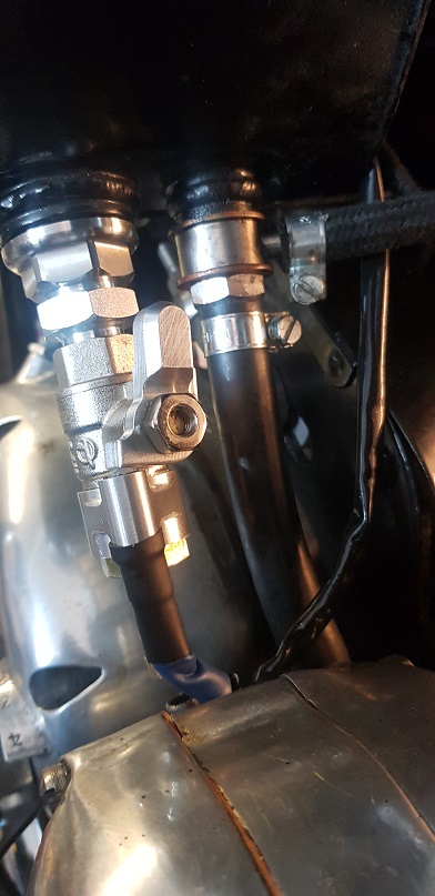

Feked
I bought a "magneto" unit from Feked (I have Electrex ignition).
I was initially pleased with the quality, but I soon realised that there was no space in a Dominator to fit it in using the two 3/8" BSP spigotted adaptors supplied.
The way I got round it was to use an RGM universal filter R2/392, which has a 1/2" 20TPI tapping (£26.28 incl), and a stainless 1/2" UNF to 3/8" BSP adapter from eBay. About £100 all-in.
For the Kingpin unit you would need a 1/4" BSP to 3/8" adapter and their universal filter.

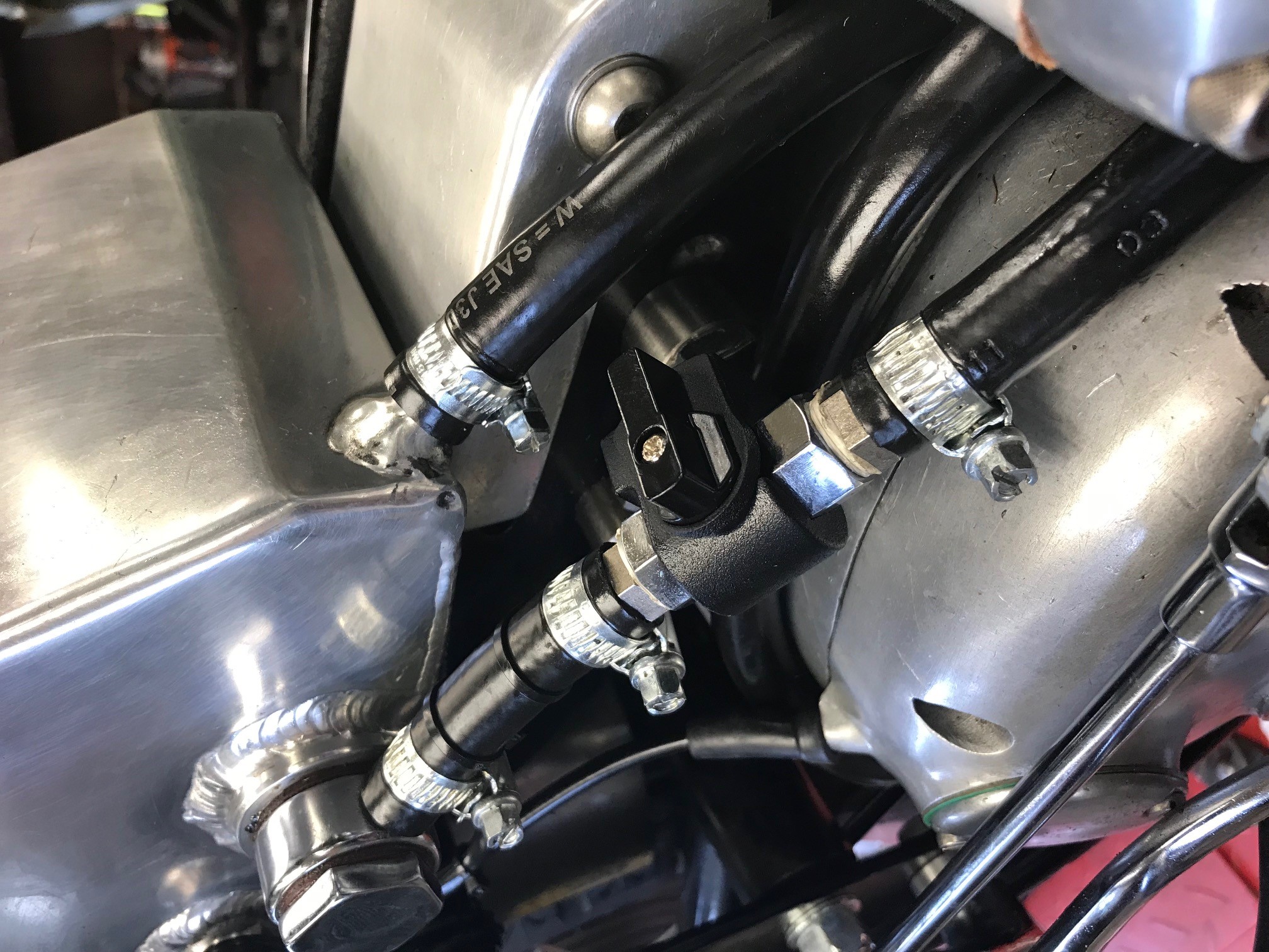

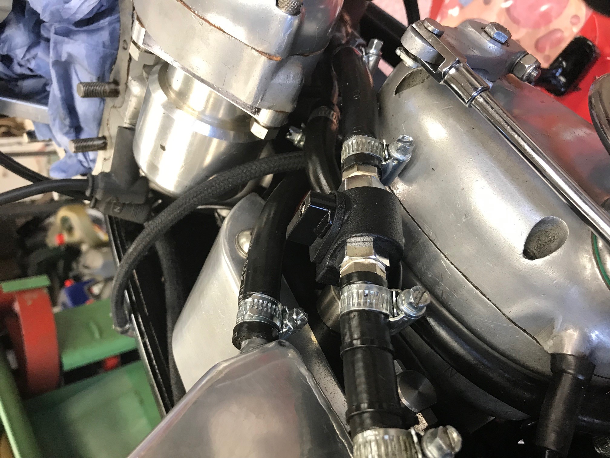

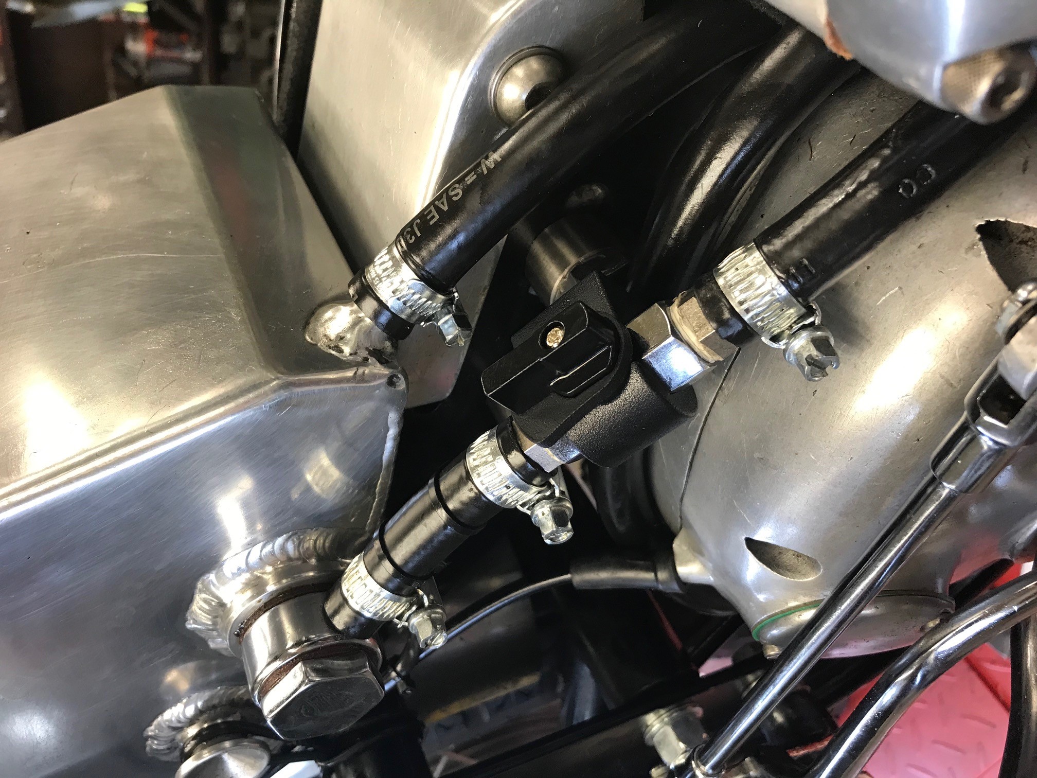

I have now installed the Kingpin unit. Various ways of installing it, I choose to mount it inline with the thought it might dampen out some of the vibration. Unit is on my1967 650SS. The electrical portion is very discreet , on my bike it interrupts the power supply to the Boyer electronic unit. Wired another way it can act as the ground connection for the mag if not turned on (valve in the closed position). I am impressed with the quality. If anyone has any questions happy to reply.

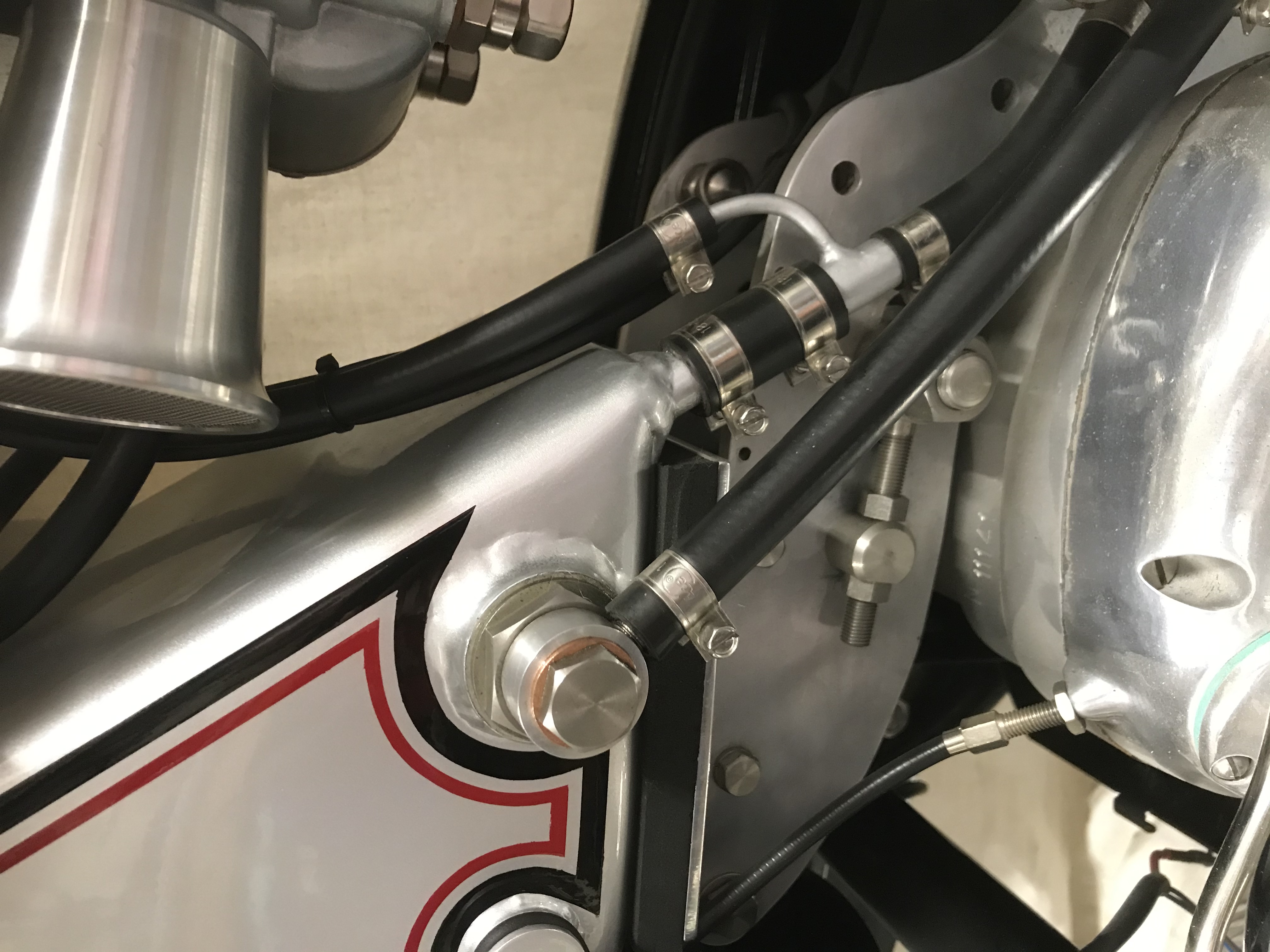

Feked Finally Installed to Slimline Dommie
It needs 4 1/2" minimum
between the tank and the rigid feed pipe.
