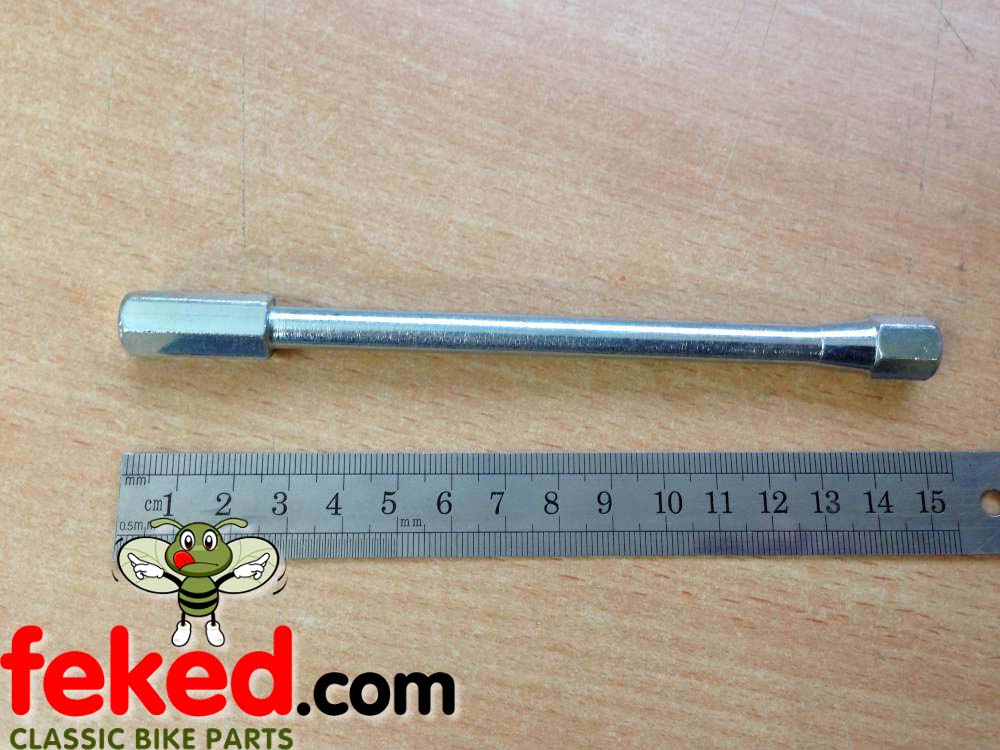

I only use the extended bolt shown in Michael's earlier post. Makes it simple to ensure that the magneto flange is uniformly tightened.
There are spanners available which give better access but the extended stud is by far the best way to go. Available from all of the major parts suppliers

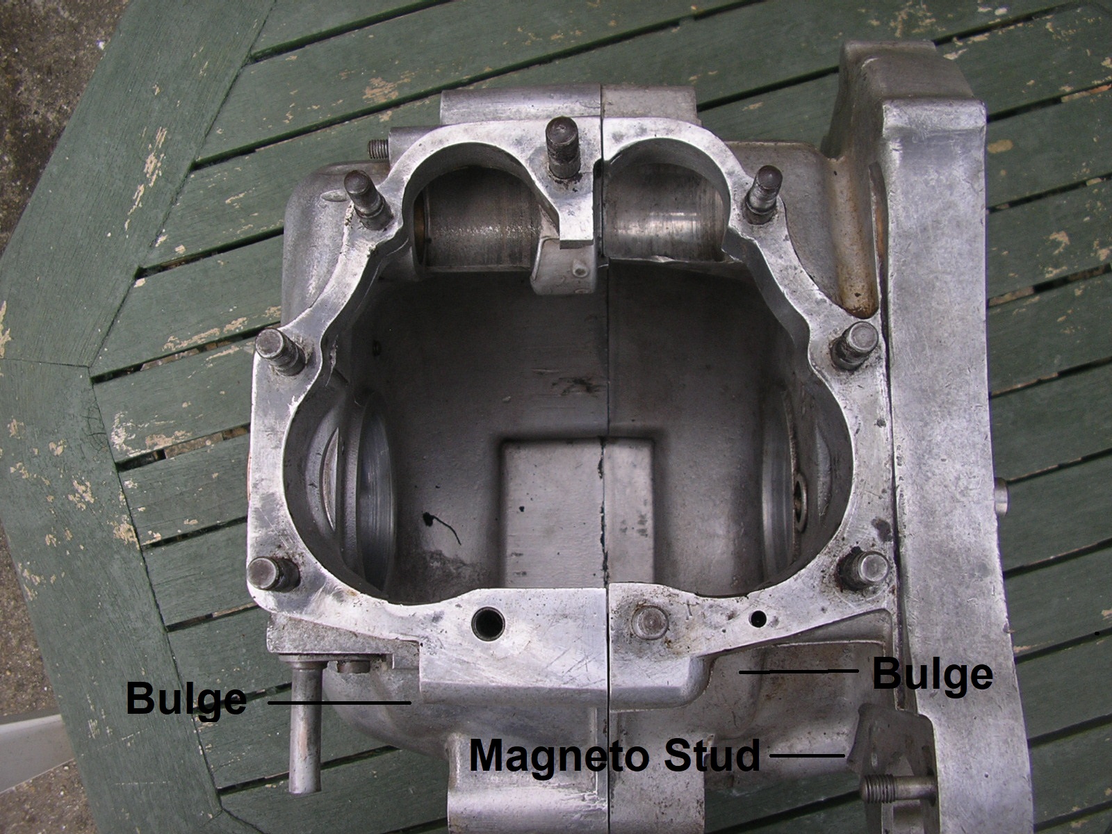

Bulged Crankcases
As can bee seen in the photo below the crankcase bulges are well clear of any extended bolt used to fit the magneto. The problem with all of the Dominator engine is the flange lips which could be trimmed a little to clear the bolt shaft.
The extended bolts themselves do tend to vary in dimensions depending on the source of manufacture. Michael C in his posting above agrees with my findings. eg the BSA bolts have a thinnish, unform shaft that generally clears the Norton Crankcase flanges. A trial fitting is a smart move and if required, some metal removing is easily done with a drill and file.

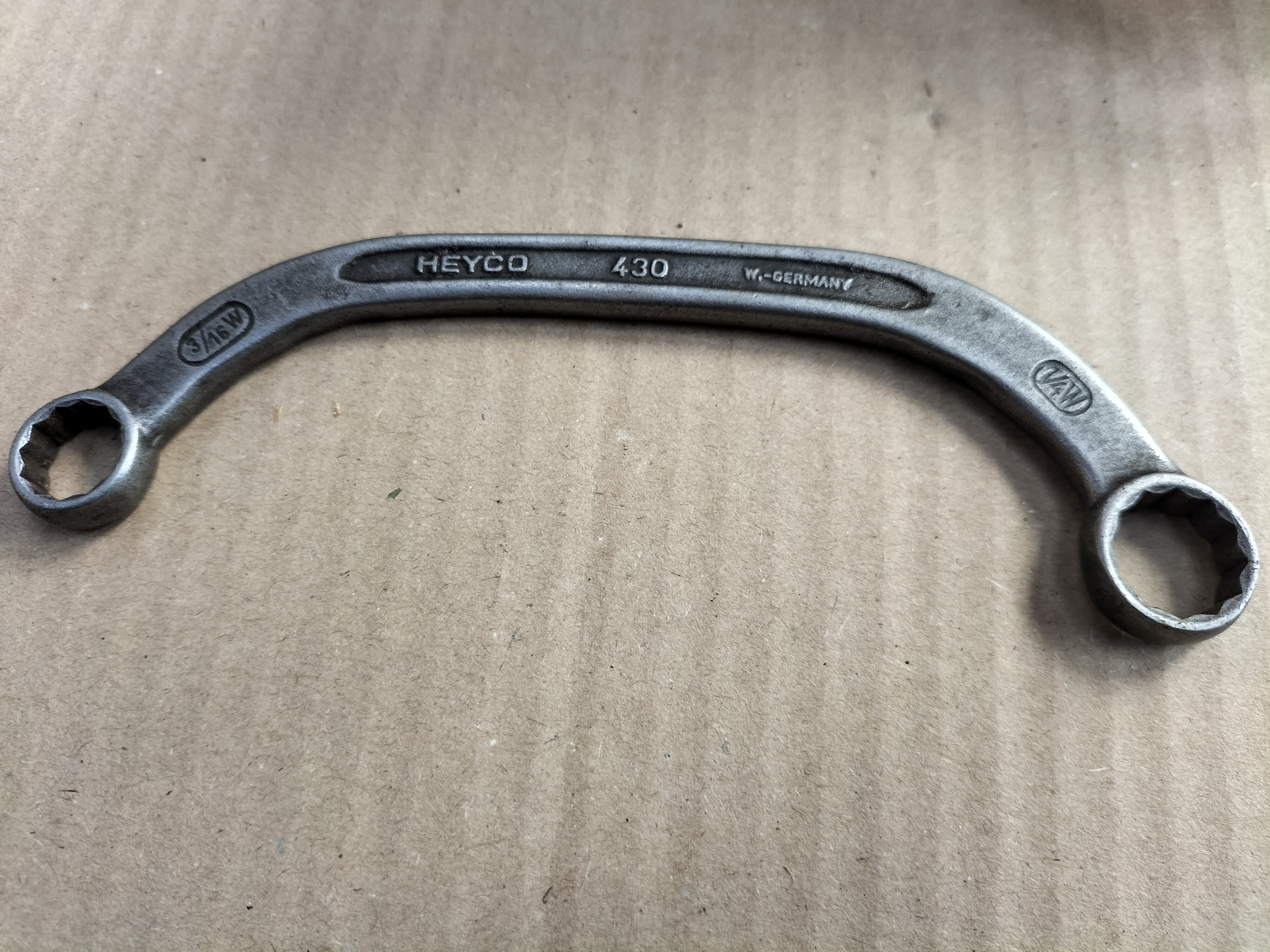

I have a dedicated flat…
I have a dedicated flat combination spanner. The edges of the open end have been ground back from about 3/16" maximum to a point at each tip. The edges of the ring also ground away. And the offset angle of the ring from the handle is hammered flat so it can be reversed. Remove the oil union and it works. Hard part is getting the nut started.

Not really much help in the present circumstances, and yes that bottom nut is a pain BUT there is a solution. There is an extended bolt available, I think originally for the A10 but will fit most brit bikes of the era. About 3"/15cm and less than a fiver. But you would of course have to faff about removing the original nut in the first place.
https://www.feked.com/bsa-a7-a10-magneto-bolt-67-1259.html
