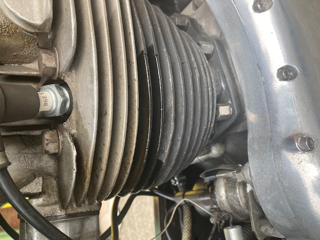

![oil leak?](/sites/default/files/inline-images/IMG_2038.jpg)

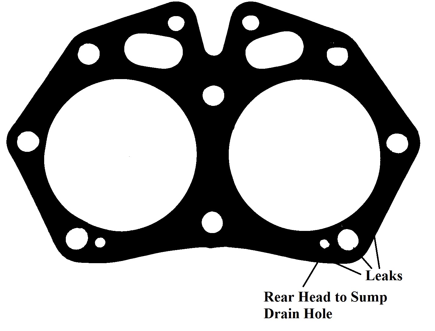

Check out this diagram.
This shows what can happen if a composite head gasket is used on a Norton Twin engine. They have two weak points where crankcase pressure will push oil through the composite sandwich to the outer edge of the barrel/head joint. The first being the push rod tunnels. Any splits in the gasket rings that seal the push rod tunnels will let oil straight past.
The same can happen at the rear of the barrel where the oil return/drain hole passes through the gasket. For some reason, unless a solid copper gasket is used, there is no protection at all stopping oil from being pushed sideways inside the gasket in this area. It then heads for the nearest exit which happens to be the cylinder head bolt behind the spark plug.
I note in the photograph the head bolt behind the spark plug is wet with oil. Possibly agreeing with the text above.
![gasket 2](/sites/default/files/inline-images/Gasket%20Rear%20Drain%20Hole_0.jpg)

I had several hours to contemplate the oil leak yesterday - I displayed the bike at Bloxham Steam Rally. I the bright sun I realised that the oil leak was to at least some extent coming from the carb side rocker cover which I had disturbed a while previously when checking valve clearances.
