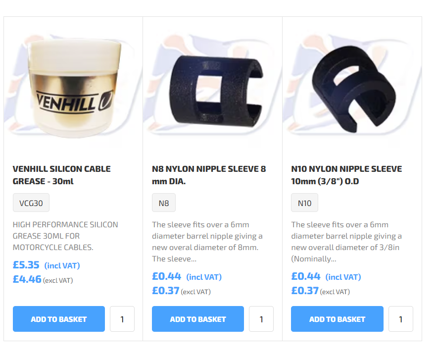

Solution Venhill 3/8" Nylon Sleeves for Barrel Nipples
Found the solution:
Nylon Sleeves - Nipples - Fittings & Components - Cables & Components
