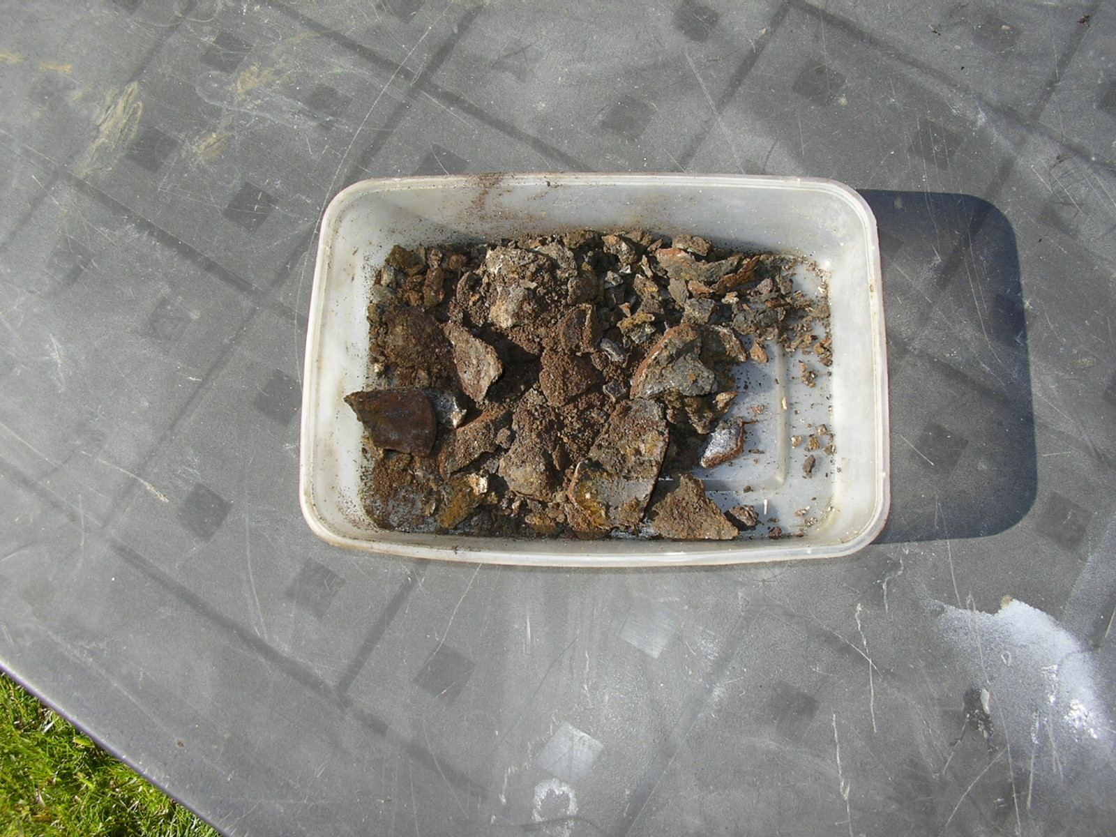

on about oil circulation, i hadnt got any on one side of the engine . i wonder if it had anything to do with what i found in the crank. see photo in attachment
barry
Barry.......I bet those lumps did not do the engine balance much of a favour. These usually arrive thanks to using basic mineral engine oil.
At least there was enough room for the oil to still pass through.........unless you had previously done some chipping.

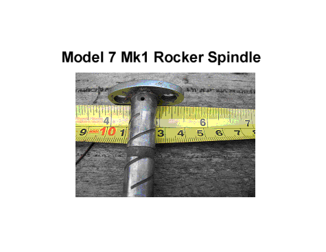

Attachments show a crankshaft from a Model 7 engine that I was recently asked to rebuild.  On the very early 1949/50 versions of these engines, the rocker spindles  often got so badly coked up that they would not pass through the spindle shoulder holes. Bracebridge had to change the design from a one piece combined spindle with brazed-on end plate to a separate spindle with two plates.
on the wet sumping,... my es2 which i dont use much. i dont mind the wet sumping. i just kick it over now and then without starting it. just to over oil the parts. makes you wonder if the pumps were disigned to wet sump originally .
Hello , Philip....  i thought mine was bad but thats well blocked up. mine picked up on the shells and seized on the one side. it had loose sludge in it like a crispy burnt type over the oil hole area. also the shells turned in the rod.
Barry
Since about the mid 60's (well into old age for the Dommie design) oils have normally contained dispersants to prevent small but mostly harmless soot particles from joining together to make up lumps that block things and cause more damage. I wonder if sludge traps from Commandos block as badly as Phil's example? Later machines should have been using better oils. Usually...
