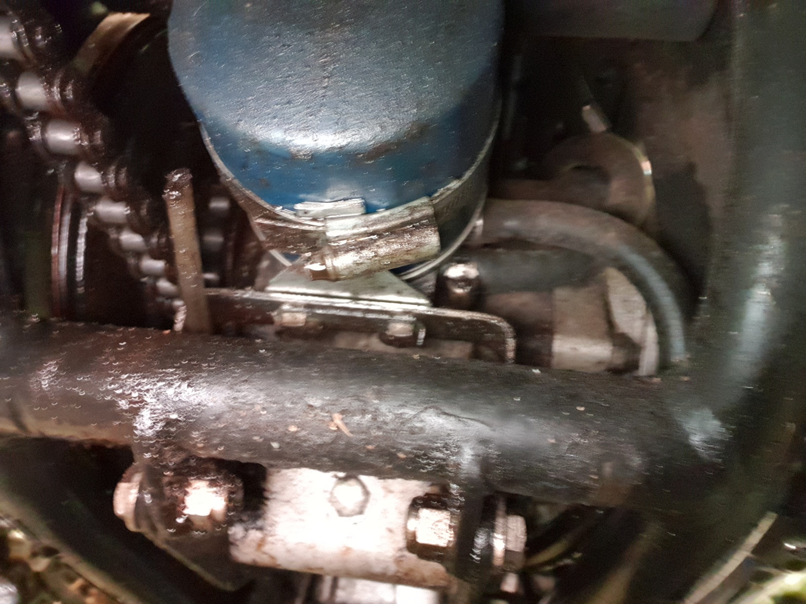

Don't think Yamalube  is a suitable oil in a modern Kia  that has a 7 year warranty, or my diesel van.I did many years ago buy an oil filter kit from  our beloved Norton agents. Nothing fitted ,pipes too big ,no way of fitting bracket ,oil pipes in filter head insecure. Gave up.Resolved never to deal with them again, threw it in the pile of useless new stuff.Its all part of the ritual of running an old bike.I had similar problems with ALL the known Norton stockists  ,some however do try to work with you, and have an honest attitude.

Is this the mounting bracket that came with your kit? See attached. If so, does it not fit? It looks to me that the weight of the filter would encourage the bracket to pivot on the mounting bolts. I bought a filter kit for my 650ss-engined Wideline a few years back, which they say 'fits to any flat surface'. Hence, no mounting bracket. I made one, but it is not really satisfactory, and needs replacing.
Ian

Ian...the bracket you show works fine. It bolts to existing lugs under frame rails and the cut outs lean on the cross tube. It can't rotate anywhere.  (I see a twig stuck in there somewhere! Not original...just patina...but do I see a wonky bolt head?)
