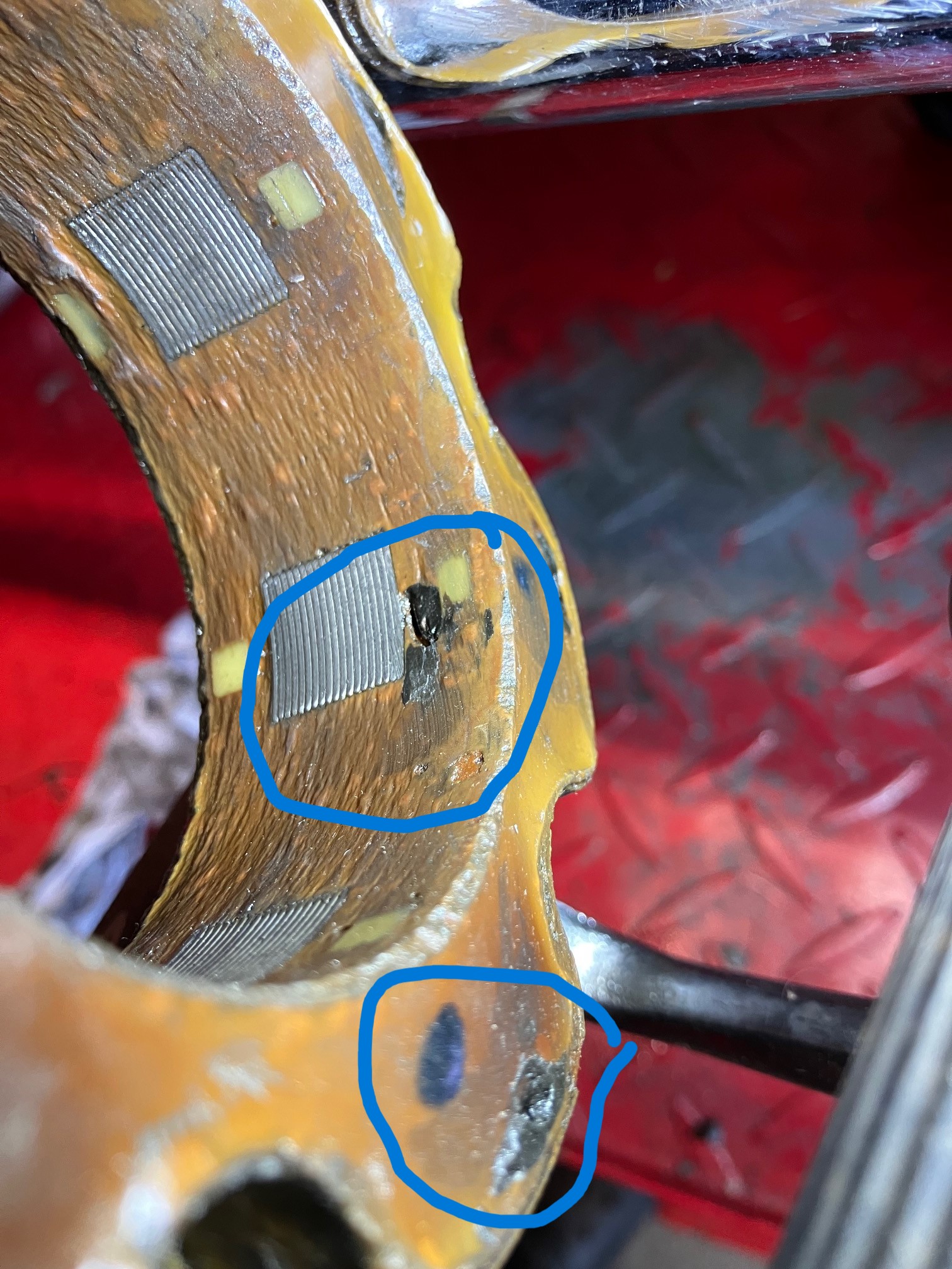

After only a few moments running with attenuator light flickering at me throughout, I noted the alternator wires were uncomfortably hot and shut it down. This morning I have removed the stator for examination - see pics (hopefully). The black bits look like something melted and the bubbling on the surface also appears heat related. Only thing I could think to test was the resistance between the two stator wires and that comes in at 0.5 Ohms. It may be nothing at all as 0.5 appears to be within the accuracy of my multimeter (see previous posts).
I also attach a photo of the rotor which looks OK to me but appears to have a piece of surface material missing? Do I need need a new rotor/stator?
You don't need a new rotor!
The stator might also be ok, you need to test it as per the instructions on aoservices.co.uk info sheets alternator testing as you was instructed before. 0.5 ohms does appear to be a bit low but testing as per web site will sort it.

it almost looks as though…
it almost looks as though the resin has popped at each coil position. possibly overheated.

The stator
I agree about the appearance of the stator, but if the values measured in the alternator Output tests look good, I'm at a loss? The symptoms are that (a) the attenuator light flickers all the time or is on brightly when lights are on as well, which suggests lack of charge into the battery to make up outgoings? Symptom (b) is that the alternator wires are uncomfortably hot after a couple of minutes running.
