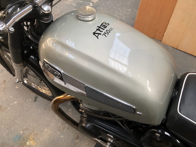

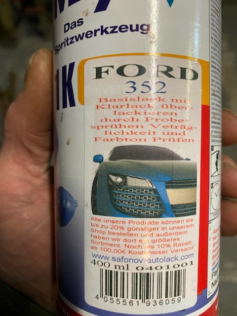

I sprayed my 1963 Atlas last year using the Ford Silver Fox equivalent. I found a rattlecan version on ebay, a base coat and a 2k clear coat, made by Safonov Autolacke in Germany. I assume XSC352 or 352 is the code:
SprayMax 2K Set 800 ml Originallack FORD EUROPE XSC352 SILVER FOX MET. 1966-1971
Ford recently launched a new Silver Fox, which is a flat, non-metallic grey, code JQQLXWA, which is now stocked by many suppliers and can lead to confusion!
