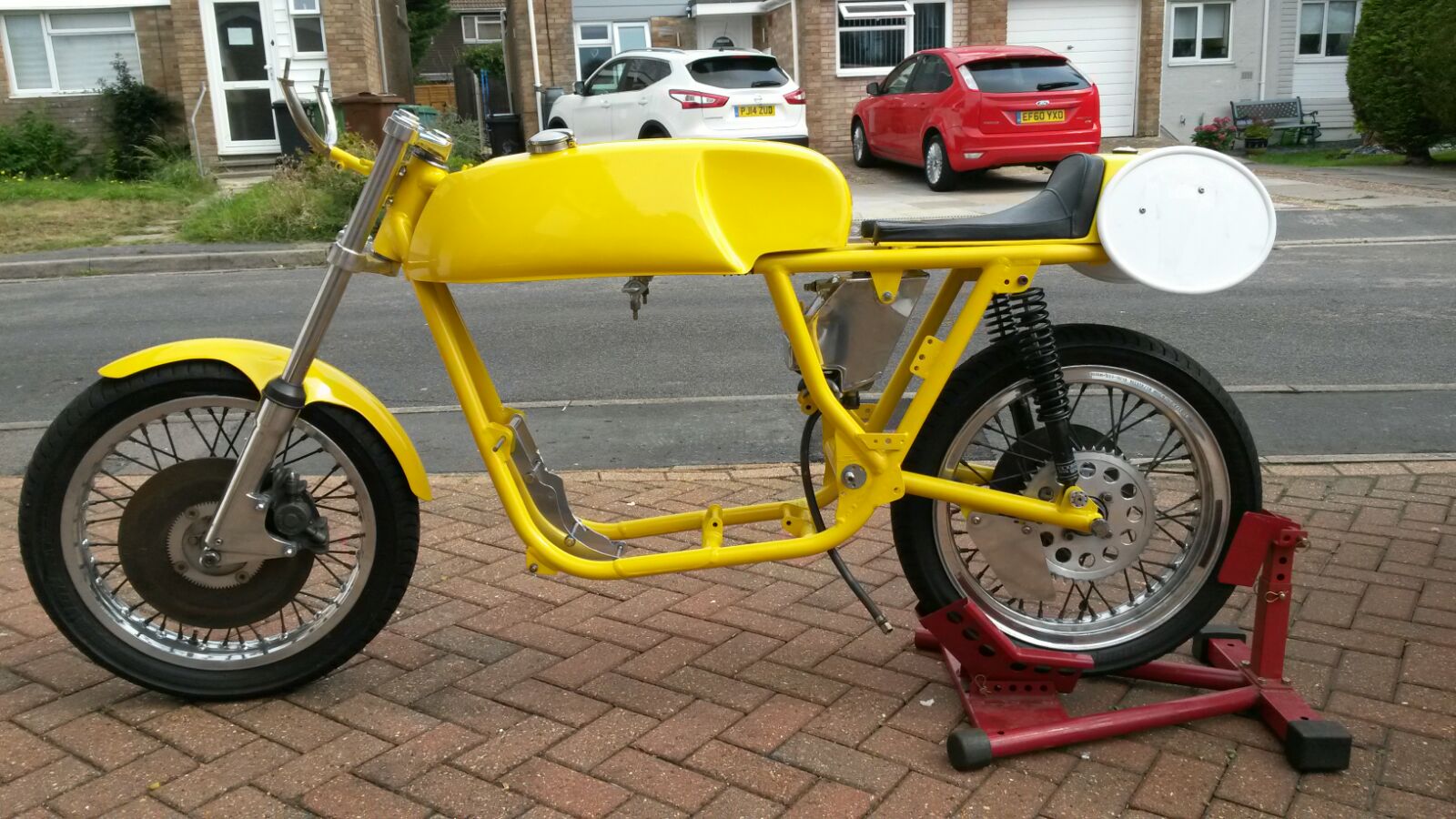

My project is getting closer to inception, Mike is building an engine and Wasp are checking it will fit in the frame (height wise). It would be easy to throw money at it and buy a new front end, but I have a good set of long roadholders with commando dampers that I could use along with a pair of full width wheels. My problem will be (I think) getting yokes to fit, and I’d prefer Aluminium ones anyway. The Rickman frame has 52 or 54 mm OD bearing seats. I could use commando yokes as the 25mm spindle would make finding taper bearing easy but they will be 7 3/8 which I guess means my wheel will be off center if I use the long roadholder sliders, plus I’m not sure about the offset. Also most of the after market yokes I can find don’t have bar mounts in the top, any suggestions anyone?! Are there any Ali 7”;yokes to be had with bar mounts?

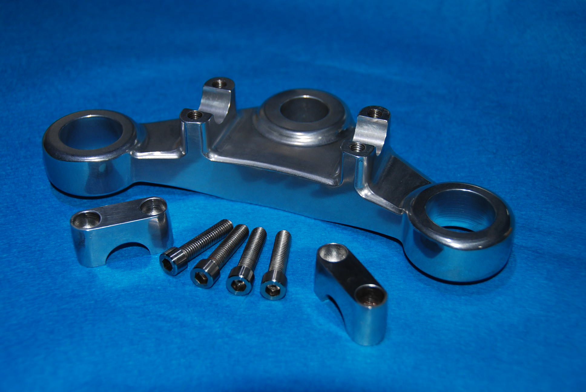

I have these Tickle 7inch yokes if you are interested . They came of a Yamsel when people were running flat bars. Stem was butchered no handlebar clamps.
All the best Chris

i discovered the difference when trying to swap bits about! I’m not sure if the later (post 64) roadholders had 25mm bearings like the commandos or if the 13/16 stems had 25mm bearing seats ..... anything is possible! I can’t see the yokes you have but may well be interested!
