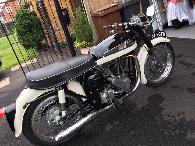

The dominator which i am renovating and I think is 1960 has Alloy rims, did amy of the dominators comeas standard with alloy rims
the con rod s look fine but don't know whether they will be strong enough on a recon engine or would you recommend replacing
the barrels need relining do you have any recomendations for compamies i could send to do this

If using the old rods they need to be checked for ovality in the big ends and any nicks on the rod faces where they may have knocked the cases need polishing out. There are other treatments possible ,crack testing and shot blasting , Would be interesting to find out if these are of any real value . as our old rods are now very old!.
I don't know about the 60's …
I don't know about the 60's (I was too busy raising a family), but back in the 50's Norton would add any extras a customer required (at a price!) So, alloy rims were probably an option.
Alloy rims was a common…
Alloy rims was a common upgrade in the sixties. Main reason was to minimize unsprung weight. And of course for looks. Since they are serrated there is no need for security bolts, making it easier to fit tyres. Did it myself back in -67 on my -60 99. So if you want a period look, alloy rims are perfectly ok.

The 1960 Birmingham factory parts list and suplimentary list for that year does NOT list alloy rims as an option. The usual thing was that owners replaced the steel rims with alloy after a crash or when they got fed up with rust. Our SH Atlas fake Dunstall came with Boranni Record very aged and weathered rims taken from an old possibly pre-war race Norton and supplied by Alf Hagon. Somewhere between a WM1 and 2 , ok for a 300x 19 front but useless for an Atlas rear tyre. I laced in a new Acront wm3 a few years ago. The Factory lists do make interesting reading with many optional items.
My perception is that in the…
My perception is that in the 1950's bikes were ride to work transport with very little spare cash for bling . By the mid 1960's cars took over that role and bikes became more playthings and fripery like alloy rims and extra chrome became more common. Seems like sometime after 1960 Norton responded to the trend and added rims to the list. I was surprised to read that the Big valve 1960 88/99 heads could be ordered with even larger inlet valve seats which must have been bigger than the std 650SS.

My model 50 comes with alloys, and surprisingly many stock photos show them similarly shod. Must be some logic behind fitting them, and as said previously cash for “bling” was not high on the agenda then. Supply and demand, lack of stock of steel rims, Chrome shortages? I have no idea but there does seem to be more fitted on turn of the decade bikes, and as by my example not for sporting purpose.
