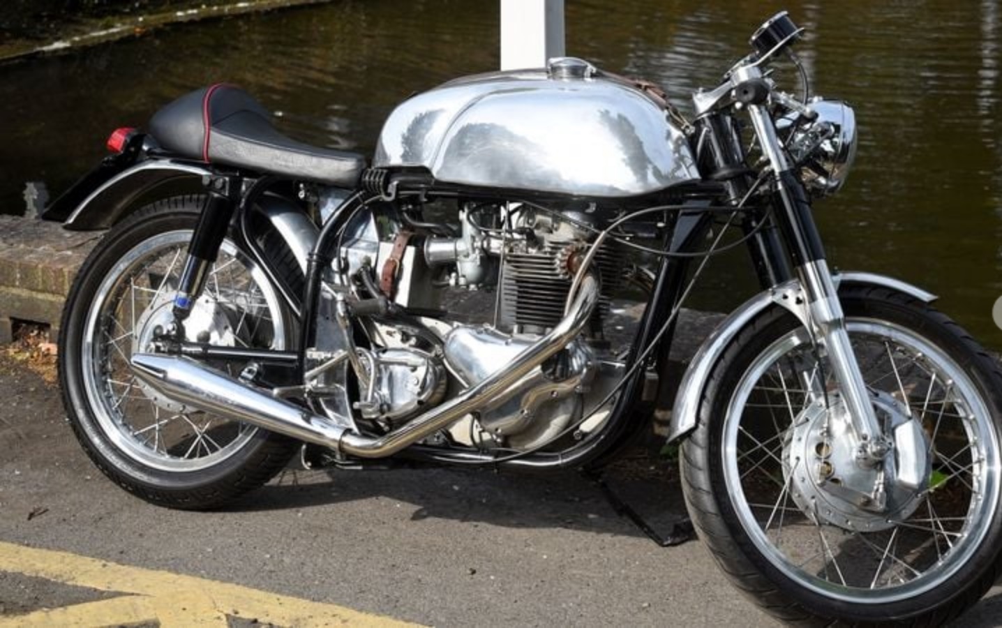

Norton Atlas Cafe Racer 1967
Lovely looking bike BUT (going to have a rant now) How I hate swept back exhaust pipes, as soon as you go to do anything-pickup a spanner etc the pipe is in the way, and they don't help cornering that I have ever been able to do....even though they look great!

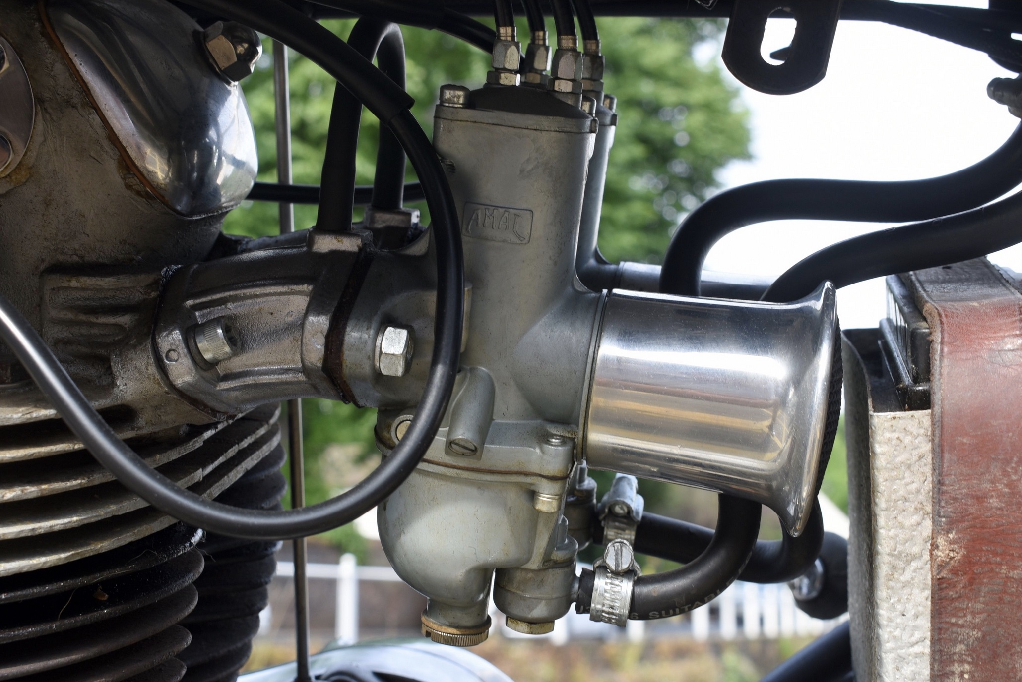

Another look great but actually slows up performance is those cheap carb. trumpets. The Amal ones work-those don't. Just take em off and see what the difference is with bottom end punch? But shouldn't they be down draught?

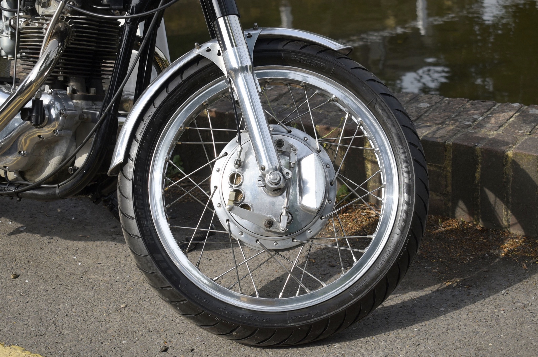

Another point, the front brake looks over centre so needs looking at.

It's a numbers matching bike, but its had a number of things done to it. For example, a brand new hand made tank.  If you're curious about what else has been changed:
    New aluminium mudguards front and rear
    Hand-made stainless steel clip-on handlebars
    New wheels built by a trained wheelwright, with stainless spokes
        and aluminium rims
    Aluminium café racer oil tank
    Hand-made stainless steel chain guard
    New stainless steel tank straps
    New aluminium top yoke
    New clock mounts
    New headlight with ammeter
    New rear shock absorbers
    Twin carburettor upgrade with two new Amal concentric carburettors
         (ignore the non-Amal trumpets - its the look :-))
    New brass fuel taps
    New chain
    New clutch
    New clutch and brake controls
    New throttle
    Vented twin leading-shoe front brake
    Electronic ignition
    New exhaust system including downpipes and silencers
Definitely NOT as delivered in 1967.
I love the look. But I want to make sure that if I ever manage to sneak away from my wife, and drive around the block, it is in perfect working order and as safe as possible mechanically.

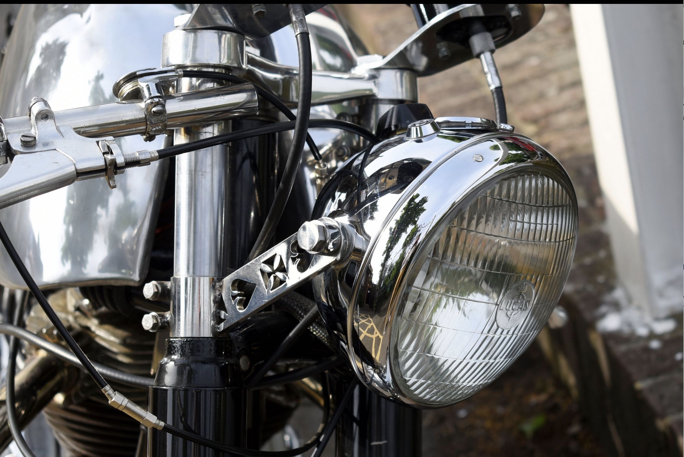

Headlight and Guages

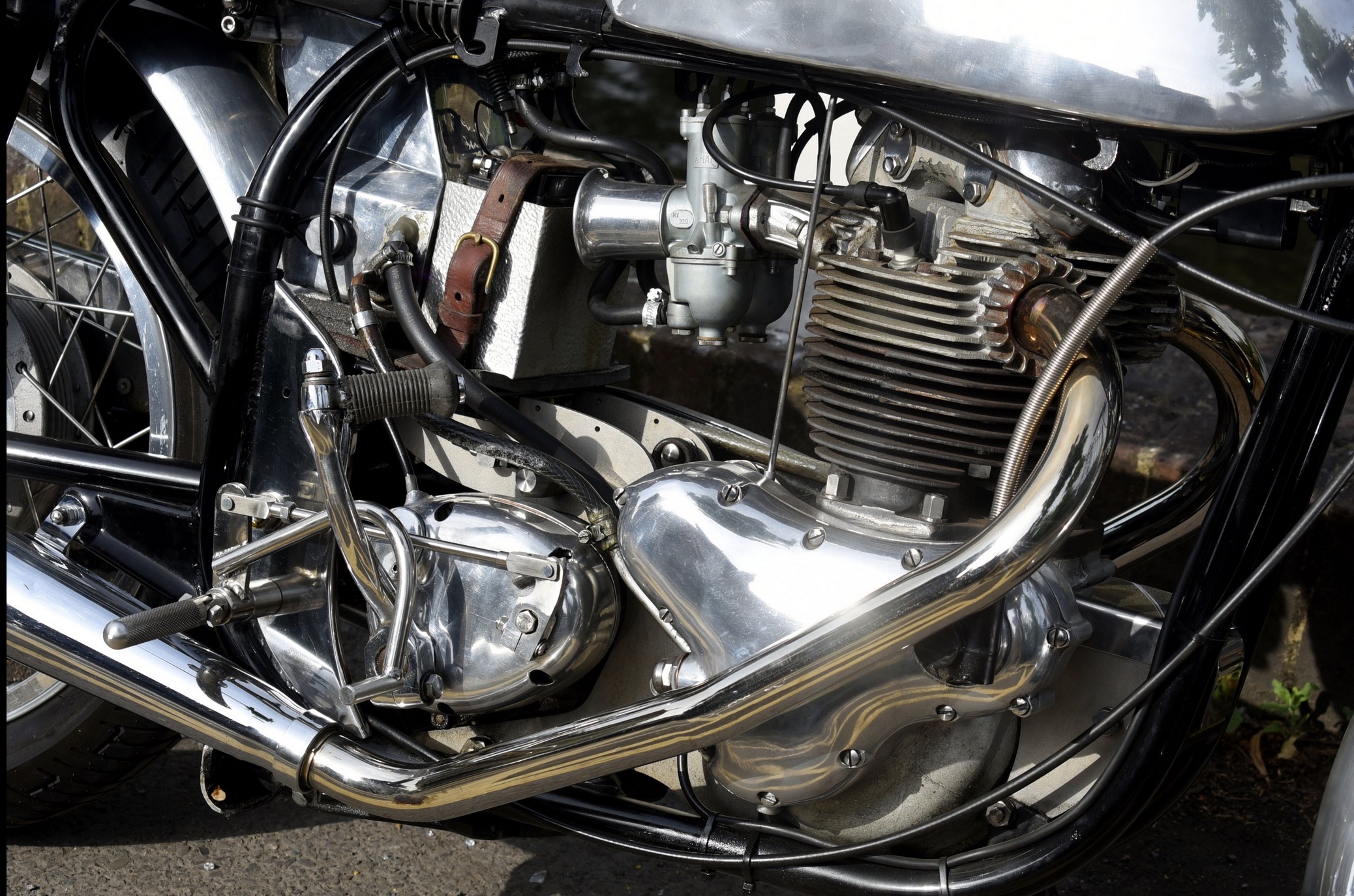

It looks like someone fitted a Commando carb manifold.  They turn down to compensate for the engine being tilted forwards.  Twin carbs on the Atlas etc should have straight spacers so the inlet passage is dead straight before it reaches the inlet valve.

I never said I was/am an originality freak. I like the look of it but I still dislike swept back pipes as they get in the way as soon as you want to do any work! The front brake appears to be early Commando TLS fine a good mod, but it still appears over centre and needs resetting.
Glad somebody else sees the carb manifolds being wrong, The carbs should be down draught not horizontal which the appear to be.
those inlet manifolds are very odd. can you post a close up of a carb. and manifold?
   The front brake levers on the hub are at a very odd angle: never seen them at such an angle, which is potentially very worrying as to how the brake shoes /linings have been set up, or more likely, that the levers have been fitted to the pivots the wrong way round: the fitting slots in the arms are at a slight angle to the length of the arm.

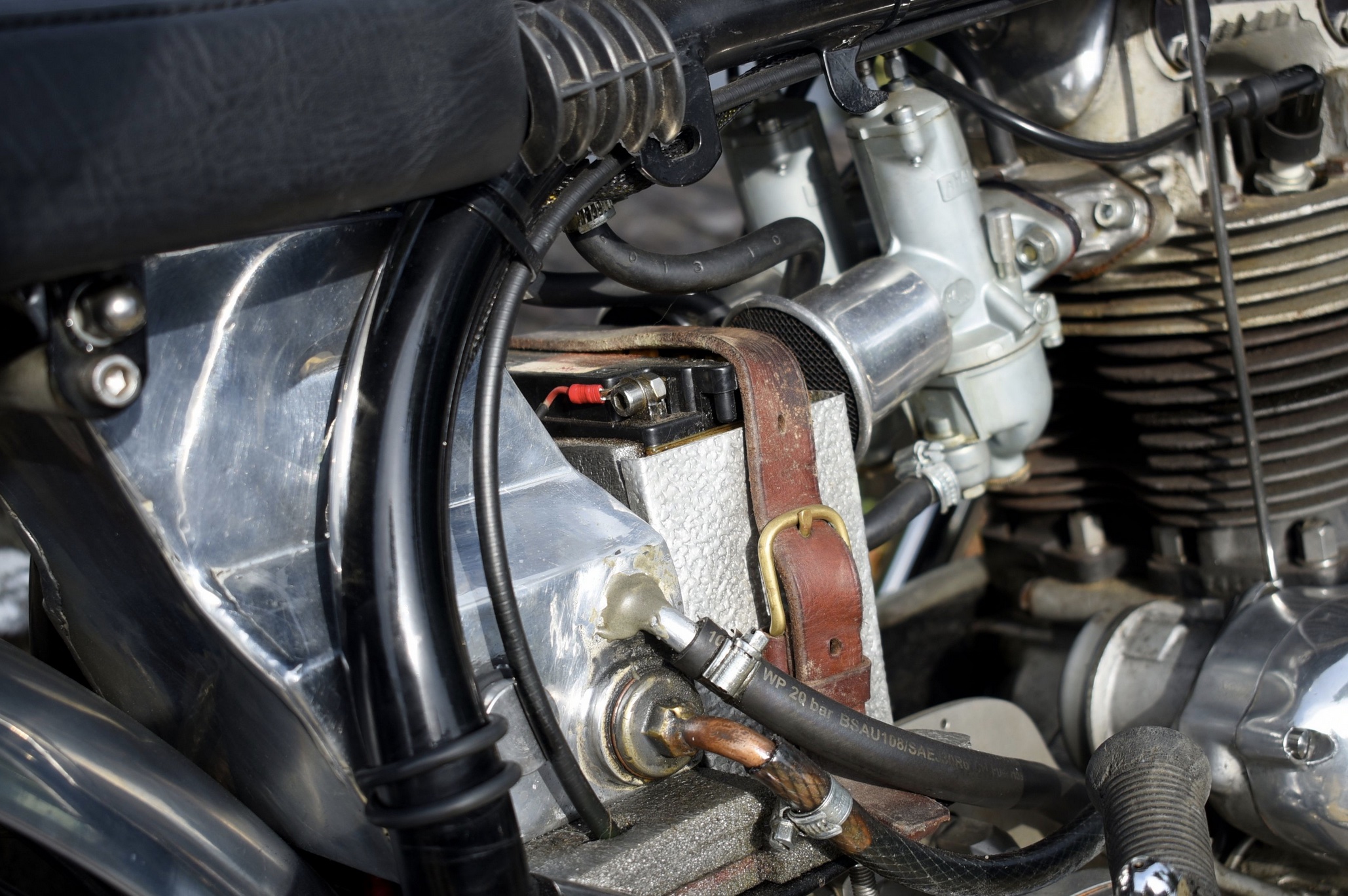

Front brake is over 'centre' makes it extremely inefficient-unsafe even. The araldite oil tank pipe is also a disaster waiting to happen.
The carb manifolds are Commando, wrong for the Atlas. This should have Atlass/SS ones (think they are the same) but do check the bore of head, manifold and carbs are compatible. Remove the carb trumpet and run without before putting it back (if you must) Observe the drop in bottom end performance first.

Yes,  front brake needs dismantling and correcting. Inlet manifolds look ugly , I would consider swapping for a single carb and manifold which will look better and be a heck of a lot easier for a newby to classic bikes.The carb trumpet is too close to the battery and will block airflow. These are pretty basic errors and makes me wonder how safe the rest is.

The front brake is not safe!
