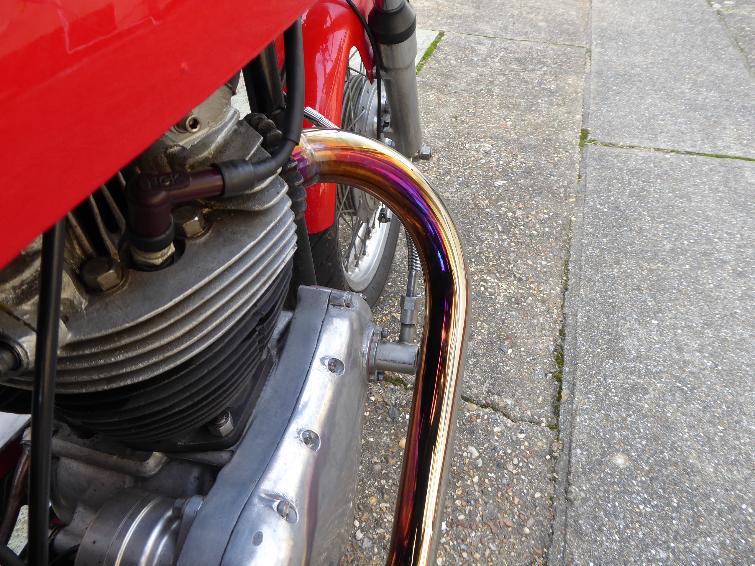

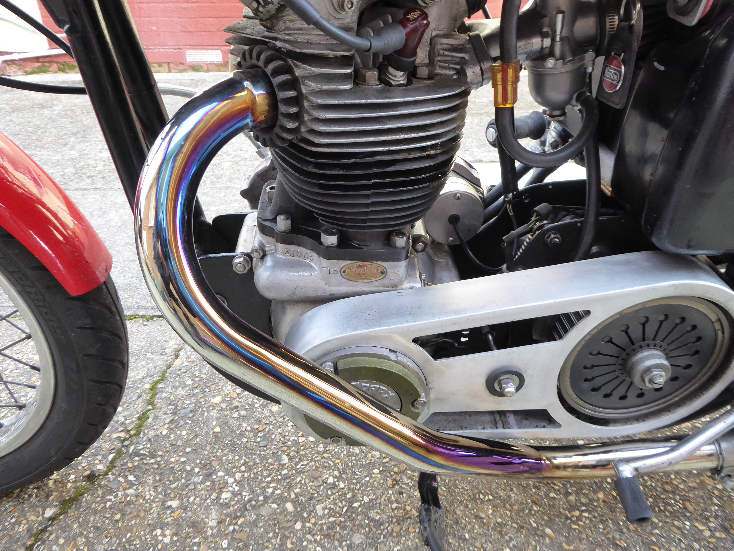

Hi Folks, I am rejuvinating a 650SS that has not run for many years, The motor seems sound, it was rebuilt many years ago. I have checked the timing, Lucas Rita, put a single manifold on with over jetted slightly, Monobloc carb, and it's heating up the pipes and blueing them. I have used E5 fuel. What am I doing wrong or is it poor chrome on new pipes, poor fuel, or is this the norm now? any advice would be useful. Thanks

There can be several reasons for exhaust pipes going blue.
If they are cheap pattern items then the thin tubing and micro-thin Chrome coating will be top of the Blues list. If they are only blueing in a couple of places then this could be a weak mixture or bad ignition timing. I don't think the E5 fuel is a likely cause.
I bought a cheap set of pipes that went blue after just 20 miles. The replacement set had better Chrome but broke at the head flange after 200 miles.
See attachments......
