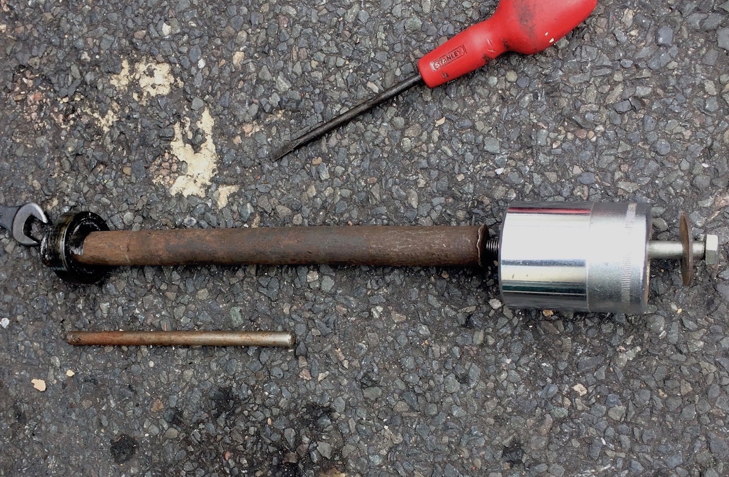

The rain held off longer than expected (piddling down now though) so I had another go using the torch inside the box. Outer race still not interested. I have devised a cunning plan/hare-brained scheme, but I'll have to wait until the rain stops ... Tomorrow's looking ok atm.
Result just in: DIY Slideh…
Result just in:
DIY Slidehammer United 1â0 Outer Race Asthmatic
slidehammer1-jpg
It looks like the bearing…
It looks like the bearing you have removed is a roller so it has been replaced before and I'm surprised if it was the source of your noise. You sometimes have to shim the end float on the layshaft with a roller bearing. You can however fit a high quality ball race in that position again a deep groove item that are more expensive than a standard item but they shouldn't need shimming. Give Mick Hemmings a ring for the correct spec

Yes, I get a feeling I mig…
Yes, I get a feeling I might've trashed that bearing for nothing ... But I wanted to leave no stone unturned. I'd read about the need to check the layshaft for shimming when using a roller, but interestingly no shims came out. Thanks for the info on Mr Hemmings' recommendation! I'll probably go that way ...

Well done on getting it out.
Thank you! It took a lot of heat, and a fair bit of slidehammering! No way was that thing going to pop out by itself, unfortunately. You never know when an angle grinder, a couple of thread-cutting taps and a battered old length of bar that I've probably had since the 1970s might come in handy! Now on to cleaning and inspecting the innards. Thanks all for the support so far!
