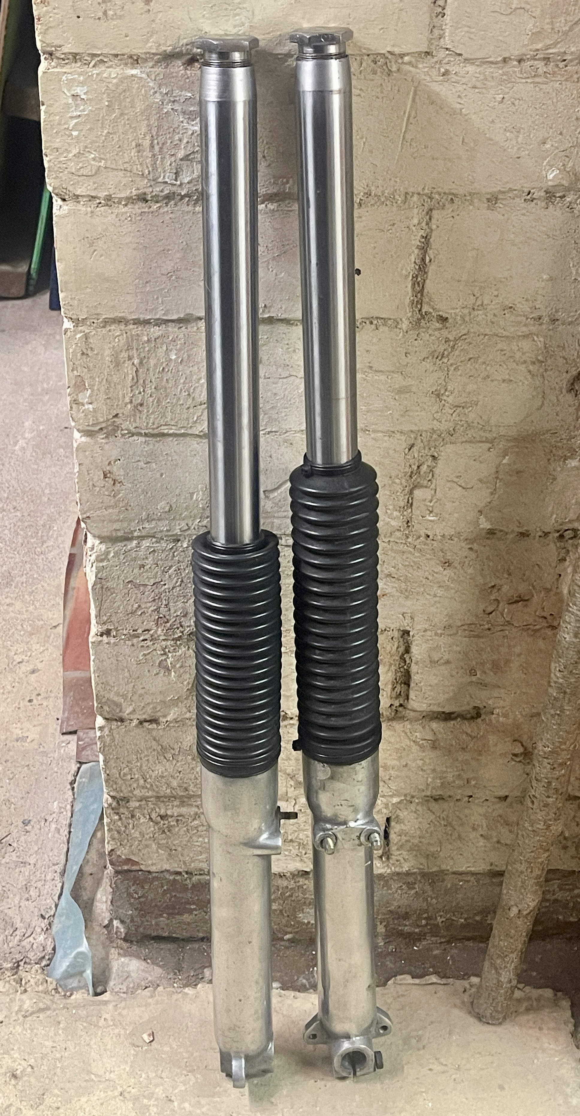

Hi all,
The performance of the forks on my 1971 Roadster have been in decline for a couple of years and after fitting a new disc and caliper I've come to the conclusion they're in need of an overhaul. Having had mixed results over the year reconditioning forks I think this one needs a pro. Before heading to one of the regular suspension companies I thought I'd ask if there was anyone in the club interested in helping out?
I'm based in Leamington Spa and so someone local'ish would be ideal.
Many thanks, Simon..
