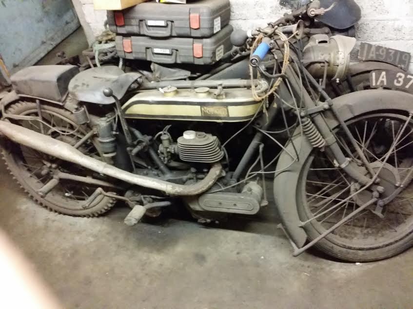

Sorry it's a bit of a bad image but this is the bike where it is currently being stored. Its a bit dusty and could use some tidying up but it's complete with no rust whatsoever and only minor things to repair like the grips. It's one of the earlier flat tank models and (I'm not sure) might be an early 16H? I'm sure someone on here would know better than me.

Hey David, I'm going to try and do it properly so I can retain the original number. My plan for this bike is to keep it as is and do the bare minimum to fix the various small issues. I don't want to ruin the originality by having it resprayed and everything which would be a shame considering how good condition it is in for it's age.
Definitely a candidate for oily rag only restoration. Dust removal only. It will look really good.

If you are really lucky it might just go - after new oil, freeing up the clutch, servicing brakes and cleaning the carb properly (i.e. the pilot jets etc). The last owner looks like he was a keen type with what looks like a later, bigger and better front brake than it would have had out of the factory, plus isn't that a rubber saddle? All part of its history and the front brake should be good enough for the road and quite a bit better than the earliest type.
The mag should have a long life mica condensor but unfortunately it might have the early magnets which need keepers in place at all times. So at the least it is likely to need to be remagnetised and then not taken apart.
He was also prosperous enough to tax it for 12 months!
The last owner was my great uncle who owned both bikes since the 30s, he and his brothers ran a country filling station and repair shop which is still in the family (that's where the bikes were discovered) so they were well maintained and period upgrades are fairly likely.
As for the repairs you suggest, I'm set up to do all but the remagnetising. How would I go about that?
