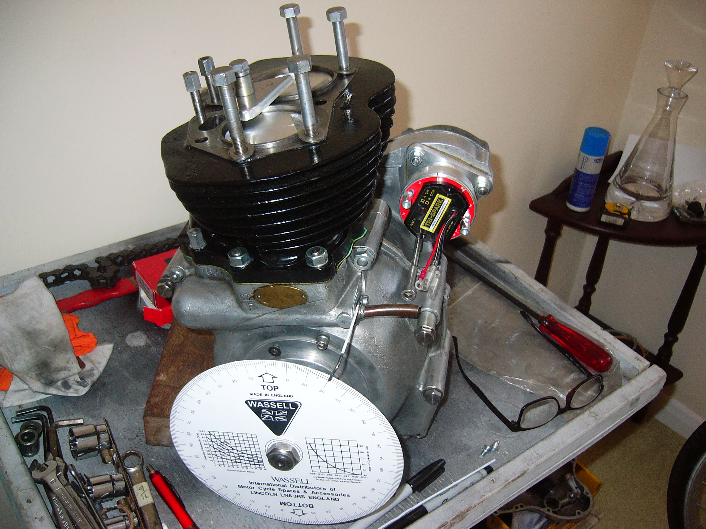

Fitting a Tri-Spark MRK-0001 to my Dommi 88 . I have no wiring on the new build at present and wondered what is the best connection to use Negative or Positive ? Is there a preference ? Also the installation instructions state the fully advanced position should be 38 Degrees BTDC where as all my books say 30 Degrees BTDC . I can only assume the 38 Degrees is aimed at a different engine ? I will be fitting a new 12v Stator /rotor just for your info.

The Fully advanced ignition point is dependant on the engine so follow engine advise.

I`ve been reading and printing off some of your very interesting info sheets Alan. I`ve also `saved `your web site . It would seem (having checked both my other modern bikes ) that Negative earth looks to be the most popular and like you say give greater choice of add on`s . The Tri-Spark does give a choice of POS or NEG and provides a wiring diagram for both . I have taken the advice from a note inside the Tri-Spark instructions to fit a Mosfet 20amp Voltage Rectifier/Regulator . I am still awaiting delivery from RGM and unsure if that will be polarity important ? I hope that choosing to go NEG earth is the right thing to do ?
As for the ignition I`m going with the 30 Degrees BTDC as the motor ( Dommi 88 500cc) is standard and that`s what the Haynes and my NOC book says . Your thoughts please .
