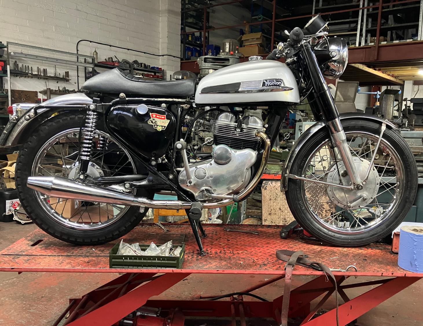

Afternoon All,
I've just had my Navigator rewired to 12v with a Pazon electronic ignition.  I can't recall how old or what type the existing plugs are so will treat myself to a shiny new pair.  Question is what type would be best suited to the new setup?  The carb is stock.
I see elsewhere on the site that the original plug was either NGK B7ES or Champion N4. Would these still be 'right' for my rewired bike or is some change recommended?  Thoughts please!

Thanks for your wisdom gents.  I should have added that I'm much more of a 'pootler' than a 'blaster' and that the engine itself has just been rebuilt with new valve-gear, pistons etc. etc., so is in very good nick.
I suppose that asking for plug advice is the same as asking how much vermouth to put in a martini. Everyone has their preference!  Is the same true for the plug caps?
