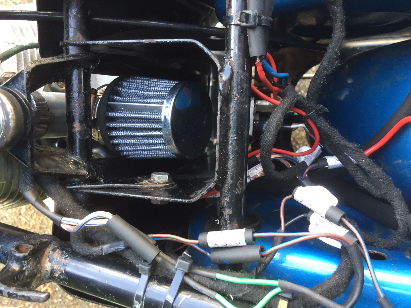

In my experience Steve there is very little room on a Lightweight twin for anything but the sort of small conical air filter shown in the attached photo.  It shows how I fitted this one to my Navigator; because it offers so little restriction I found it didn't need any change to the standard jets and only a very minor adjustment to the air screw for smooth running.   I bought it from Hitchcock motorcycles who have an excellent selection of Amal spares and accessories for the Royal Enfield Bullet (one of my other passions!).    The Jubilee / Navigator parts manual lists an air filter as an optional extra which fitted between the vertical main frame pressing behind the carb but from discussion elsewhere on this forum no one has ever seen one let alone found one!   Frankly, back in the day no one bothered because unless you were in a very dusty environment it wasn't considered worth the expense.    In sum I would bight the bullet and buy a new carb with standard jets - you can then be confident that you have ruled out one major problem area providing clean fuel is flowing freely from the tank.   Off to search the workshop for my compression tester......

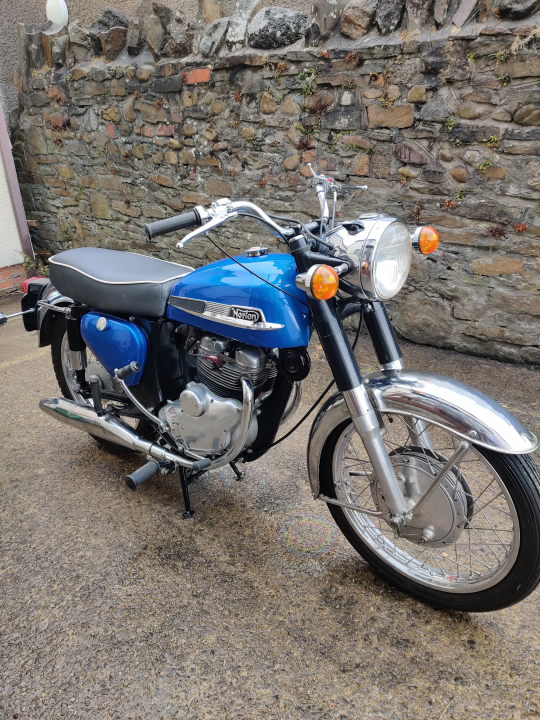

Thanks everyone for your comments after getting back to working on the bike (after a year) I have found the starting problem it was all my fault I had set the valve timing wrong I had used a mark on the crankshaft gear and not the keyway, it started up today with not to much of a problem :-)
Its a brave man who admits, I c***ed up, so congrats Steve for not burying the fault.
Nevertheless, loads of sound info in this thread, well done all who have contributed. It's why I keep coming back to these Forums
All most ready for the road number plate is on the way and then some petrol and I will be on the road. Thanks everyone for your help over the last couple of years
