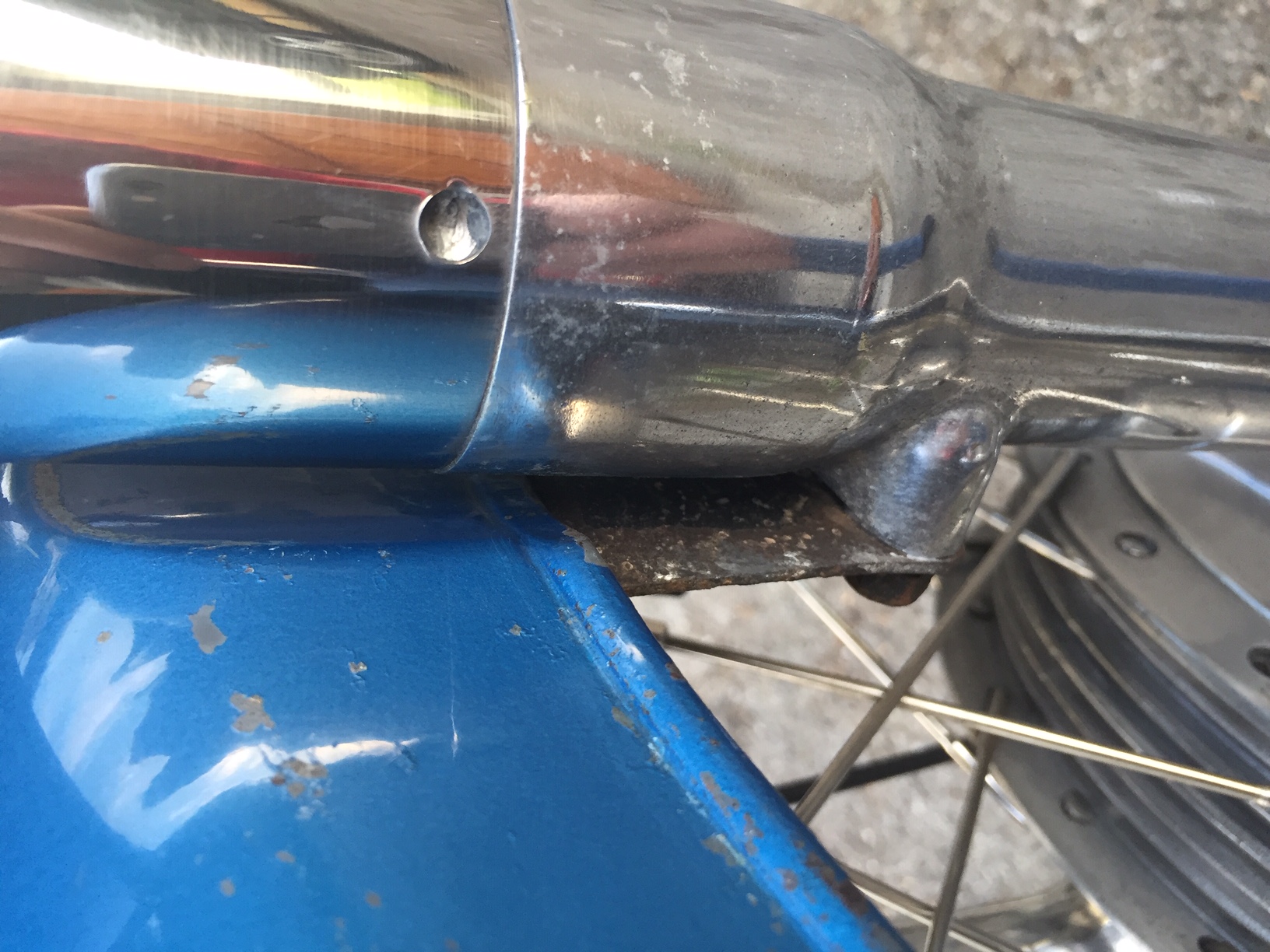

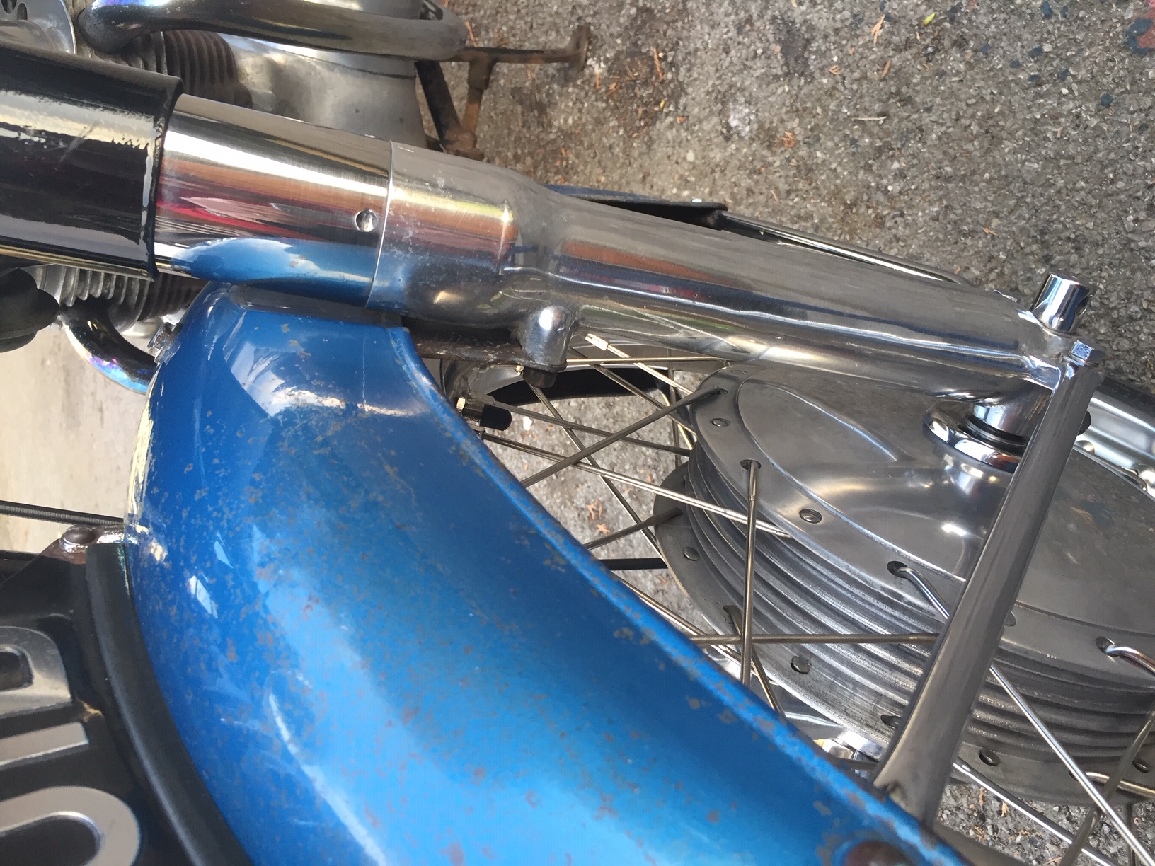

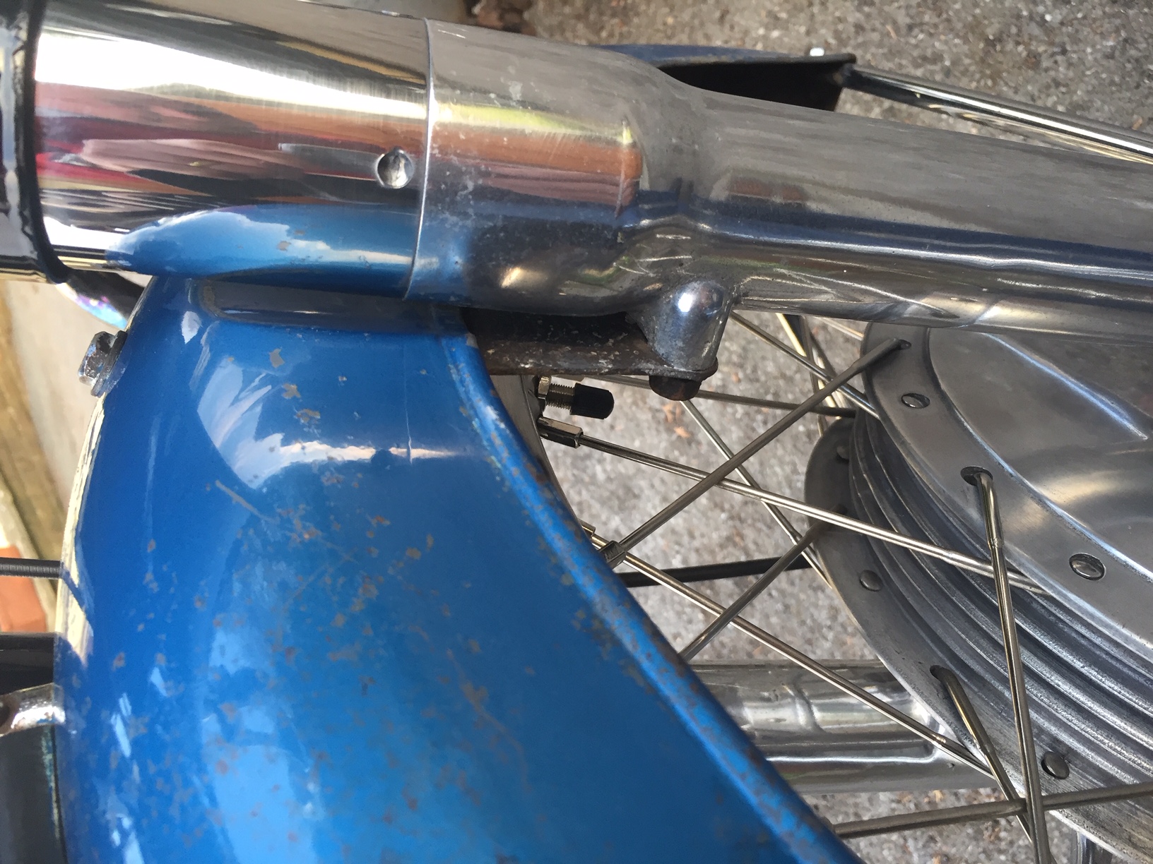

Steven,I thought some…
Steven,
I thought some pictures of my unrestored 1964 Navigator mudguard bracket might help. They are the later 7 3/8" forks and the mudguard and bracket are original. As you can see the bracket is a straight 'U' with no spacers and the mudguard is quite a tight fit. Good luck with yours.
Nick
Hi Nick Thanks for the…
Hi Nick
Thanks for the images they are a great help and it looks like I have the 7" bracket and the 7 3/8" forks.
Again thanks
Steve

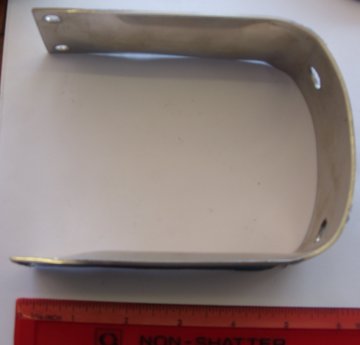

Malcolm,I'm not sure if…
Malcolm,
I'm not sure if this will fit but looking at the Norvil on line catalogue they list a 64 on front mudguard stay / bridge which looks remarkably like the one on my Navigator with the 7 3/8" Roadholders, it even has the two bolt holes on top to attach it to the mudguard - very expensive at £24.66 but perhaps worth a look? I've attached the photo from the catalogue - part number 030254. If you decide to go that way can you let us know if it fits?
Nick
