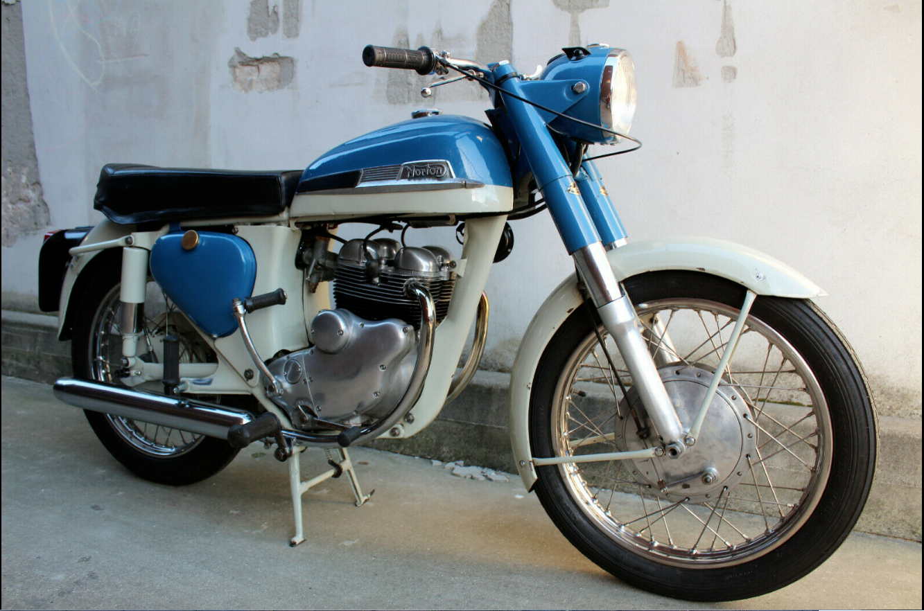

Good afternoon everyone.  I have just bought a Navigator, or at least I thought I did.  I've been going through the bike, seems OK, never going to win any prizes for finish but seems to be mechanically sound if somewhat oily.
While checking the bike over I noticed that I could slip a steel rule between the cylinders, rather worrying that, I thought Navigators had a one piece cylinder block. Comparing pictures of the Navigator and Jubilee cylinders it looks like the engine has been fitted with two Jubilees cylinders.
So, what does this mean?  A smaller bore is the obvious thing.  What about con. rod length?  How can I tell if the engine has Navigator or Jubilee heads.   The crankcase are Navigator, it has a "19" stamped adjacent to the engine number which, I believe, identifies it as Navigator.

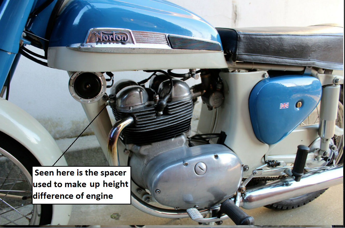

I'm in contact with the seller of this bike. He sold it as a Navigator - because thats how it was sold to him. Its been well put together by somebody who clearly knew what they were doing. I have seen pictures of the bike & the only external clue is a piece of packing under the head steady that shows that the engine is not as tall as the original 350cc unit.
This conversion to 250cc is possible, as the Crankcase, Timing case, Primary chaincase & gearbox are all common (except 17T on g/box sprocket vs 19T on Navi).The items that were changed are all to do with the engine:

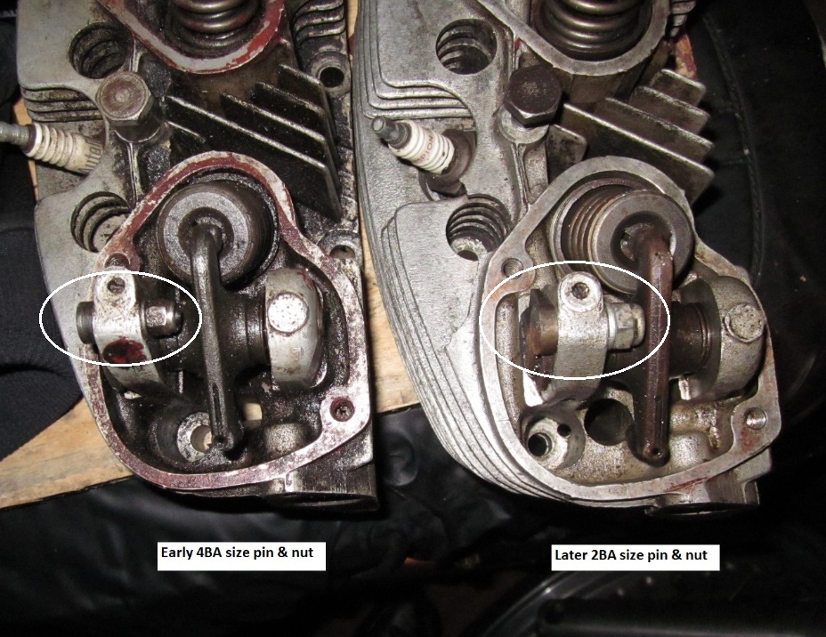

If your cylider block has a spigot - do not remove it. Find a pair of heads to match - ideally with the larger 2BA clamp screws - the earlier 4BA ones were not strong enough.
clamp screws
