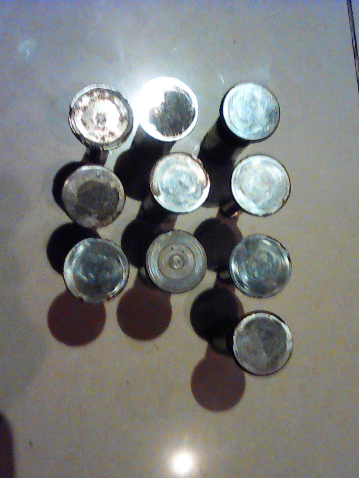

The picture shows four followers taken from a Navigator. Chemical de-rusting highlights the worn stellite surfaces. One OK, and three replacements on their side.
Cheers,

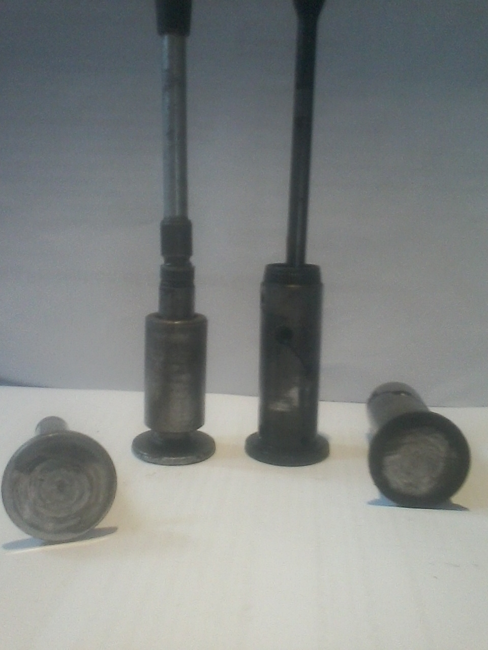

Hi Peter  your picture confirms the typical wear I found on my camfollowers. The rattle between the barrell follower stem and the follower guide is where all the noise comes from. I made my own followers to attempt to get round this. I inspected my followers after 500miles  see 2nd image. I have subsequently gone 3000miles and will only inspect again if there is mechanical failure. It is the only way I will find out if something can be done to deal with the wear that all these lightweights seccumb to  because of their design.

Great bit of engineering Graham and thanks for that!   From the look of it you not only made your own cam followers but guides and push rods too - am I right?    What materials and treatment did you use to harden the cam follower working faces?   Has it made a significant difference to the mechanical noise form the engine?
