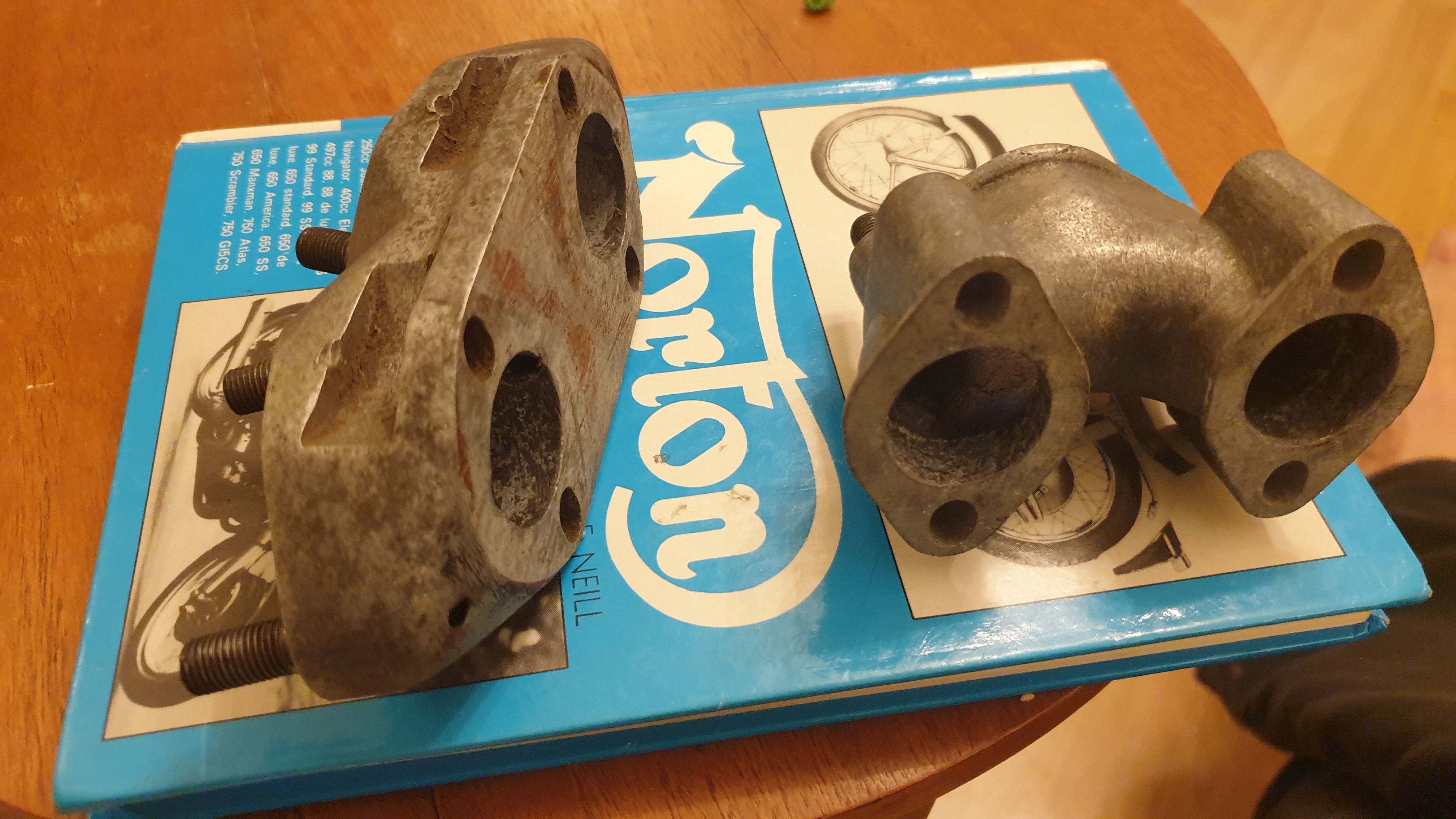

Further to Peter's mail. The holes in the manifolds were made oval by the factory. Two examples here are very clearly oval. But how nuts would have put on studs at 1.5" spacing is anyone's guess.
I guess none of the manifolds are factory milled with oval holes if they came to the US? Which head would they match?
All four of mine are clearly round holes only. Since they are SO common there in the UK, manifold confusion may be rampant and therefore a need for a popular publicized bodge?

I fitted a factory splayed manifold to my 60  big valve  88   and mounted a pair of monos from a 650 SS,did not change anything else and it would  drag race alongside  a 99SS  up to 90 mph  .No oval holes in the manifolds anywhere.  That looks like a bodge to fit wrong parts .
All I know about these is that my Dommie's PO had a 99SS and 88SS for sale and I bought the 88. He threw in some spares, some of which I layer realised were for the 99. These two manifolds were in. One seems to be for standard single carb, and the other splayed to mount twin carbs. Both have the same oval holes. He was a very competent machinist so he could have done it.  I've no idea of originality, but there must have been a reason common to both of these and, I suppose, Pete's. Did the very early heads have studs at 1.5"? It would make sense for Norton to carry on using the same parts.  Ps..bored and don't want to work in the shed...it's snowing...
Hi David  ,  I think the splayed manifold you have was for the earlier head   and has been worked on to fit the later one  .  Its what we did back then.
