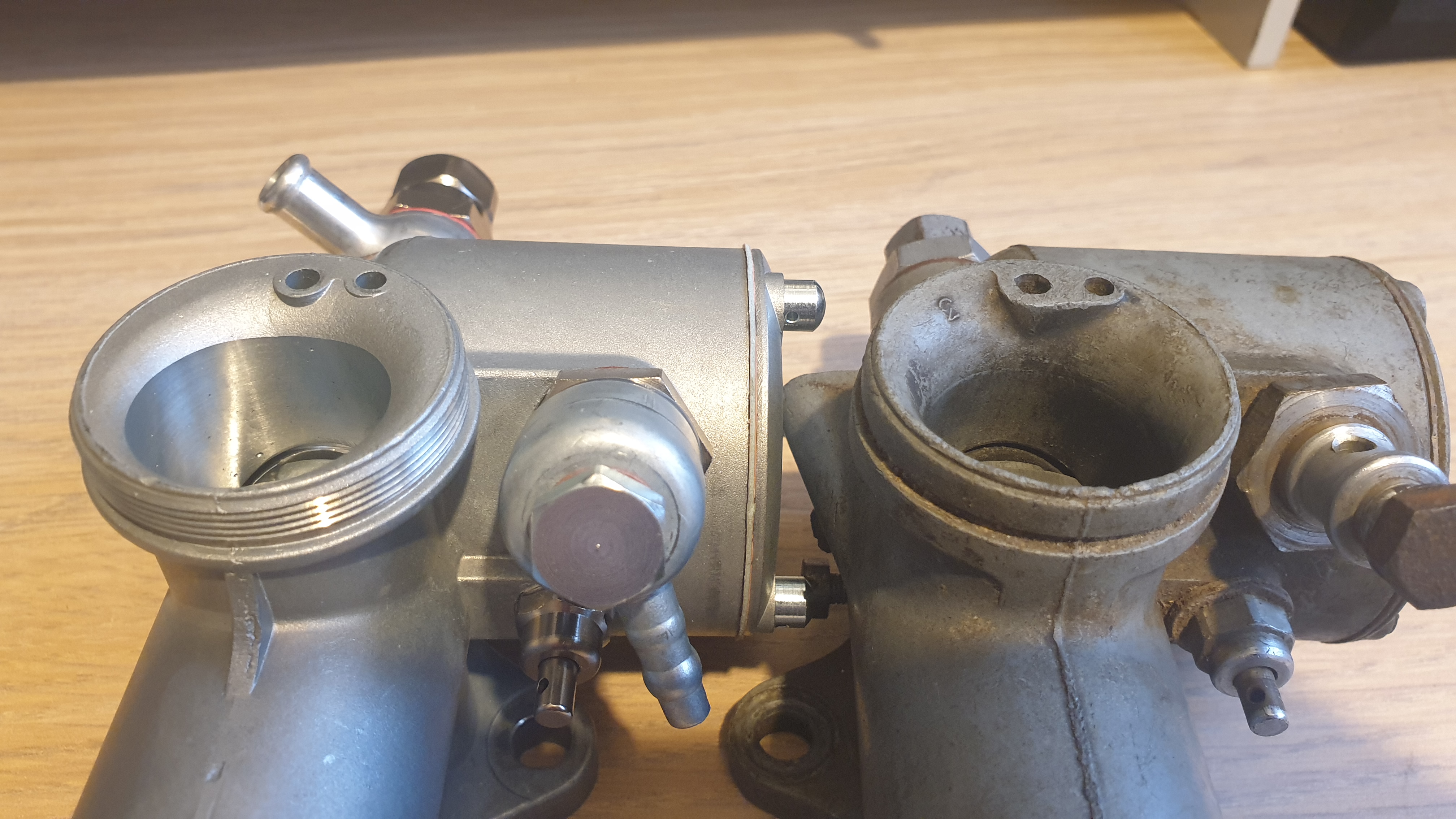

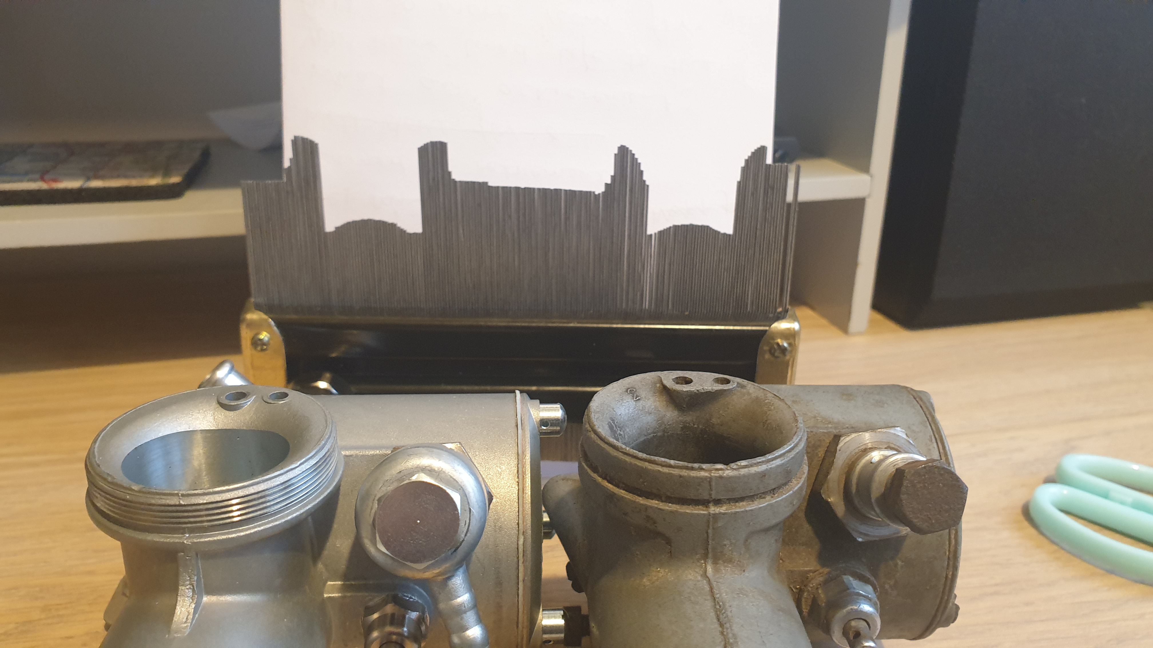

Sorry for yet another post, but I thought the differences between the shapes of the inlets of a new and old Monobloc might be of interest. I feel at attack by Dremmel will be needed.

I know that I’ll probably get buried under a hail of negative replies, but is the sharper profile of the new carb really likely to cause that much of a difference?
Maybe it will make the carb run a bit richer? Then again, maybe it won’t have any effect at all and David can put away his Dremel and grinding wheels before taking action :-)

David, - To be honest, I'm with Tony, What is the likelihood of needing that last 200rpm, 2mph or whatever the effect will be, (unless of course it is being prepped as a racer..).
I'm sure that after the usual 'set up' tuning, that when being ridden as is it will be perfectly fine as it is.
Also, leaving it unmodified means if there are any issues with it, the guarantee will be valid. As soon as the Dremel hits it.....
Also, whether you fit meshed bellmouths or better air cleaners, you won't even see it.

Interesting pics
The new one looks bored slightly off centre to the casting. Don’t think originals were machined at all in this area. Interestingly the old one has not had the bellmouth threads machined either. Leave it alone, might be even better as is but I seriously doubt there would be any measurable difference
Factory savings
I am guessing that whichever factory made the castings was saving some money by not using a multiude of patterns. They just cast the smallest bore units and then simply bore them out to whatever size is needed.
It would seem to me that the airflow will be upset by the sharp edges at the transition from the casting to the machined out bore.

I've take the risk regarding guarantees and rounded the corners. I'm sure it makes no difference. There is what looks like a good Wikipedia article on 'carburettor bell mouths' and the conclusions seem to be they might make a tiny difference at the top end which just might assist in a race where seconds count. I think Michael must have the reason. When they made hundreds of thousands a year, they must have used different moulds for the 376 carb from 15/16 to 1+1/16. Not now.

Thinking has changed on super smooth inlet tracts and they are only considered a good thing for fuel injected engines. Carburettor engines benefit from a little turbulence.
The Gold Star has a distinct step in its inlet tract, and machining to achieve a smooth bore reduces the maximum bhp. I guess with a 1 1/2" GP that any help getting the fuel to evaporate must be beneficial.

David it's a very complex fluid dynamics question, certainly beyond me. But I do know that dimpled golf balls go further than smooth ones.
I read that american tuners no longer favour super smooth polished inlet tracts, but more to do with efficient evaporation of petrol droplets I suspect.

... the profile on the new one is decidedly angular.
