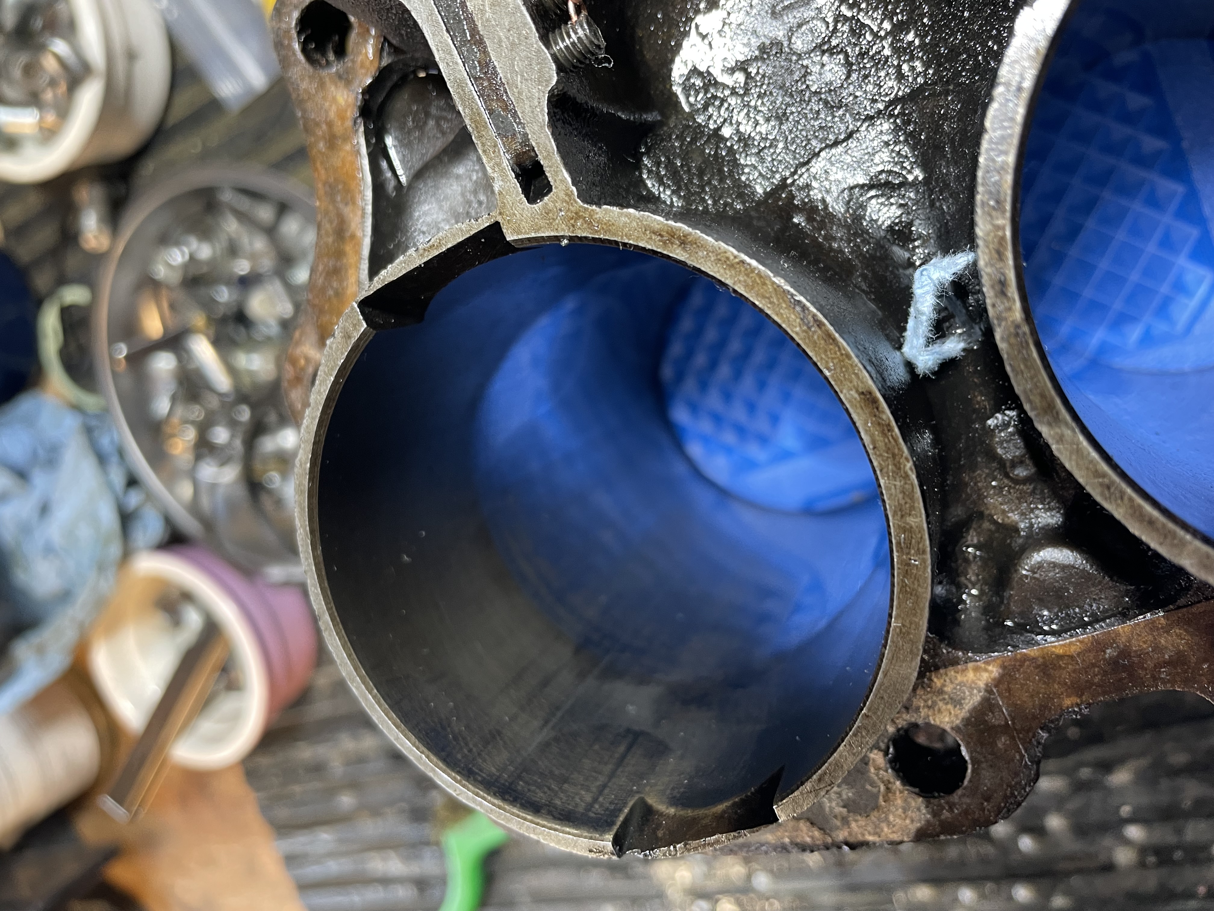

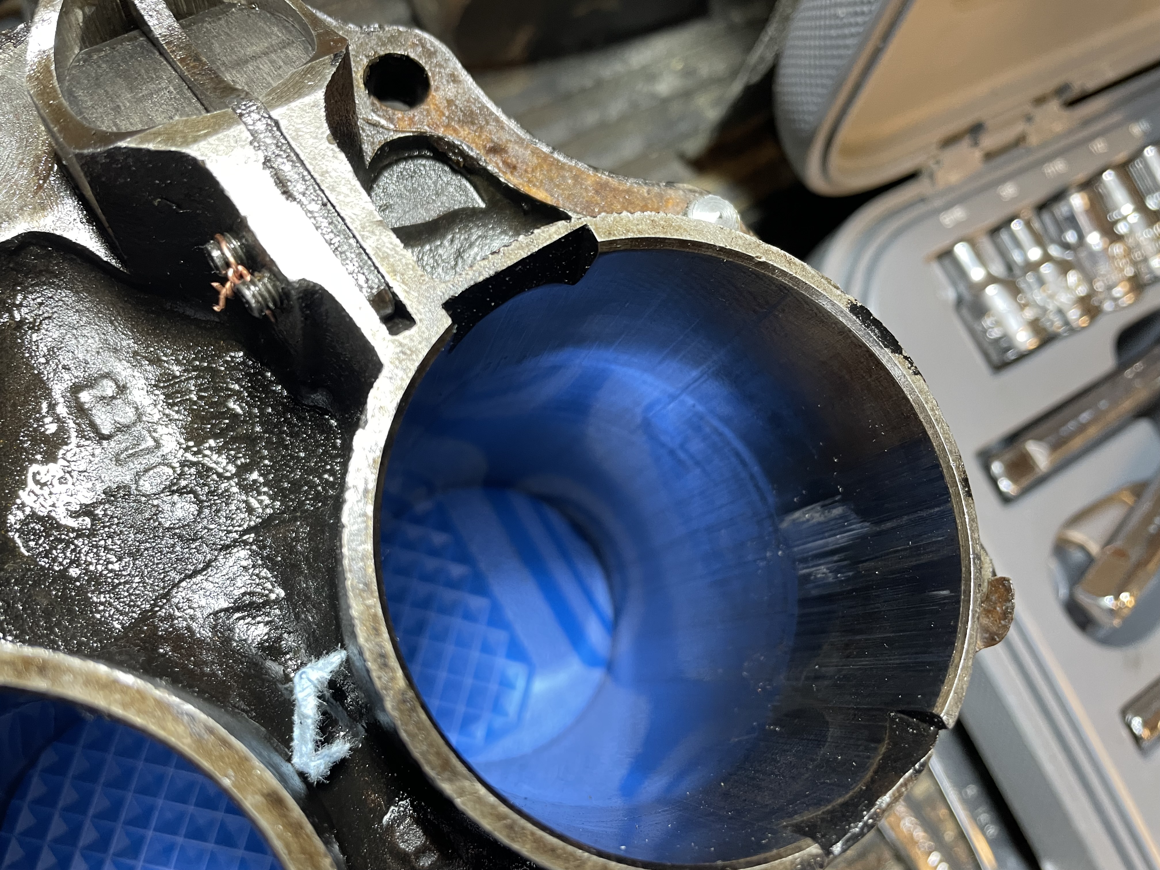

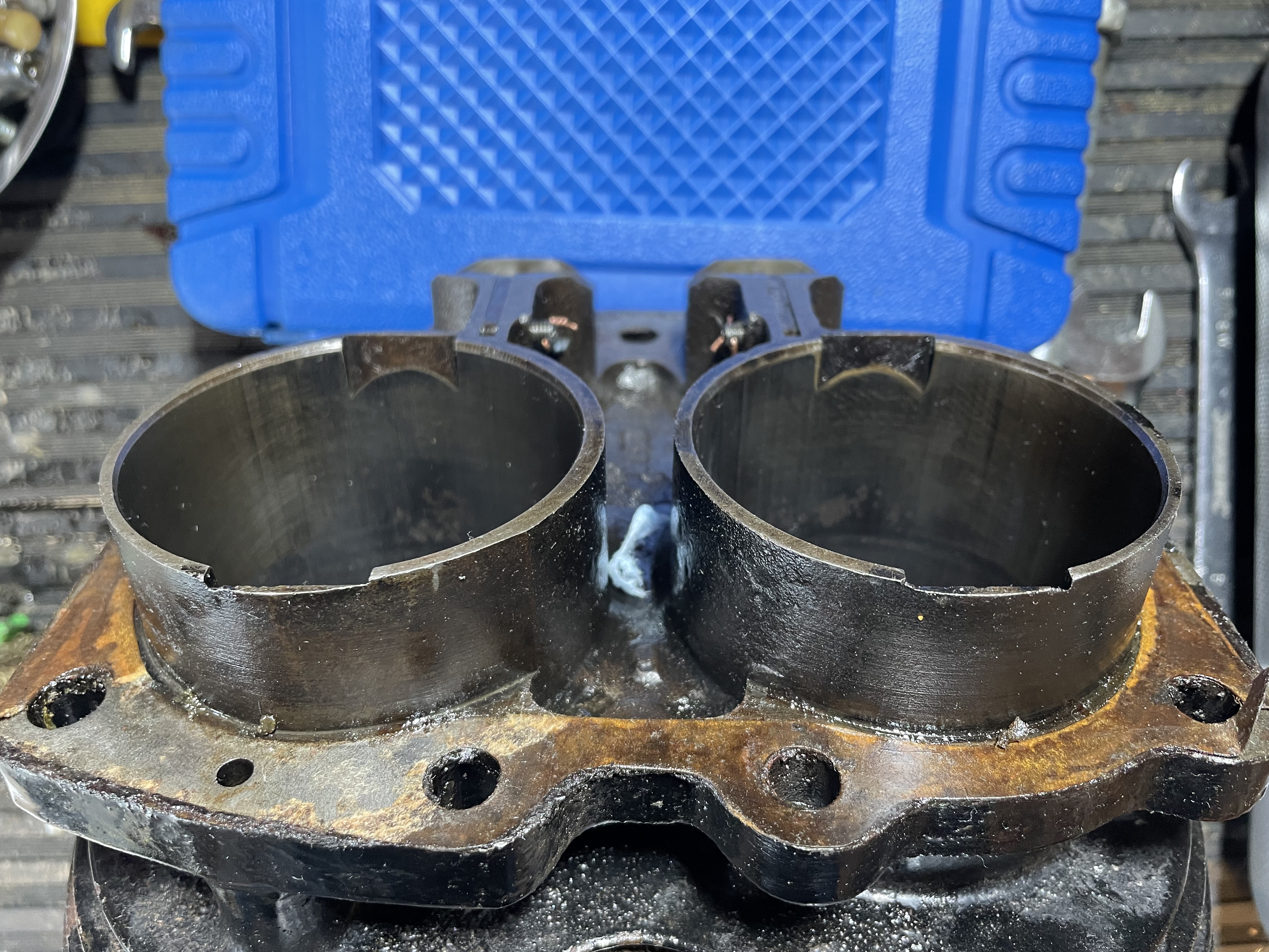

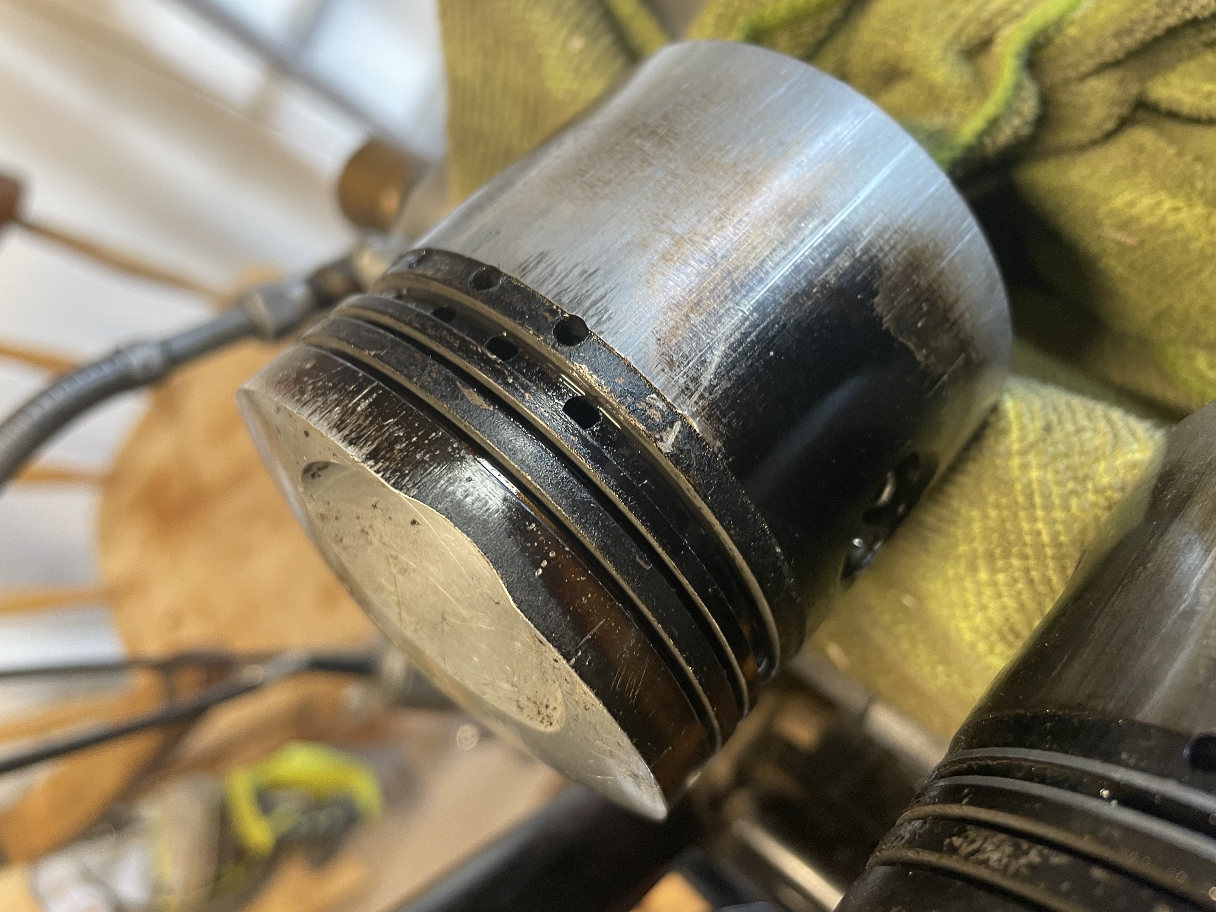

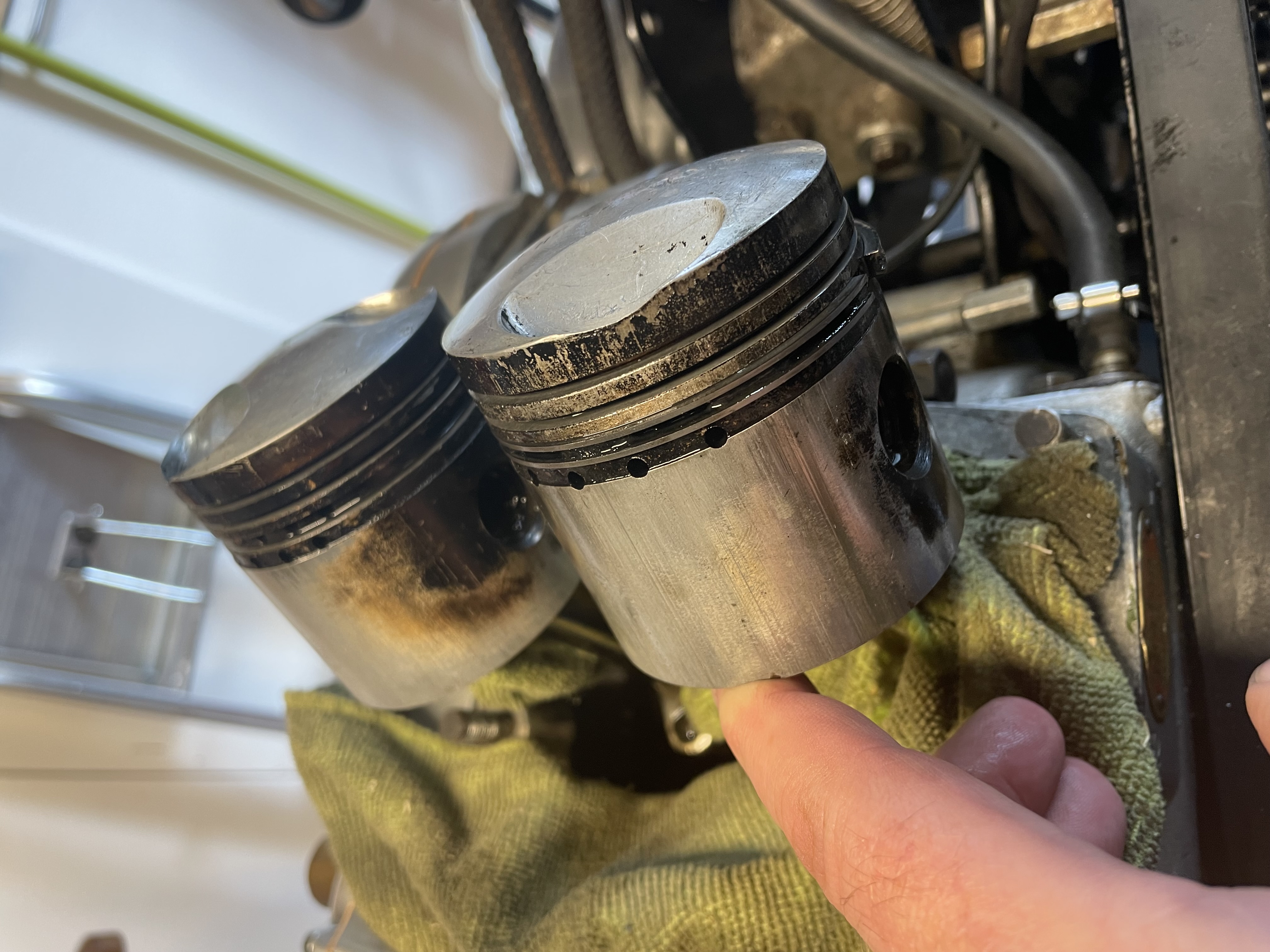

Investigations into the loss of compression have led me to gird my loins and examine the pistons and barrel. Both are worn and need to be worked on - see the attached photos for the grim realities.
OK - obviously I need new pistons but I'm already at +040 so it would seem common sense that the barrels will need re-lining. But this is a 99 barrel and Service Notes etc is very clear that the barrels will need to be "heavily modified". That said the cost of a 650 barrel looks to be around £500+ even before any work is done let alone considering the spigot issue on my head. Retaining the spigot seems to be an important consideration.

Pictures as promised
More Pictures of the offending article

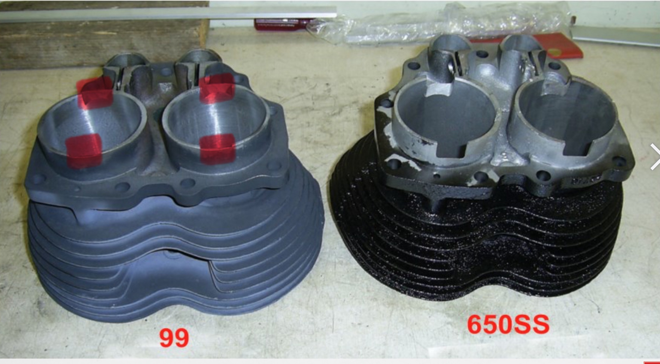

Photo one pinched from Service Notes to illustrate the problem. The areas I've highlighted in red seem to need removing to bring the barrel up to SS spec.
Photo 2. There is already a small chamfer on the existing 99 barrel that seems to show where the skirt need to be engineered.
Other photos showing the linings of the barrel for context.

Your crank/conrods should be ok as you say they are unmarked (conrods clear of the barrels skirt)

The DSNs are correct re. the advice on converting a 99 or even later 77 barrel for use in a 650.
It is not just a case of chopping a few chunks out of the sides of the bores/liners.
The photo depicts a 22709 barrel casting which would have the narrow pushrod tunnels suitable only really for non-SS pushrods. Sometimes these tunnels do have enough room machined in them (by accident) to take the fatter SS pushrods but most of the time this does not happen. The SS pushrods then catch on the tunnel lip and rubbing against each other.You really need the 22710 casting made for 650SS engines in late1961. These had the front exterior of the pushrod tunnels extended forward by around1/8th inch and the tunnel bores more accurately machined.
A couple of points regarding boring out the barrel to +60". (or even 80" was available at one time.) This tends to make the spigots very thin and prone to breaking and not only at the top of the liner but also at the bottom. Again the photographs show the bottom of the bores are not central in the cylinders. A rebore exaggerates this problem.
If a rebore is chosen, then do have the spigots machined off. With standard pistons fitted, the tops will nearly be level with the top barrel flange and the spigot gap in the head will accept any protrusion.
As an extra safety point, just in case the pushrods run out of adjustment, it is possible to purchase solid copper head gaskets in several different thicknesses.

Do not machine the spigots off, or at least not until the machinist or whoever measures your barrel and assess it for spigot thickness. Looking at your photo in your previous posting the spigot will be ok even when bored to plus 60. Measure the spigot thickness with a set of verniers and report back. What stroke is your crankshaft? if it is 82mm it is a 600 crank, 89mm for a 650 Find out what you have got before deciding on the course of action. Have your pushrods been binding in the pushrod tunnels? if not, no action needed there. The conrods haven't been touching the barrels skirts so no action/machining needed there either.

For the most part this is .089 to .080 on the outer parts of the barrel but reducing to .055 to .059 on the inner sides of the barrel.
Does this tend to rule out moving to a .060 rebore? I don't have a bore measure to check the bores but the most recent bore was at .040 apparently. Taking .02 off the bore would suggest this will be tight on the inside of the spigot but I don't know much about this.

Ok, confirm your barrel is at plus .040 (measure at the btm or top of the bore with your vernier should give you an idea of its current size, even if it is not as accurate as i would prefer) At plus 40 it most likely has been rebored twice, maybe three times before, depending on what oversize pistons were available back then. Now in the past when the cylinder has been set up on the boring machine and depending on how skillfull/diligent the machinist was in setting up and aligning the machine has caused the spigot error to manifest itself. If i was boring this cylinder i would set the machine to take as little from the 'thin spigot wall side' as possible along with boring the cylinder to the correct size. A good engine shop should be able to do this, if not look elsewhere. If your cylinder will accept a .060 plus rebore be aware it is just .010" per side so even if the cylinder is set up central, your spigot thickness at the thinnest is down to .045 to .049, still plenty strong enough, now if your engine shop will correct the error (as much as it can) that has crept in over the years, It might keep the spigot thickness to .050 - .055 at its thinnest. It all depends on how worn the bore is and who you get to do the job.
