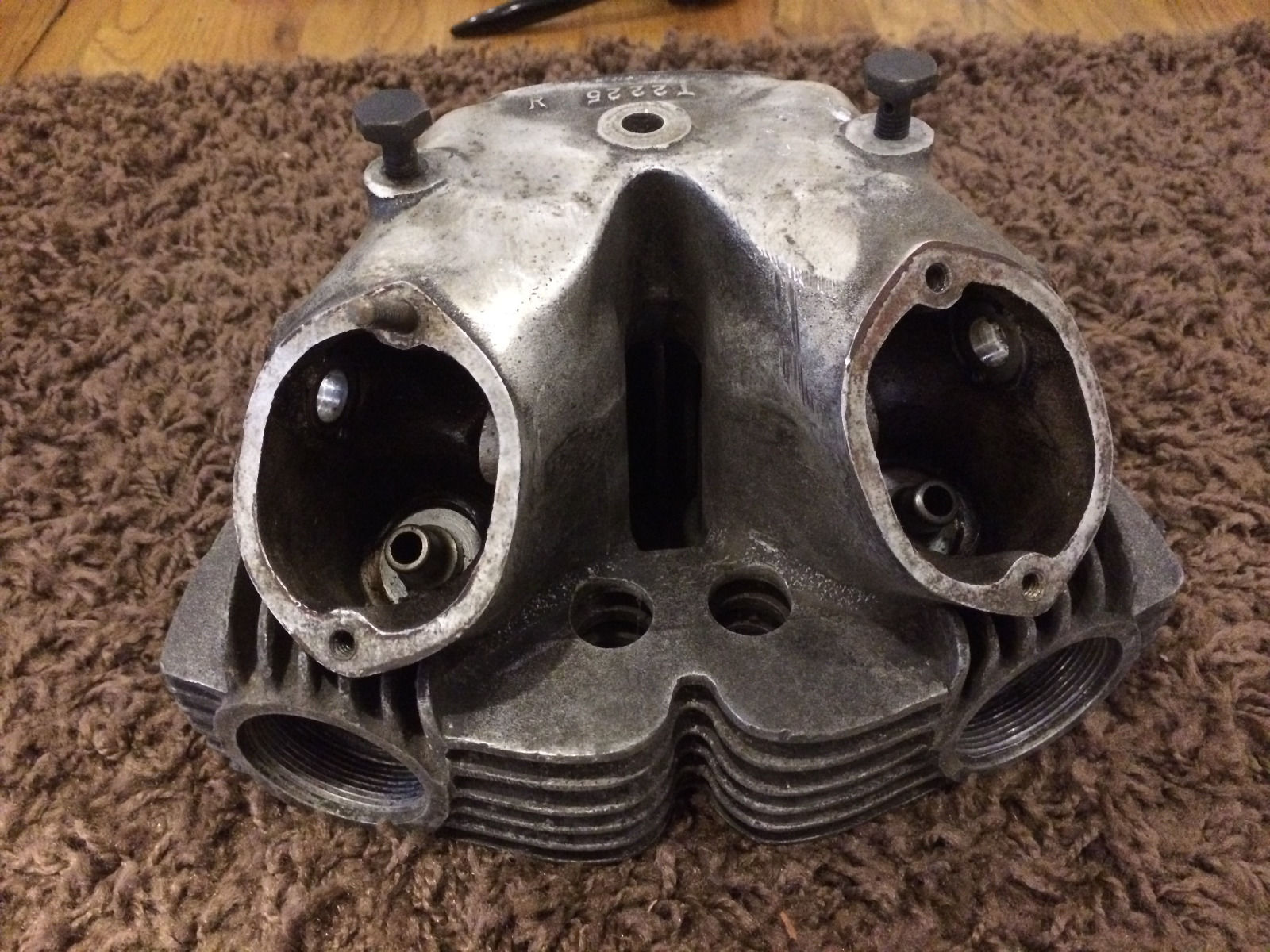

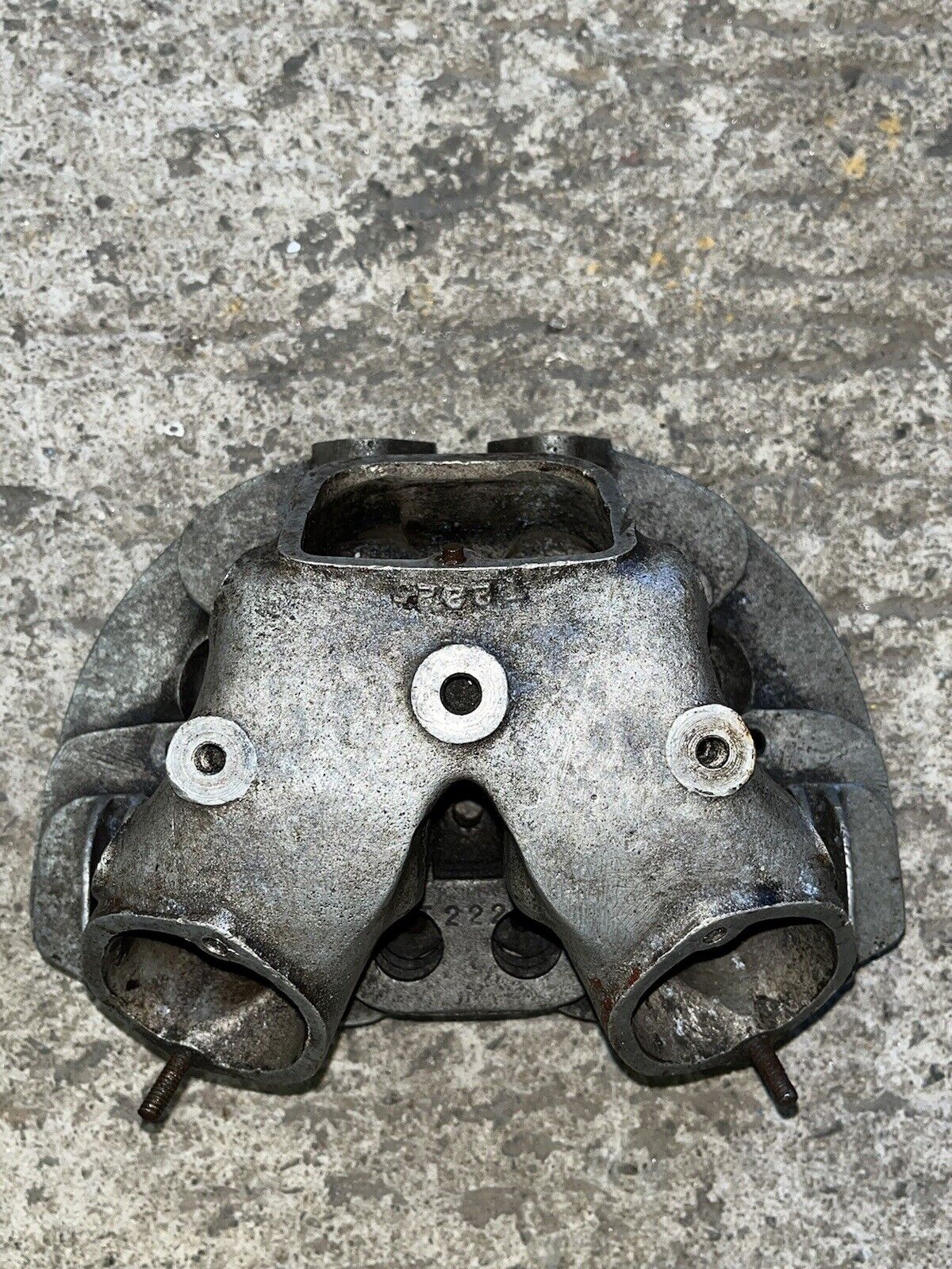

Hi Richard......The T2140 cylinder head that is currently on your Norton is, as you suspected, the wrong one for the model 88. Your bike should be wearing an Alloy T2225 head. However there are actually five versions of this later head including two Alloy versions, an Iron version and two Alloy racing versions.

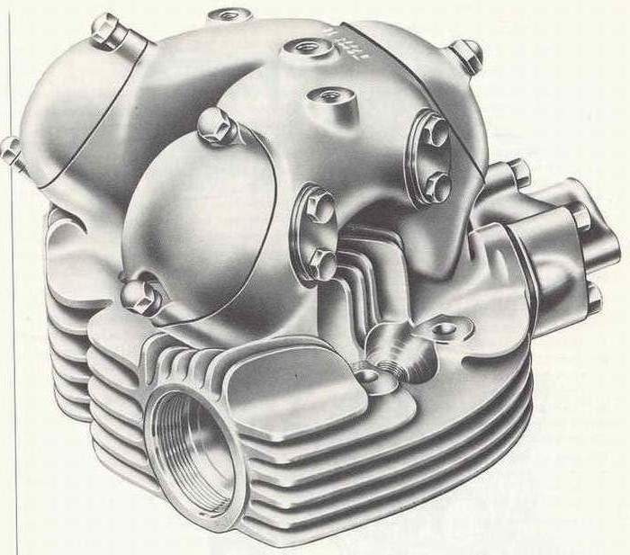

The T2225 head appears to have been available from 1952 onwards cast in both Iron and Alloy versions. Initially the Alloy head was sold in limited numbers and only to selected owners/racers or fitted to the export Model 88. The same casting number was used on a post-1957 Alloy version which had enlarged finning. This is the version you need for your Norton. See attachments.

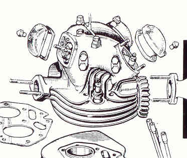

The T2140 head was fitted to the first of the Model 7 Nortons sold from March 1949 onwards in the UK. This had a separate bolt-on carb manifold but kept the one-piece spindle/cover of the original 1948 head design . Production of bikes using this head was limited and by the early 1950s it was superseded by the T2212 Iron head. The reason for the change appears to be related to servicing problems encountered when a build up of carbon, inside of the rocker boxes, prevented easy extraction of the spindles. Resulting in the oval end plates becoming too damaged to be re-used without leaking oil. On these early Dominator heads the rocker spindles had to be removed so that the rockers could be moved to allow, in turn, the valve springs to be removed.
