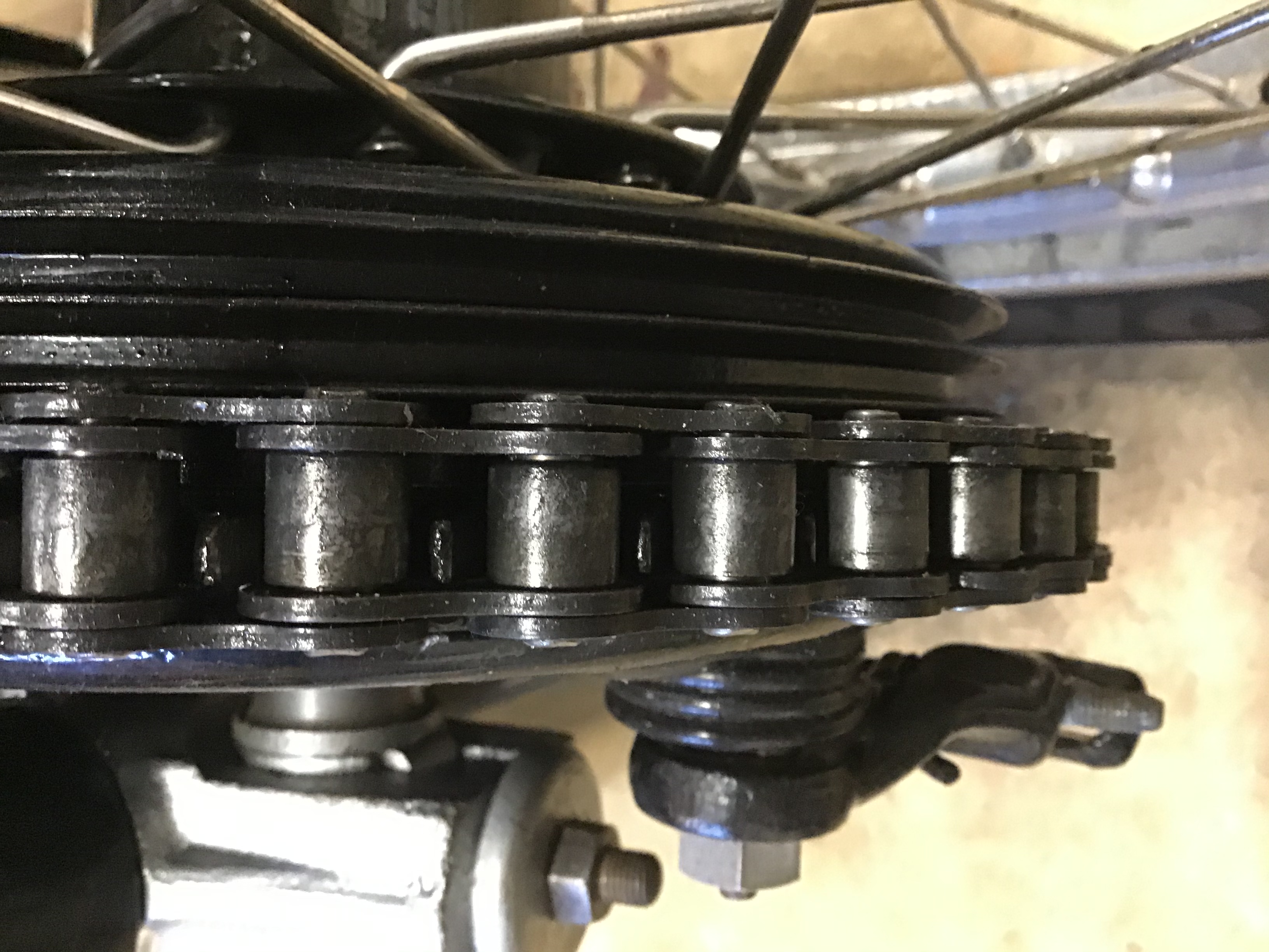

I fitted a 5/8 x3/8 chain final drive chain to my 1952 Model 7 plunger, from the spec in a Main-Smith manual.  Got the bike running, registered and then found a couple of oil leaks.
So took it apart this winter and noticed the chain had rubbed the face of the gearbox and also the inside face of the chaincase.
Did I fit the correct size chain or should it have been a 1/4 in chain?
The teeth are 5.5 mm at the tip of the teeth and 6 mm at the base both gearbox and rear sprockets. There seems to be a fair bit of space difference between the teeth width and the roller width.
Thoughts?
