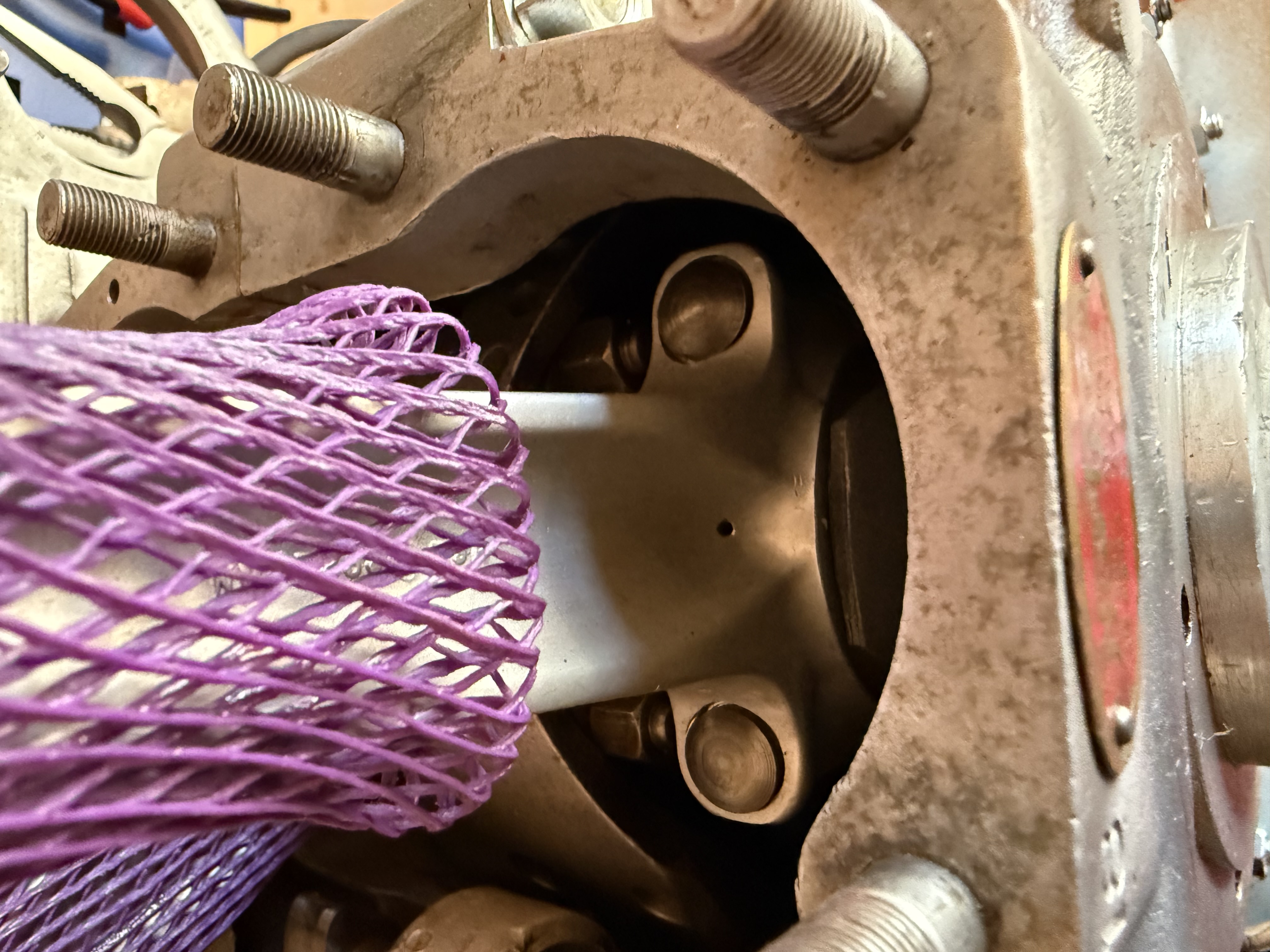

The question of the moment revolves around the existing con-rods and the changes I'll need to make to run these. These are the later Mk 2 Conrods with oil spray holes. Service notes are clear that if using these then you have to use a 6 start gearing on the oil pump.

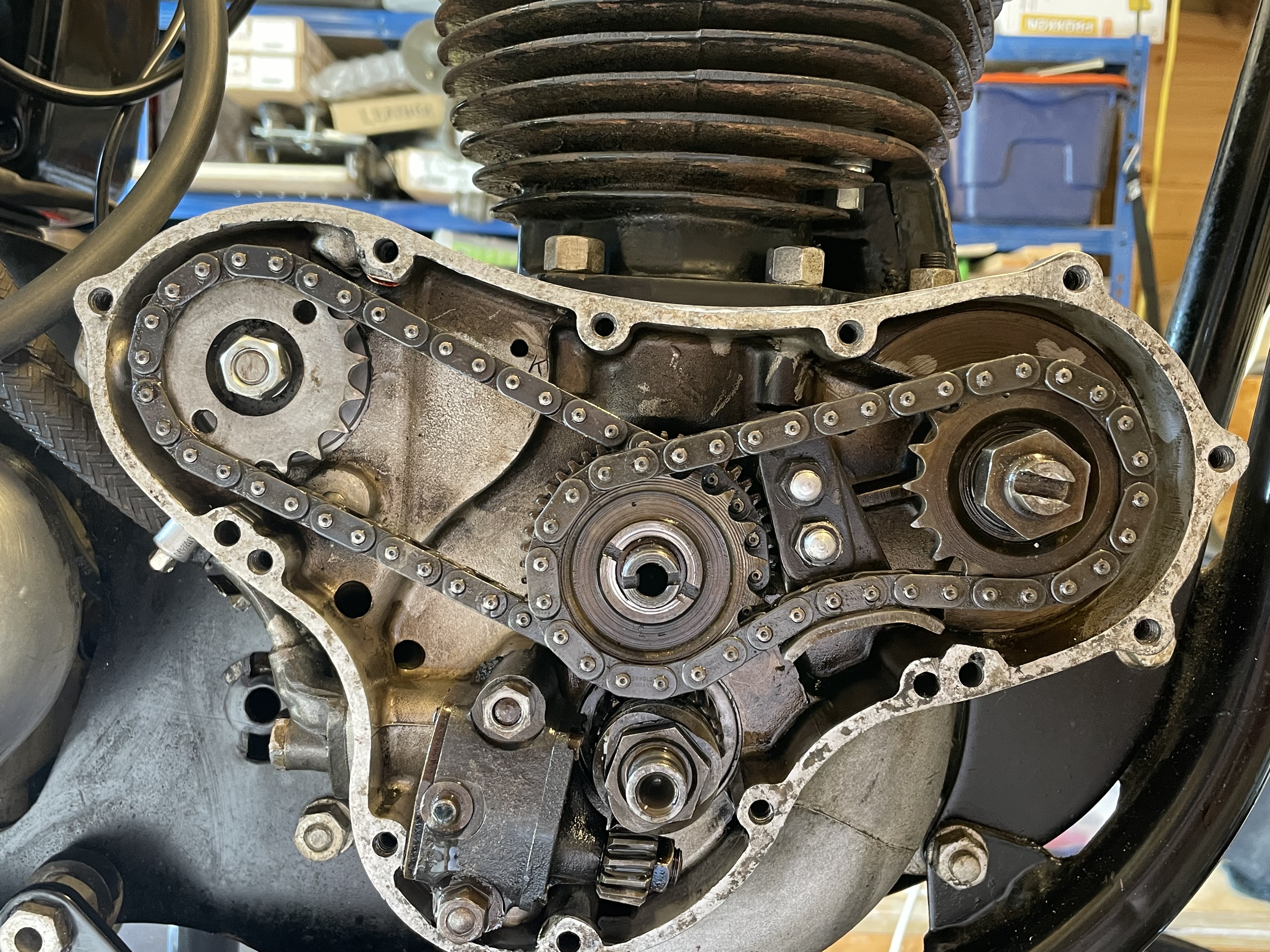

My current oil pump is a 3 start item (see picture) so I'm assuming I'll need a new pump and that the three start won't work efficiently even if I change the gearing. I can't see the S which is supposed to be stamped on the upgraded version so assume my existing pump won't be up to the task even though it's working well at the moment.
What else on the bike needs to be upgraded or changed now I have to use a 6 start pump?

I've spent a happy afternoon splitting the crank and reversing the shells to cover up the oil spray hole. I'm sure somewhere someone is probably spinning in their grave at my attempts at retro-engineering this engine - or keeping it as simple as possible anyway.

You have 2 options . option 1 , low pressure system where you have the parts. The engine was designed for this. All you need to do is block the rod holes with the shells . Works OK if pump in good order, .pistons fitted with enough clearance ,drive side carb set to run with a size up in main jet.A 650 pump not a dommy one. Valve gear oiling a bit borderline unless you change the return bias. Option 2. fit a PAIR of 6 start gears and all the other bits including better oil rings . Commando Inlet guides with seals and better breathing ,check oil ways for size . As motor not designed for this expect to get extra oil flying around in timing area possibly into mag and leaks from other areas ,possibly some sooty plugs and occasional exhaust valve burning from too much oil . Or you may be lucky !.
