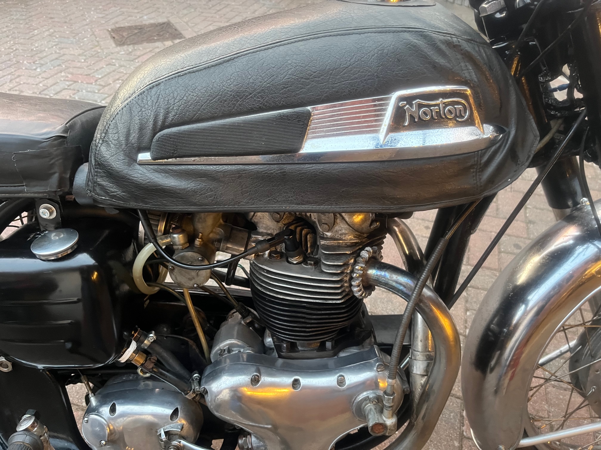

My Atlas is running on BN8ES plugs. I don't think it likes them. Misfires intermittently until the engine is hot and then when I give it some welly the misfire eventually clears and she runs great, and when I say great I mean it. When she's running good this ol' gal has got some horses in there! It has a Thorspark electronic ignition fitted into the KF2 mag with a coil that comes with the kit.
Kicks over first time from cold but needs half throttle to start when its warm. Always starts at least second kick though, and ticks over no problem. It's just the misfiring that's irking me. I have to do a mile or two and then open her up to get it to clear and then running smoothly. Maybe needs hotter running plugs - or colder, can't remember which way it goes?
I haven't had the head off but I looked inside the plug holes with a borescope. It has slightly domed pistons which I reckon are 8.1:1. They're not flat heads and definitely not the standard dish type ones. The spec for an Atlas is BP8ES, the protruding type plug, which would be fine for dished pistons but I don't like the idea of that due to the higher compression pistons possibly hitting them. I might try Iridium plugs and see if that makes any difference. The ignition timing is set to 30 btdc which it seems to work best on this particular bike.
After a fast 20 mile run today I took the plugs out. Left side is black and sooty. Right side a bit better but still too dark for my liking. The needles are already set at the top notch so that's as weak as it'll go needle wise. Maybe I'll have to start experimenting with smaller jets. Or perhaps the float levels. I fitted new viton float needles a couple weeks ago because fuel was overflowing from the right side carb. I suppose I could try setting the maximum float level a bit lower but I'm not sure how to do that in a 389 Monobloc carb? Also, how do I sync the float levels on twin carbs so theyre both at the same level?

The ignoition timing is NOT the issue here. It could be the grade of plugs. You would need ones that are more for akin for town running for a missfire within a few miles from cold. The sooty plugs would be richness which would help cold starting. And rich running could easily be down to worn needle jets as the needles are already as low as poss.
Commando pistons are the…
Commando pistons are the usual replacements in the Atlas ,these are flat top. You have domed pistons ,so the ratio is going to be well over 9 to 1 , Check what is written about ignition timing with Commando pistons in an Atlas. And think on.

The misfiring feels like a plug problem to me. The B8's are probably too cold running for this engine. Also, the carbs may well be worn, or rather the needles possibly are, like Alan said. It's got 27,000 miles on the clock (all of them done over 50 years ago) so a pair of new needles is on the cards.

Higher than std compression pistons would normally need a colder plug. But i dont think we have the full picture on your bike . If the plugs are fouling then its probably oil or fuel and a hotter plug may make starting and warm up easier but risk burning your pistons once running hard.

I've fitted new needles which has made it feel cleaner somehow and more responsive on the throttle. I haven't yet changed the jets (which may well be worn) but for now the new needles have improved it. Whether the plugs foul up again will be determined on the next long rideout.
The bike is still on BN8ES NGK plugs but I've ordered a pair of hotter running BN7ES plugs which I'll fit when they arrive.
My main goal is to get the plugs burning properly with a nice brown colour all the time, not dark or sooty. I'm going to have to play around with it a bit to do that I think.
I'm starting to understand the character of the engine now. It's a tough old bird. I'll mainly be using it for no more than 50 to 100 mile max rideouts and I'll be riding it hard most of the time so I'd assume hotter running plugs will work better. We'll see .......

The engine in this Atlas isn't standard - high compression pistons and smaller engine sprocket and who knows what else has been done to it? (I haven't had it apart so that's all I know right now) What I DO know is it goes like the clappers and it fouls plugs within 20 miles.
Doesn't matter what type of fuel it's burning, the plugs need to be a light brown after a good thrash at full throttle and if they stay that way then the mixture and the type of plug being used is probably correct.
I've got a feeling that with slightly hotter running plugs and the new needles I fitted it'll be ok. If not, I'll play around with the jets and the plugs till it is, maybe even try a couple of Iridium's.
