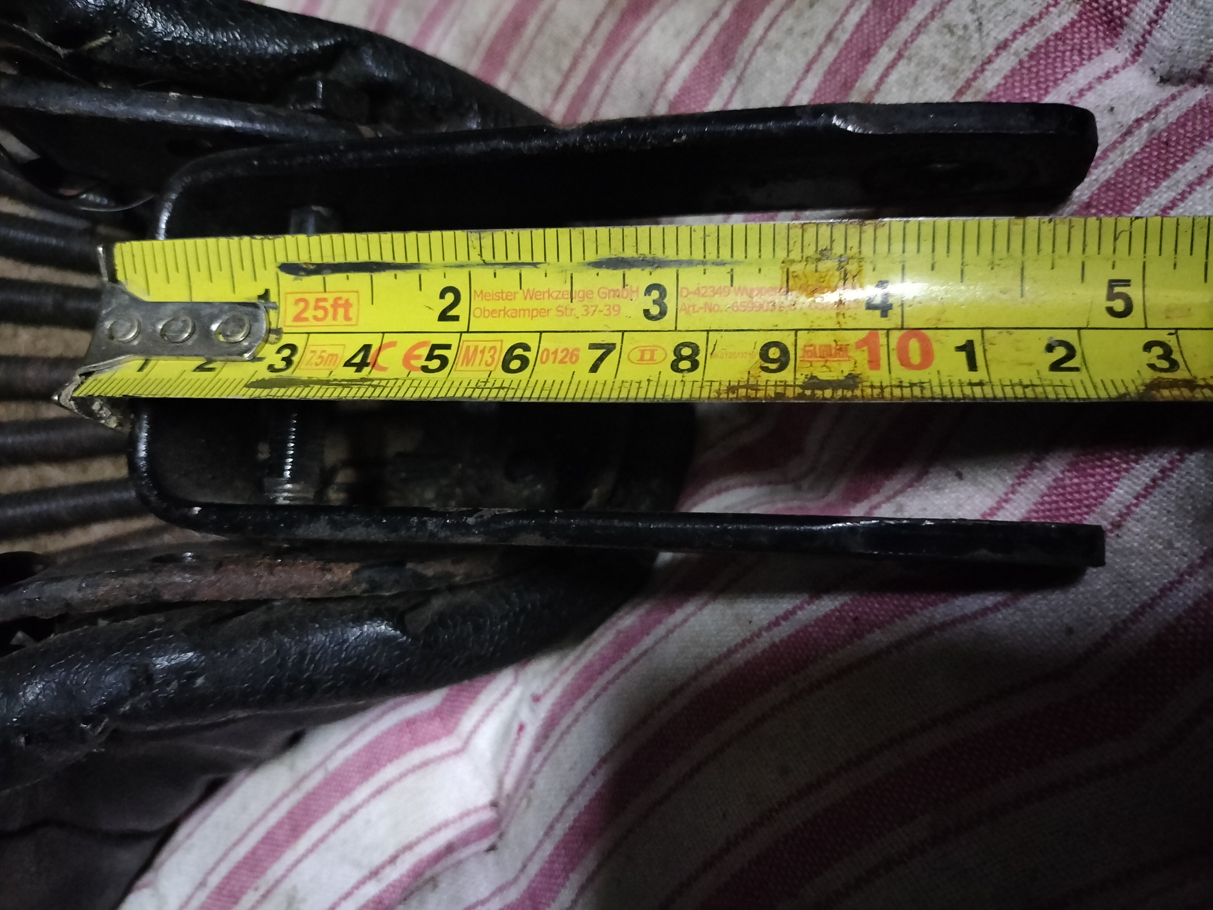

Could anyone with a plunger framed Model 7 (or ES2) post a detail photo of the solo Lycett saddle nose? I have a "replica" Lycett saddle of Asian origin, and need to fabricate the forward pivot mount to the frame, but I don't have dimensions or any idea exactly what it should look like. Unfortunately the Norton parts books are sorely lacking in drawings.

Thanks, Ian. Could you possibly post another view, a little more to the side? I can't tell if the straps are straight or curved, and the tape measure hides the means of attachment to the seat frame. Hope I'm not being too greedy...

Here's a photo of the seat off my Model 7.
I did import some new seats to Oz from Phoenix Motorcycle Restoration Parts in Smethwick, Birmingham a couple of years ago. They were of reasonable quality but the only issue I found was the front mounting tabs were too close together but was easily rectified.
