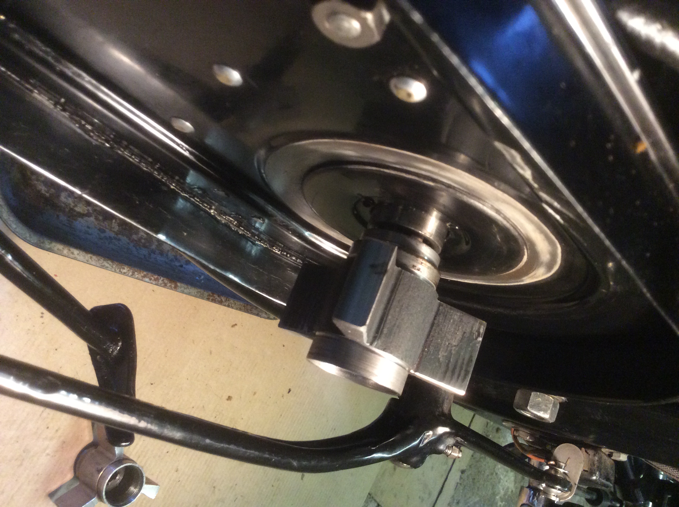

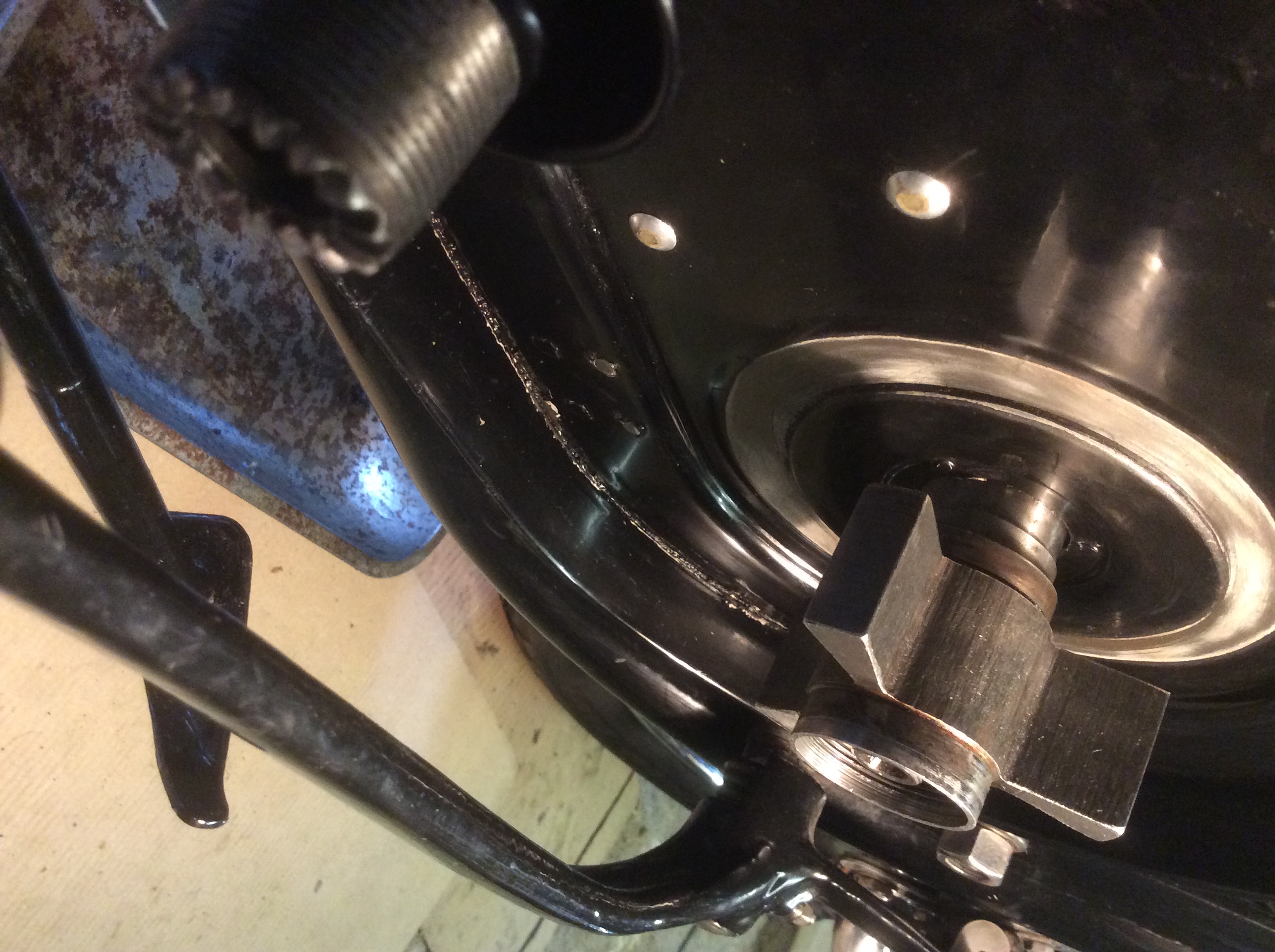

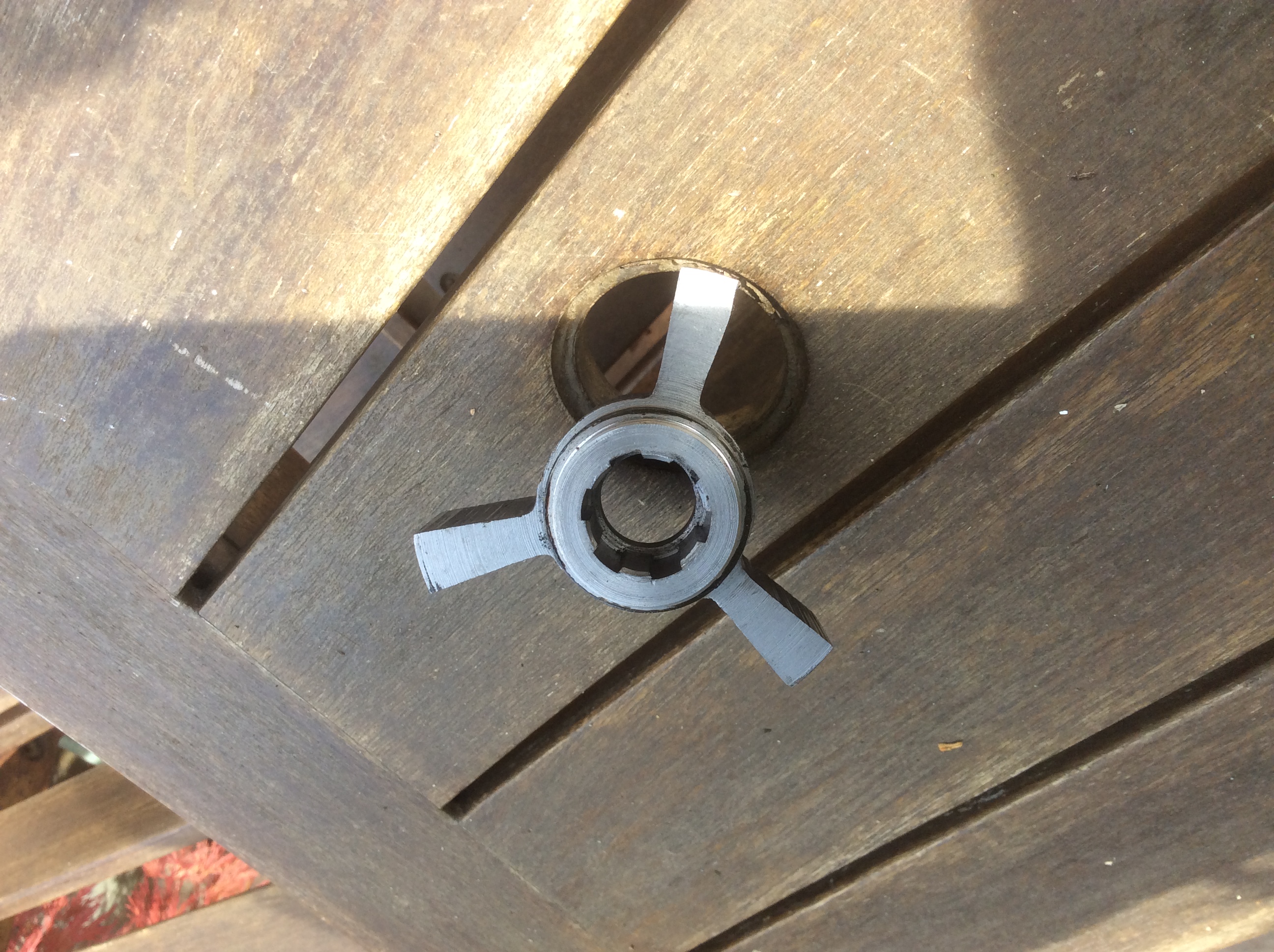

spent time welding up two sockets so that I could get correct torque on gearbox sprocket nut.

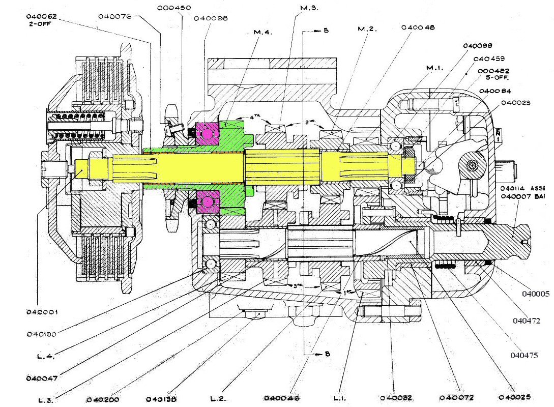

Attachment shows internals.
Dominator box is very similar minus longer mainshaft and circlip grove.

Part if the problem is that I don't think there is a good public domain sectional drawing of how the gearbox and clutch parts all fit together. So it's not easy to inspect for faults.  I've never seen one. And nobody seems to know for certain exactly how the various felt washers fit.

.......this was a handy drawing when it came to sorting my own problems. If scaled properly when printing, you can take measurement right off the print.
