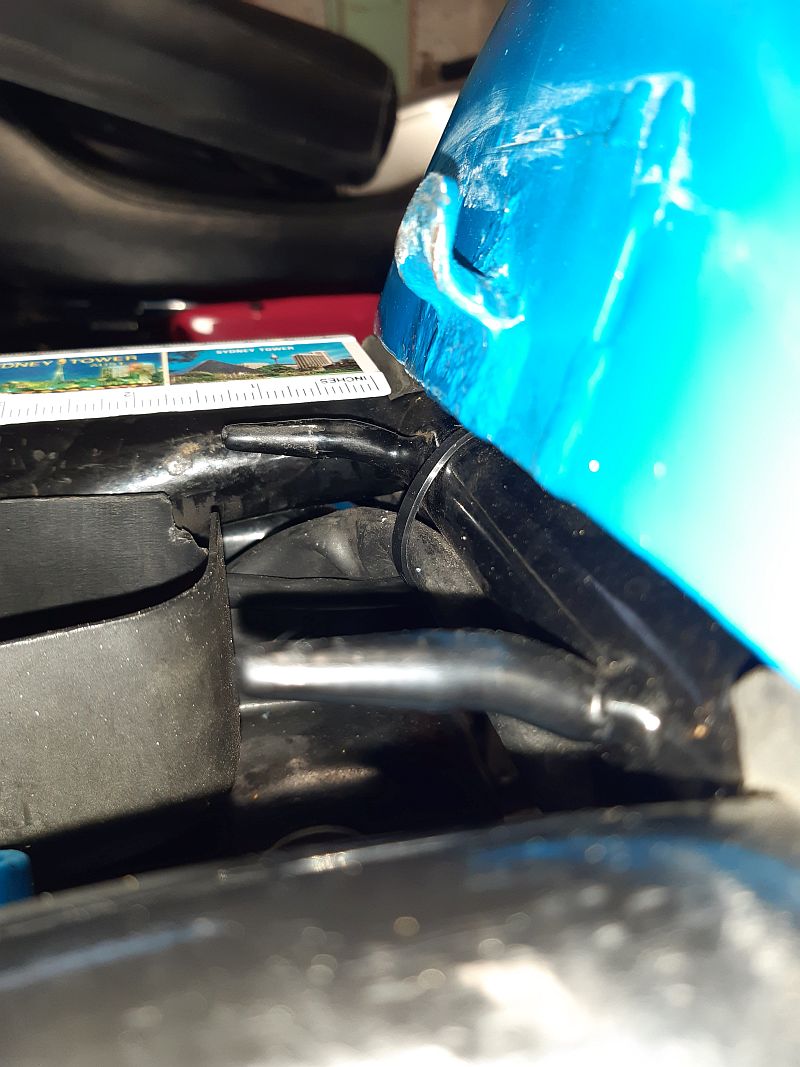

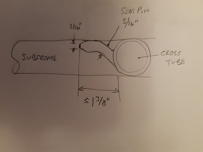

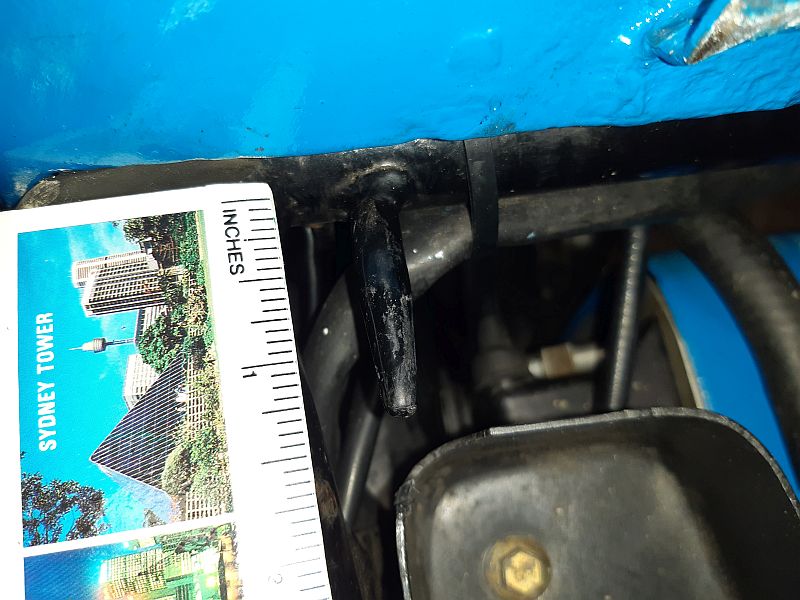

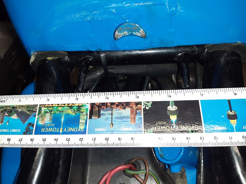

The pictures below are of my 650's seat pins.
Hope that this helps you. The pins are nominally 5/16" diameter, tapering down to around 3/16" at the end where they enter the seat bushes. They are welded (as far as I can tell) on the centreline of the cross tube pointing upwards, and after around 3/8"bend such that the top face of the pins run in line with the top of the subframe tubes. The pins are around 1 3/8" long.
If you need any more info, let me know.
