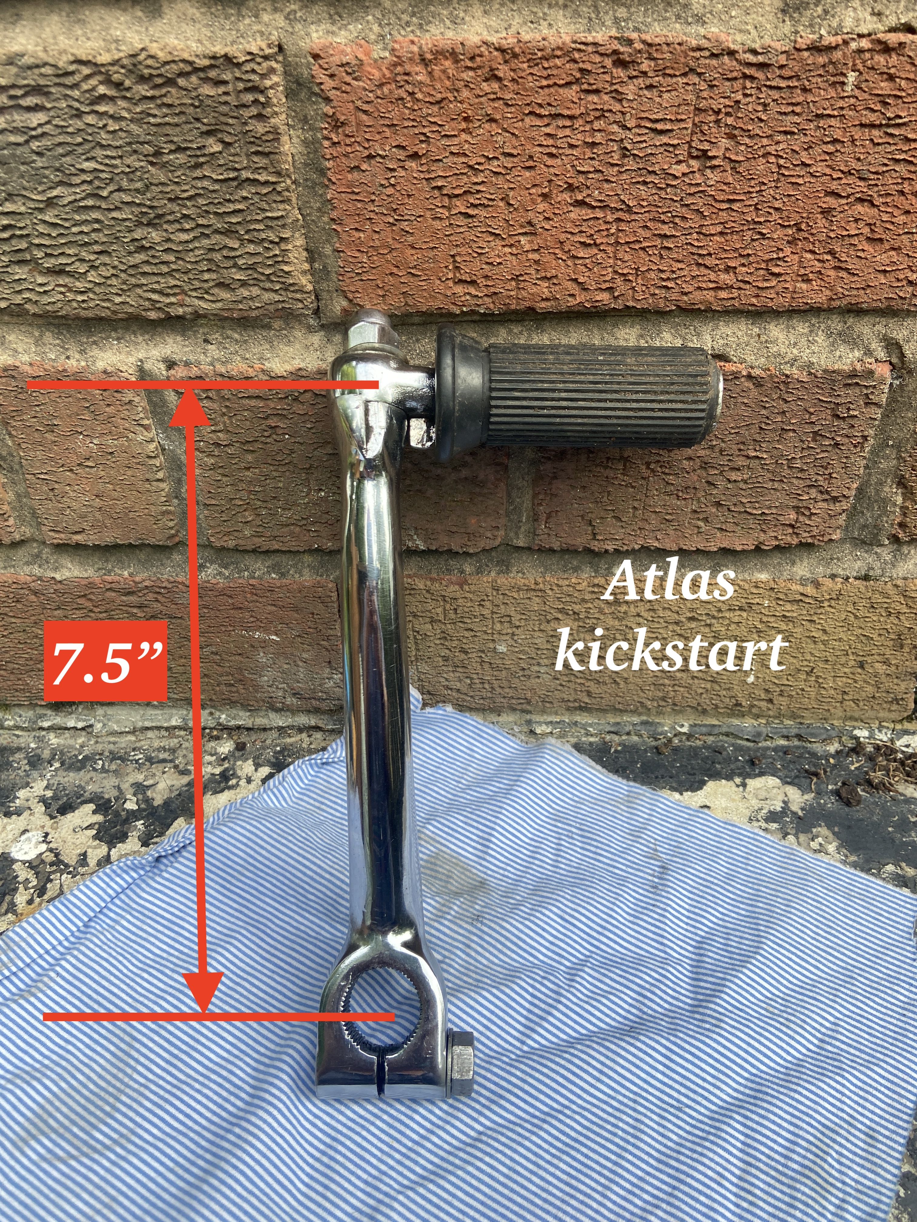

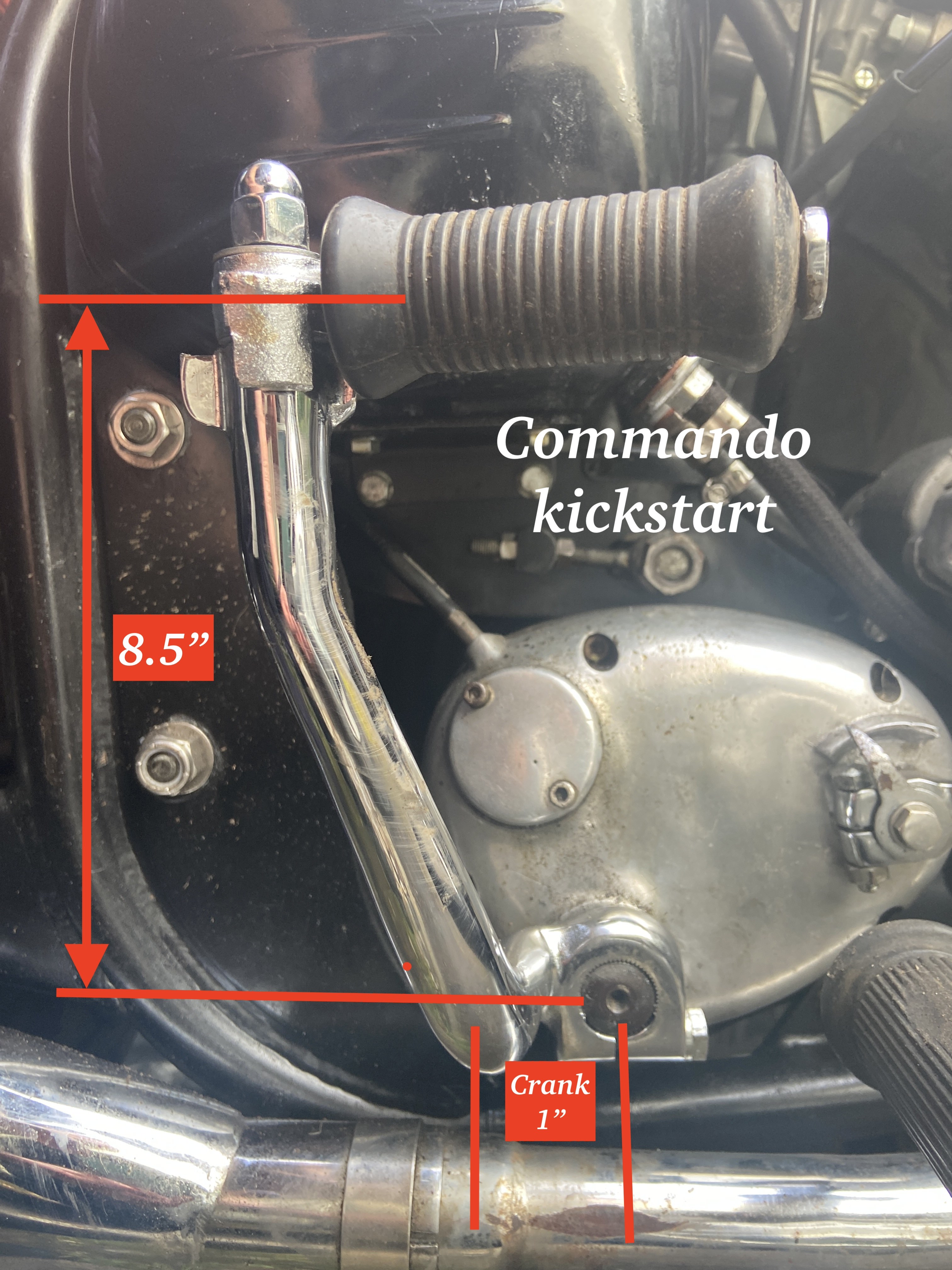

Hi all, 3 weeks ago I bought an Atlas off a mate of mine who cannot kick start it because of his knees. I could start it but sometimes had to stand on the kickstart (and bounce on it) to get it just over the compression. However, it was hard work and sometimes just couldn't seem to get enough leverage on it. We were talking to another mate with a Commando when we noticed the kickstart on the Commando which seemed longer and had a crank. We borrowed it and tried it and I am pleased to say that I no longer have to stand and put all of my weight on the kickstart. I have added some images and dimensions of both the Atlas and Commando kickstart levers. I hope this helps. I also wondering if the 1" crank is helping as well which would give 2.5" additional leverage over the Atlas kickstart.

I've seen Nortons with modern "fold-out" style kickstarters fitted. RGM among others produce these. I've just looked on their website, there is a handy little chart of various Norton levers and their dimensions*. Their foldout version , based it says on the T160 Trident is listed as 8.5" centres, although apparently not currently available due to a tooling shortage. *Link here: https://s3-eu-west-1.amazonaws.com/rgmnorton/fs/pdf/kickstartdimensionspdf.pdf
