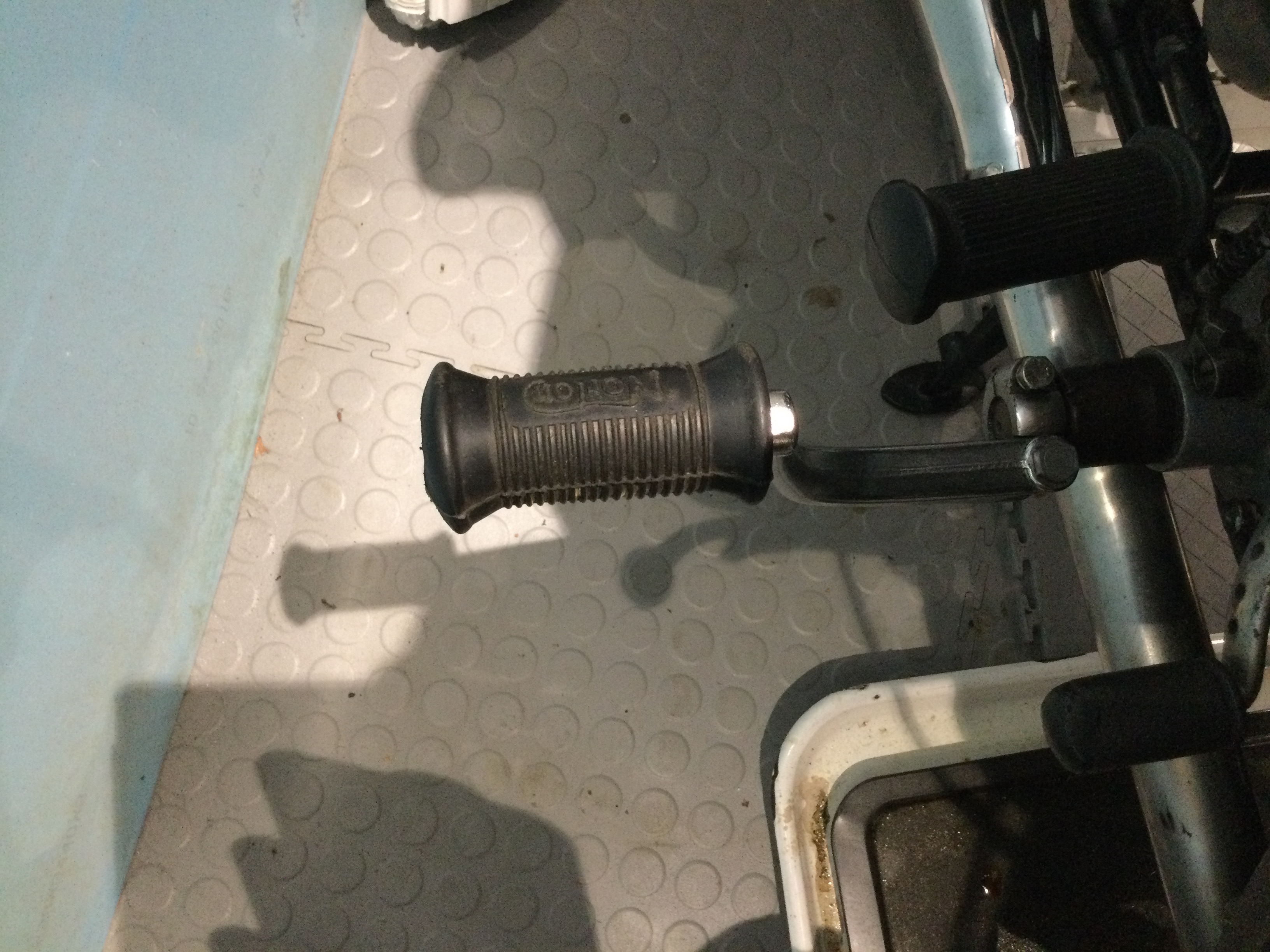

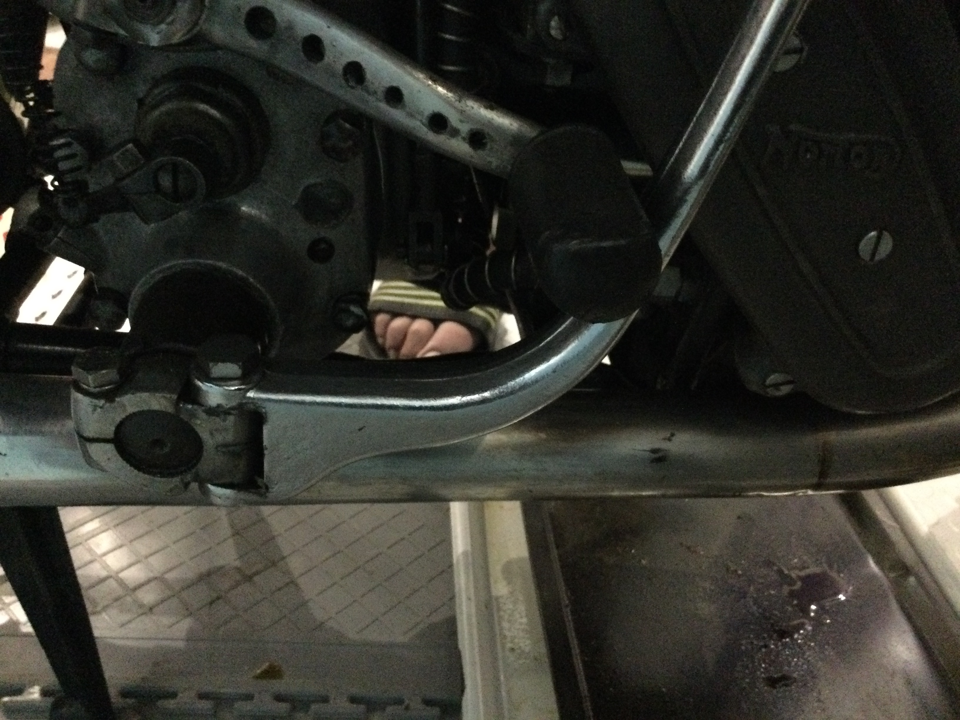

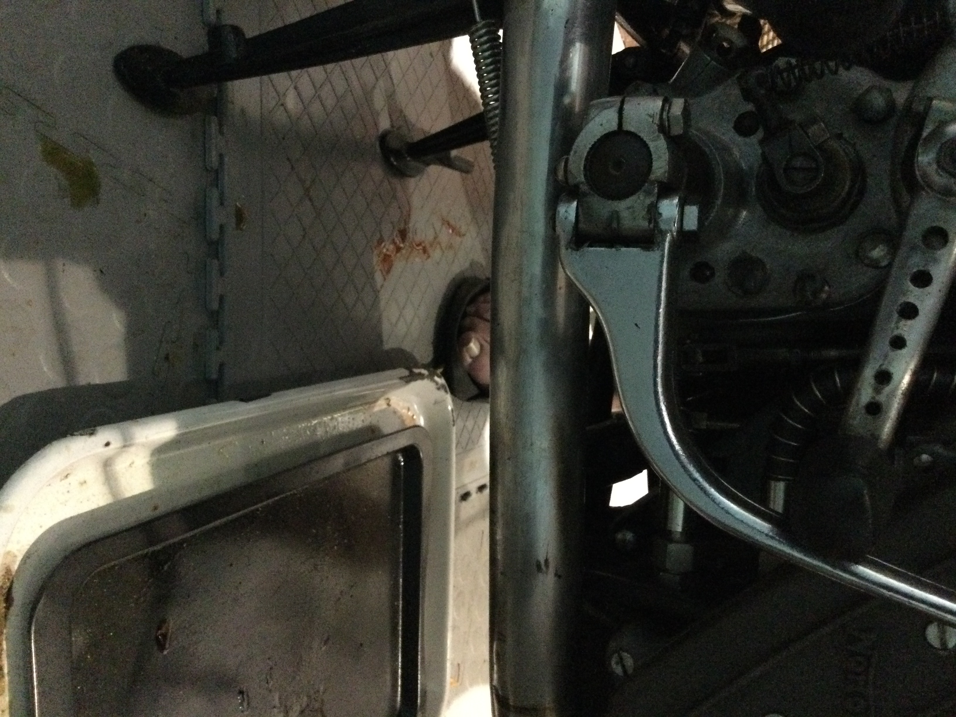

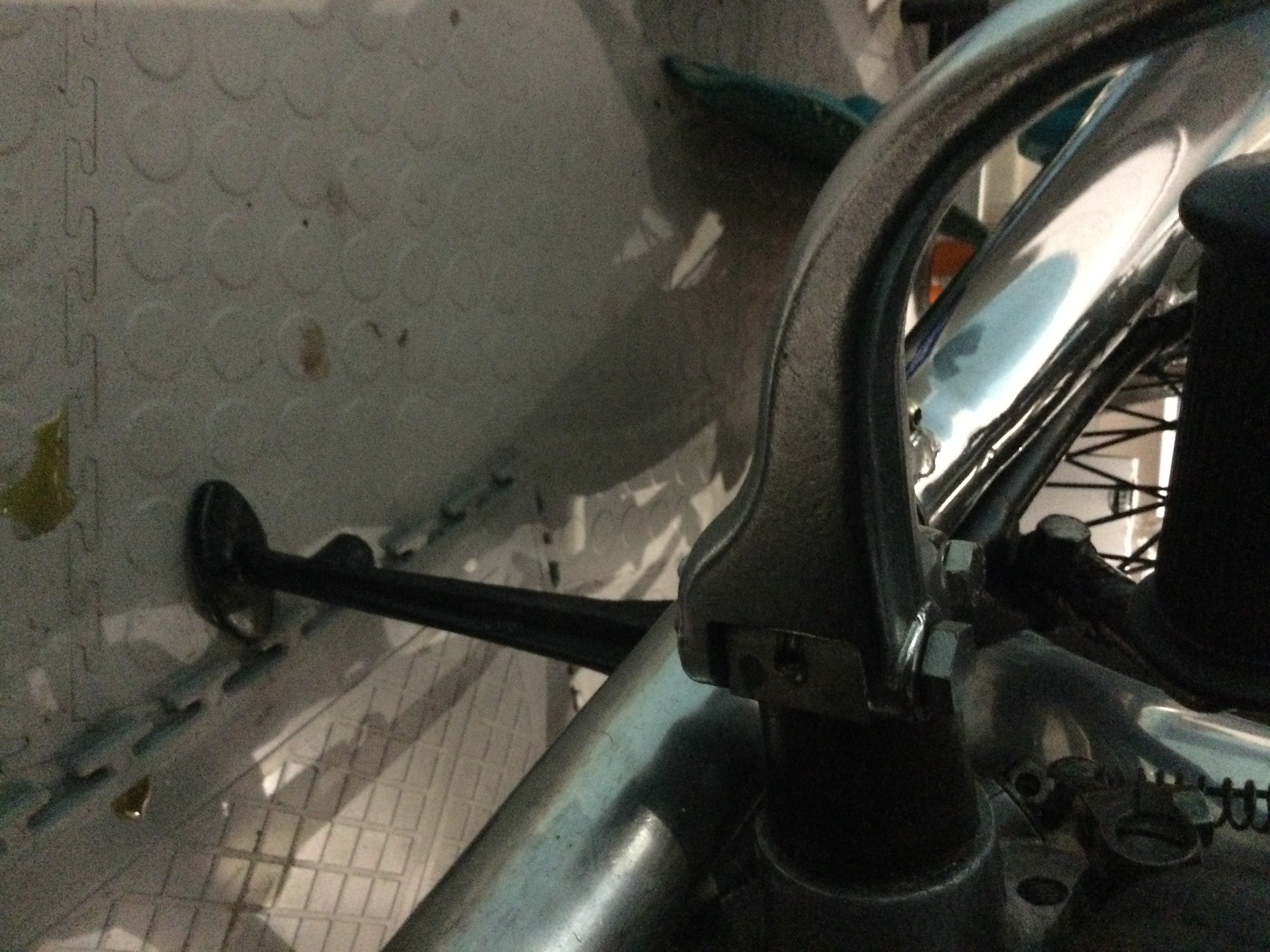

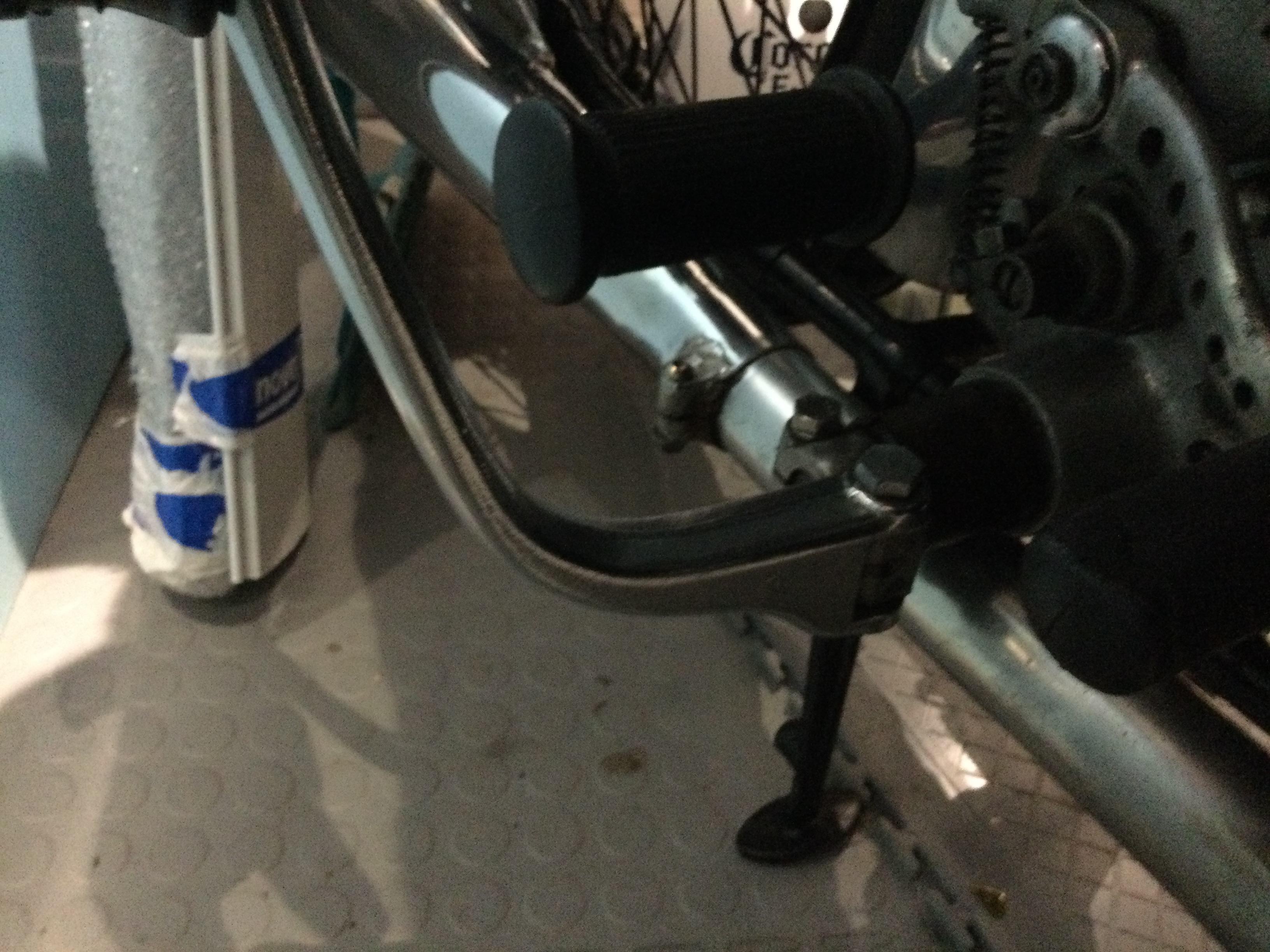

The kickstart lever I want is standard length, folding, but one which tucks in closer to the bike than standard.  The one I have is non-folding, angles outwards at a shallow angle until it is more than 2" out from the spindle.  What I want is a lever which angles outwards fast, to clear the exhaust pipe, but no more than is absolutely necessary.
My lever has annoyed me from the day I bought the bike.  Because it angles outwards at a shallow angle, it hit the exhaust pipe, and then goes way wide.  That affects balance when you kick the bike.  Take a look at a 500T if you get a chance - the lever is totally straight.  Being narrow helps in lots of ways, as long as it clears the pipe.
To stop my kickstart hitting the exhaust pipe, I moved the silencer mount behind the frame lug instead of being outboard of it.  Problem solved, but the bike looks very asymetrical as a result.  The kickstart lever is still rubbish. Oh, and the factory records tell me that my bike should have a folding lever.
Usually have a knuckle at the lower end of the starter as the exhausts tended to stick out a way.   I will take a picture of mine when I get home tonight.  It puts a fair bit of load on your jack shaft,  make sure your cover is well secure.
