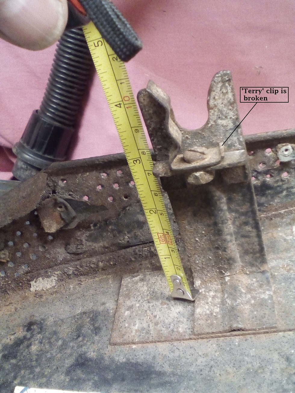

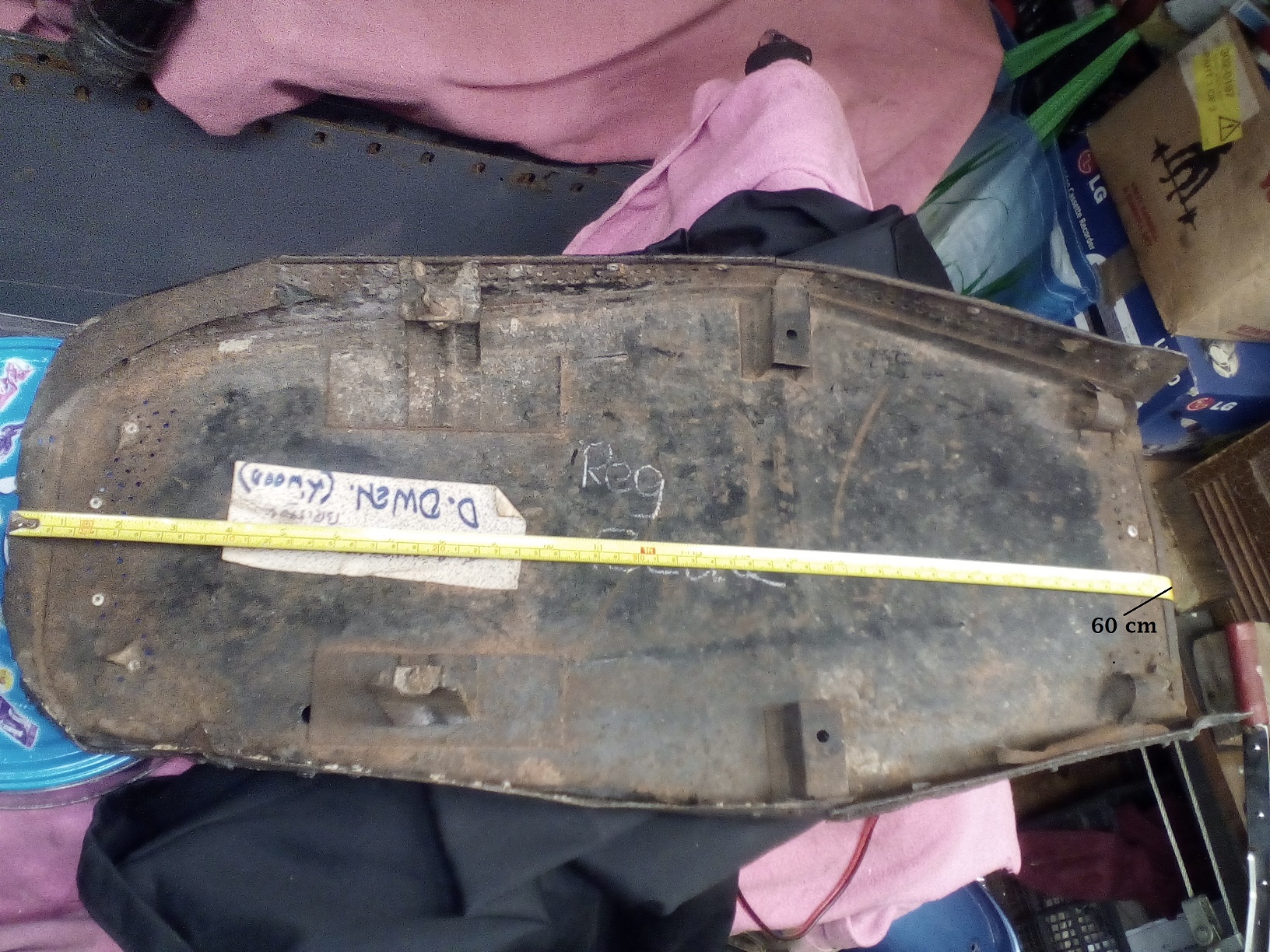

Hi Andy
Thanks for your reply.  Its a 1959 Jubilee DeLuxe with terry clips. I got my seat pan from under the bench with the intention of sending it to Leightons this coming week for new foam and cover when I noticed it had no fixings, its about twenty years since I had a look below the the seat . I was thinking that a long bolt could pass through the seat pan and the spacer and then the terry clip, I think the terry clip does have a hole for a bolt. Does this seem possible. Parts say It is a seat spacer but the description does not say where it goes or give any sizes.
I could make some L shaped brackets and then fix the terry clips to the brackets. But if the spacers do the same job, that will do.
