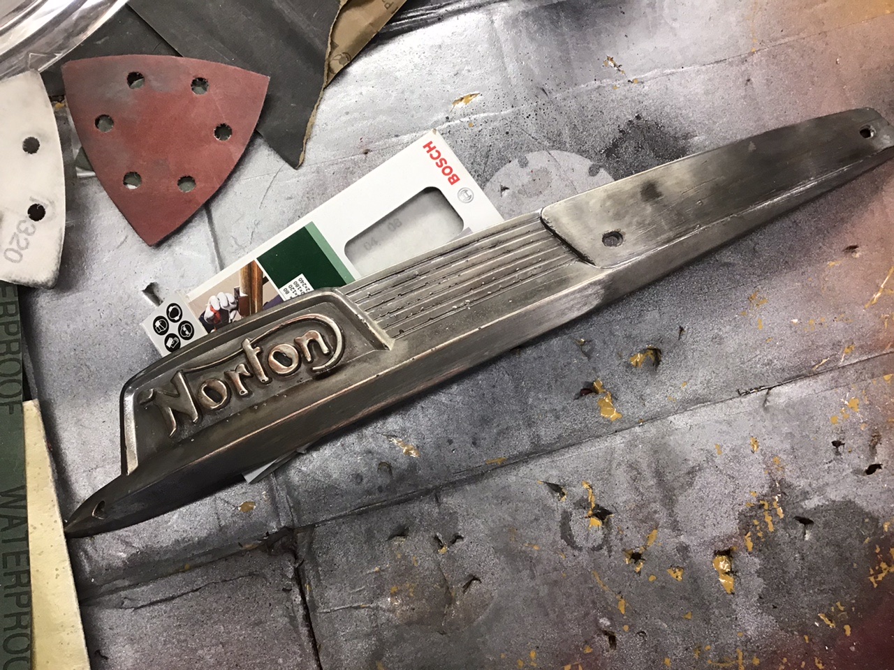

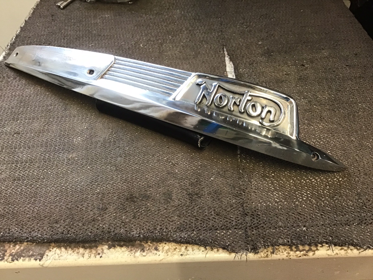

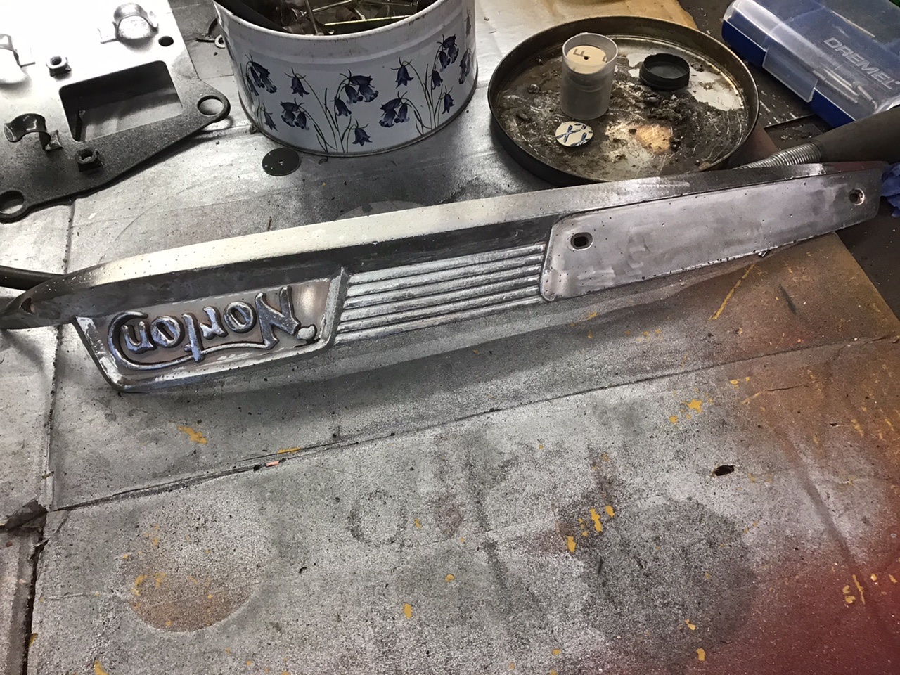

Hi Dan - lots of hard work. Rotary wire brush, sandblast, rotary sander, sandblast, dremel sander, file, wet & dry. Then buff!!!! The second one I’m doing doesn’t have a lot of chrome left on it thankfully. Didn’t do the inner surfaces - seemed irrelevant!
Not sure whether to have re-chromed or leave as bright mazak (zamak?) - after all they’re mostly zinc and polish up well - then try laquering. Chroming would be better for originality but struggling to get responses from chroming companies that say they can do it!

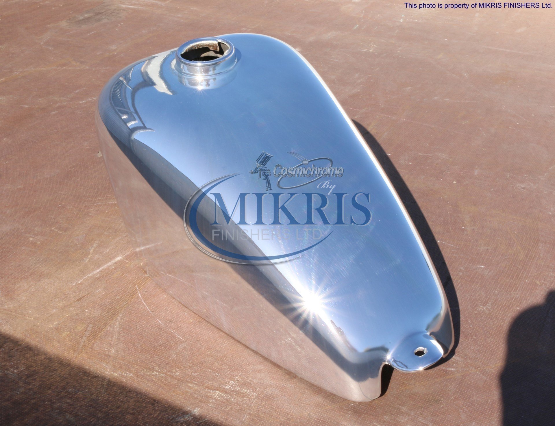

I am in the process of getting my Navigator tank badges ready for re-finishing, as commented above I looked into having the chrome chemically removed and was advised against it by the chrome company, so I have mechanically removed the old chrome which was not as difficult as I was expecting. I have been left with lots of pits and damage from the rusting old chrome which I plan to fill with car body filler then have them chrome sprayed by "Mikirs" in Stonhouse as they are not too far from Cardiff; the finish shown on the website looks good and the cost I think will be around £60.
www.mikris-finishers.co.uk
Mirkirs spray "Chrome"
Steven:
Is the tank shown in your attachment actually "chrome sprayed"?
If so, it is a great alternative.
I think its sprayed and if…
I think its sprayed and if my badges come out to that standard I will be very happy

Yep, it’s in my watch list - not sure (yet) whether I’ll need it as already have a pair + one RH spare. Just de-chromed & cleaned up the spare RH one, now working on LH one - just got to keep fingers crossed it’ll come up the same as one I’ve done (see pics).
Don’t really know where to go/what to do with them once both are “polished” - anyone got a recent chrome company that’ll do them?
