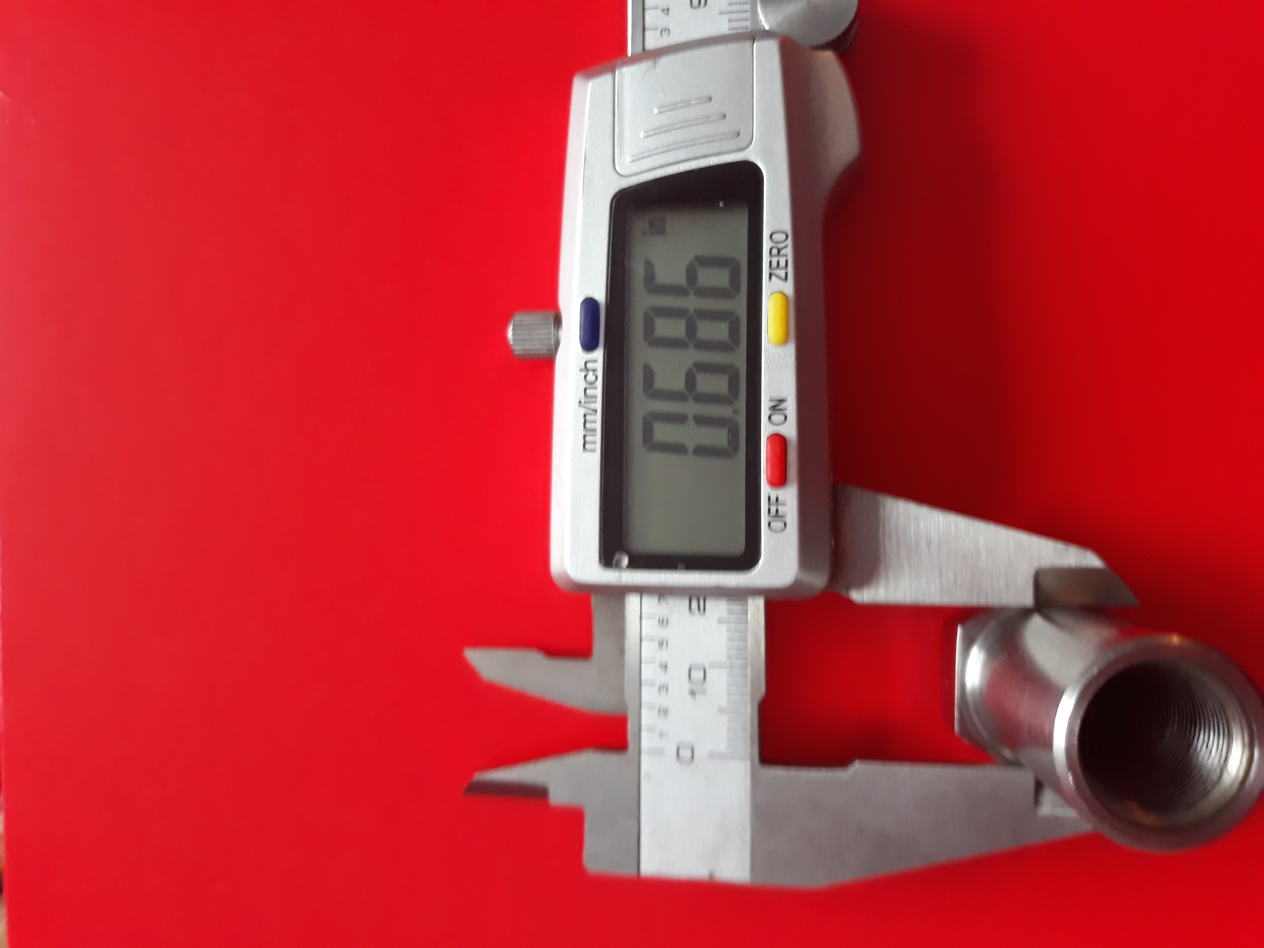

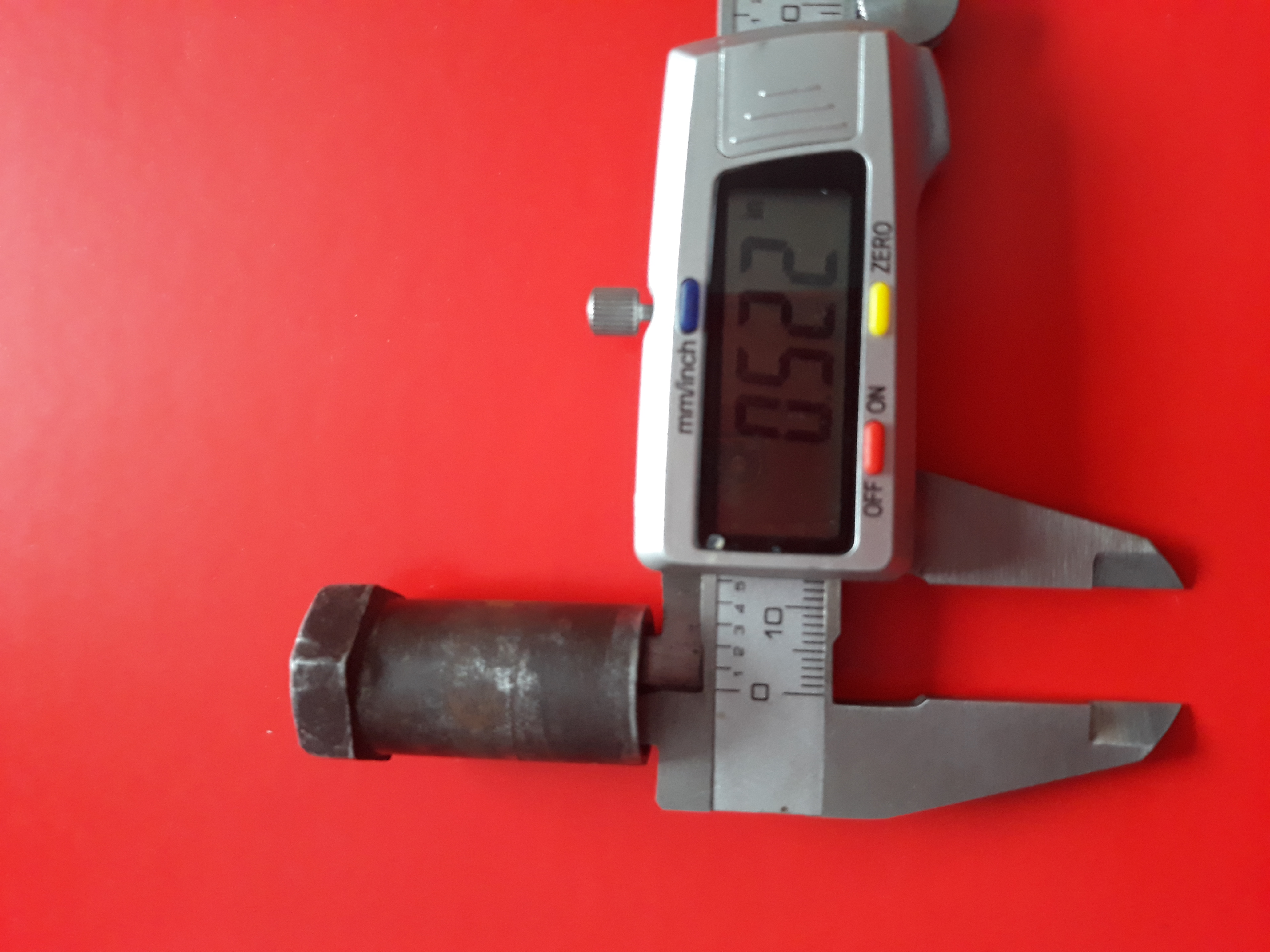

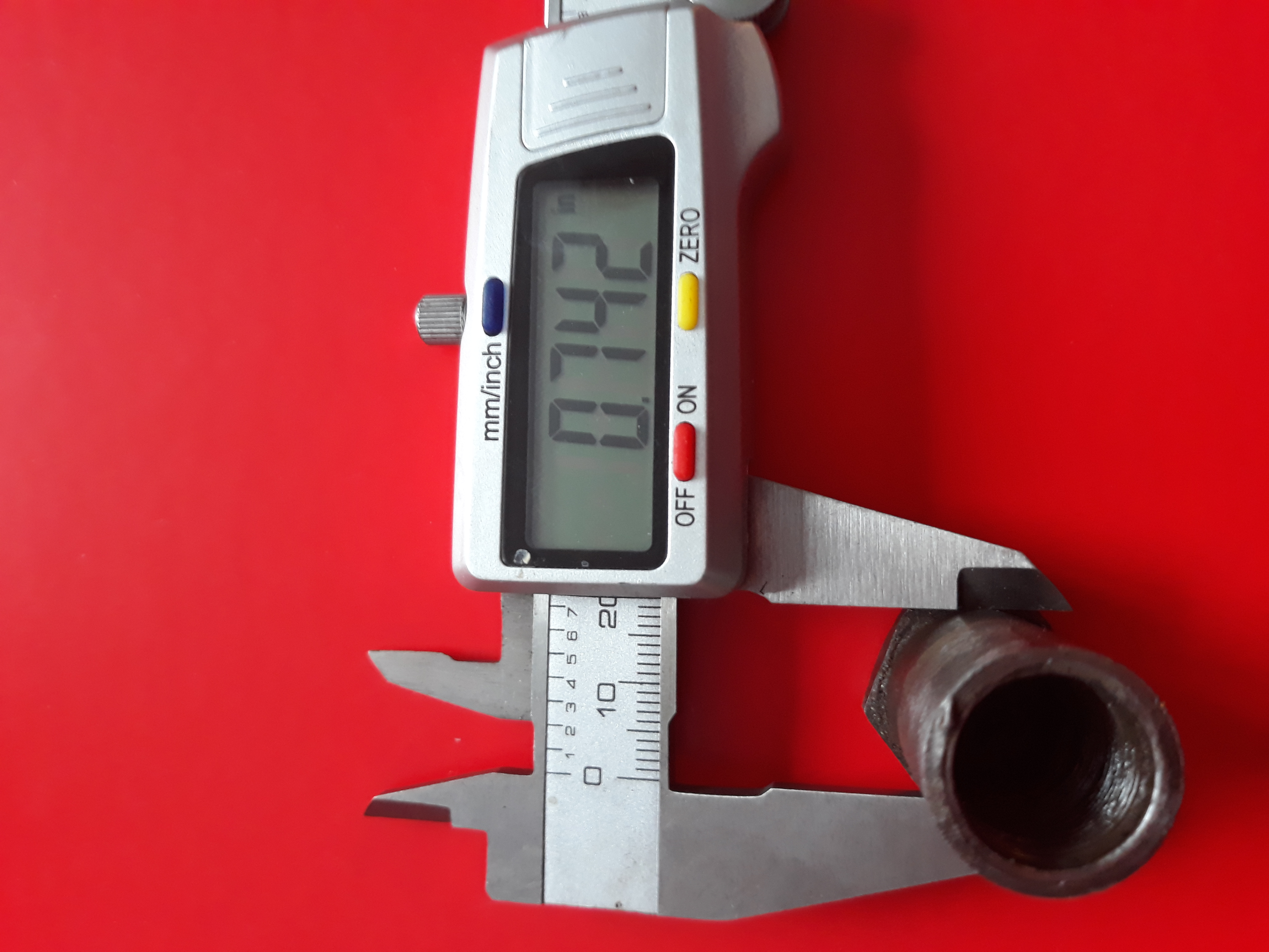

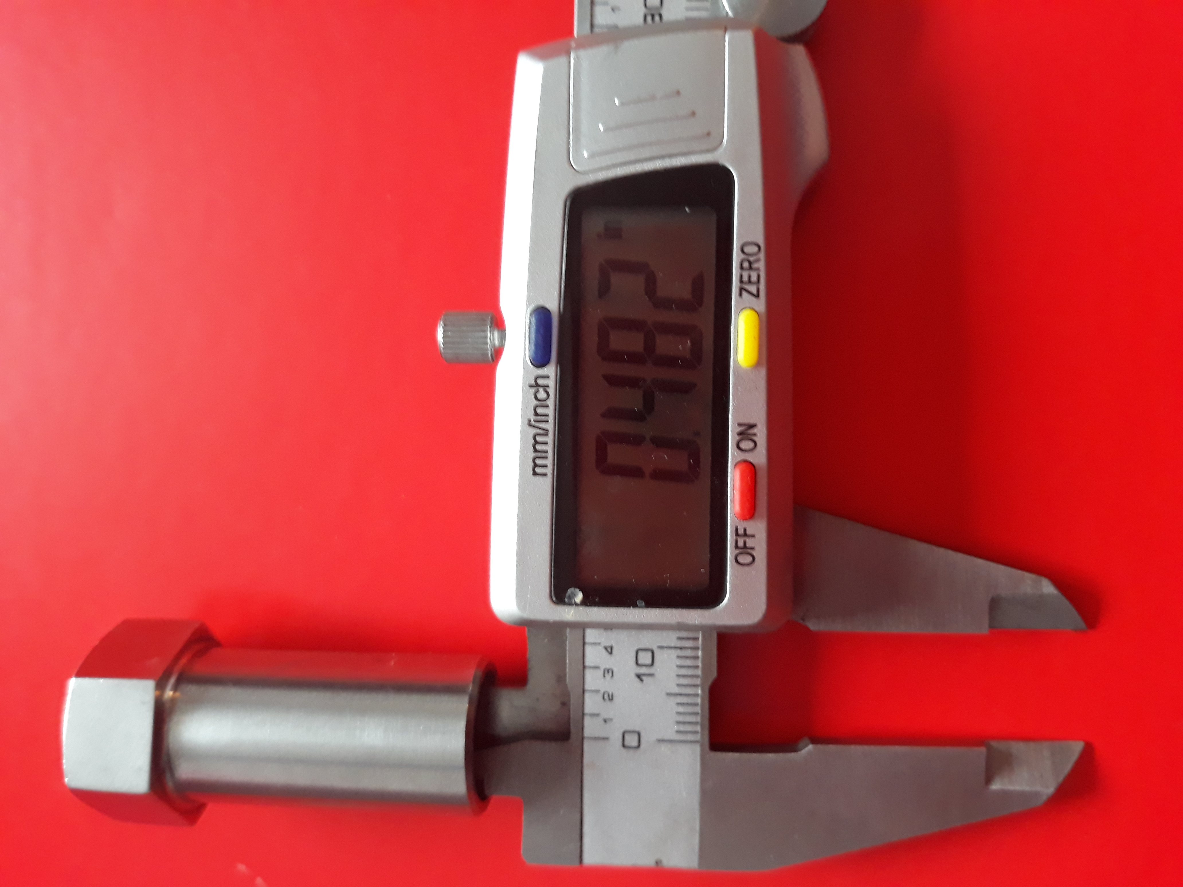

Ordered a pair of front wheel nuts in stainless steel for My 1959 jubilee from the N.O.C spares dept. .  got some nuts that where the original part number apart from the number starting with SS for stainless steel. The trouble is they are not right, I e-mailed the spares people from the 26th of April explaining the problem, I hope they can get it sorted and Know that they can take a while to get back.  In the meantime I ordered a few other parts that came pretty quickly, but alas no info on the nuts, or maybe i am going Nuts.
Just popped  a few pics on so you can see the differences.

Yes it is strange, I got some rear wheel nuts at the same time, they are fine, but the front nuts that they sent fit the front footrest hex bar that has a slightly smaller thread. I sent the pics and they are looking into it.
