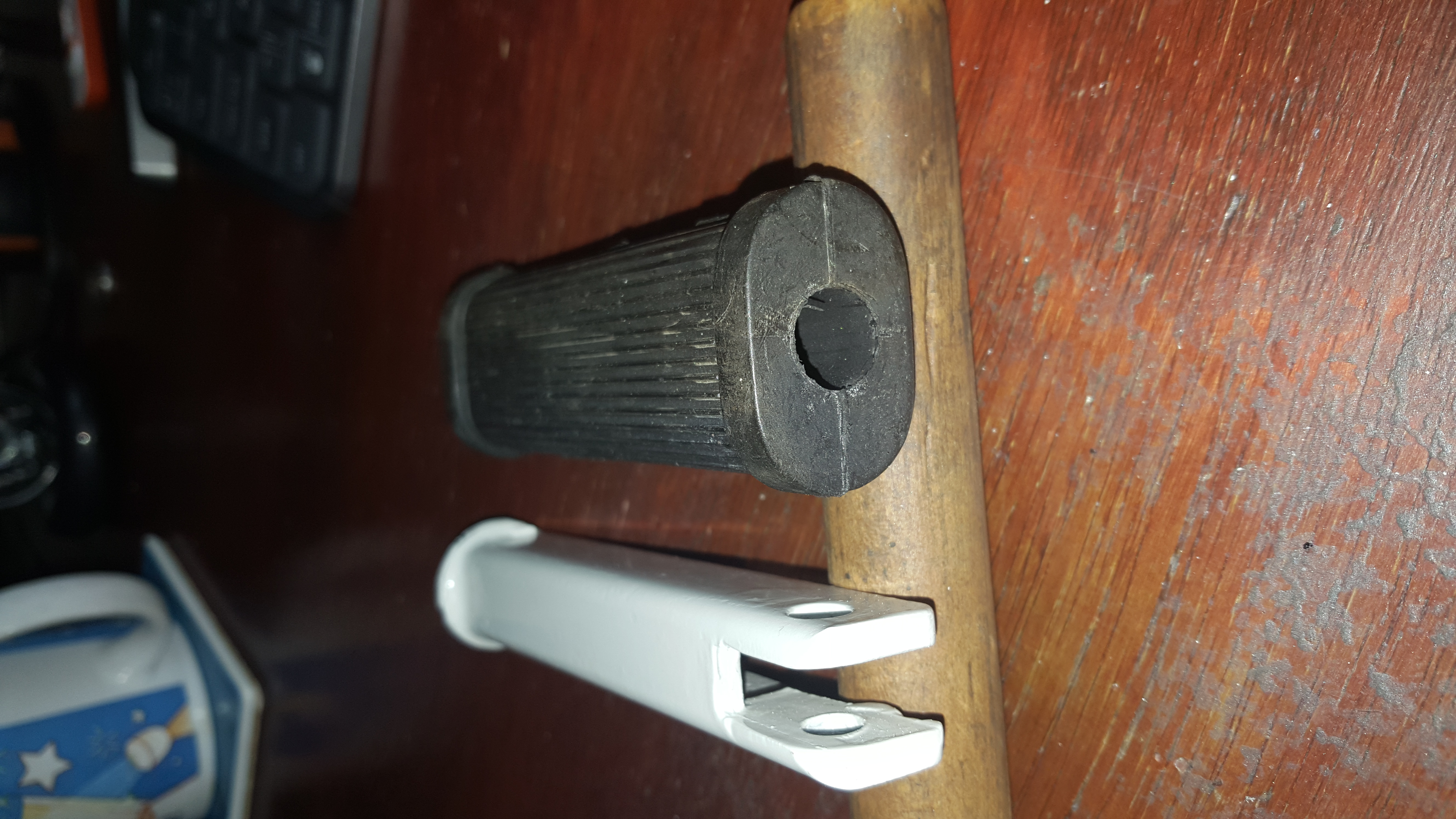

Picture of Jubilee rear footrest and new rear flat rubber. Do all lightweights have the same rear footrest as in the picture. Obviously I,m not going to get this rubber to fit, yet according to the parts list its the correct one.
John.

The footrest shown is completely different from the ones on the Electra  Bryon

With so many changes by Norton/AMC to the lightweight model range over it's 7 years it is difficult to definitely say what the correct footrests for your Jubilee are. You don't tell us the year of manufacture.
I agree with Bryon that yours are different from the Electra rear footpegs.
I know the flat pillion footrest rubbers were fitted to early lightweights as Nick suggests.
I know first hand that when not properly tightened the footrests fall off and any footrests with a 3/8 or 10 mm hole can be fitted in it's place. Just like yours in the photo.
The proper footrests are waisted to allow the rear brake rod to pass straight between rear brake arm and brake lever without fouling footrest.
If you go to my post about on 'Navigator Frame Painting' I attach a 'word' document that has clear photos of the correct, early, Norton lightweight footrests.
https://www.nortonownersclub.org/node/11459
Glad you found some rubbers to fit your footrests. They were not fitted on your bike when it was new. Now you know what the footrests should look like, you might find some similar waisted ones on that auction site if the brake rod fouls.

Peter, thanks for the picture .
Your footrests are very different to mine. Does anyone know what bike my footrests came from.
Ive had the bike for over fifty years and it came with the footrest as in the picture!
John.
