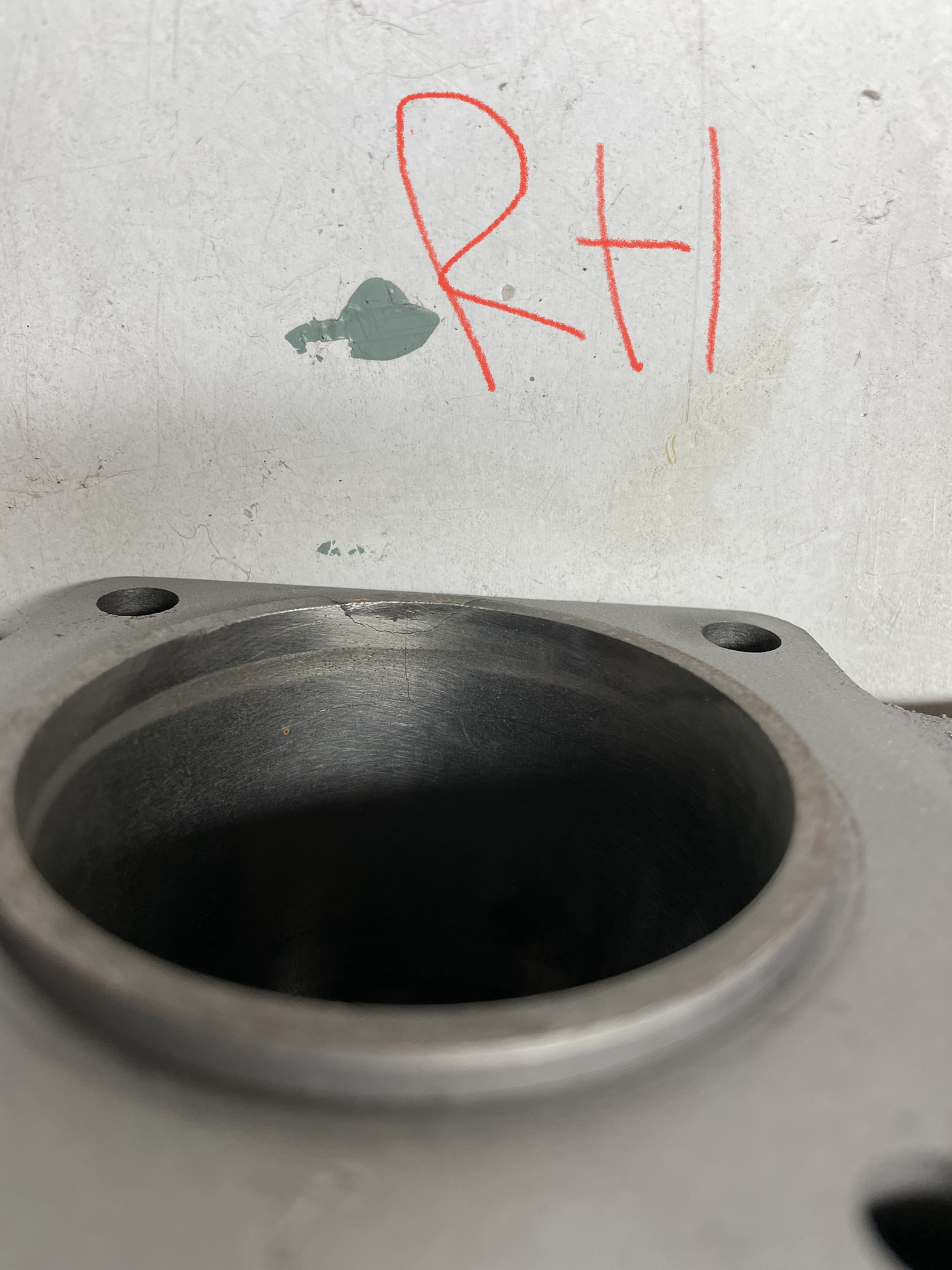

Hi all,
Just had my heads & cases all cleaned, now found what looks like cracking in the barrel liners. Anyone know if they can be replaced or repaired?
thanks
Ouch! I’d say that has been hit or dropped sometime in its past, never seen a crack like that.
What bore is the barrel on? A secondhand one might be an easier bet?

Given that Jubilee pistons are as rare as hens teeth you might want to re-sleeve the barrel and bore to the size of your piston if it is in good condition.
Dennis
Thanks guys, yep I believe the engine seized a little while before it was retired - 45yrs ago! But I’m told it was running quite happily before!
it’s currently standard bore - no oversize
no liners in NOC shop at the mo, only a LH barrel, unfortunately this is the RH barrel! Will speak to meridian and see what they say.

Hi Kieren,
The barrels may look like they have liners - BUT THEY DO NOT.
I cannot imagine how yours got damaged.
It looks like you may need to find another barrel, or have a liner fitted to yours.
Depends on size, & if other side is damaged. Do not run with odd sized pistons (I have seen it done) - keep both pistons the same.
Left & right barrels are slightly different - but can be made to fit either way round, if it helps.

In the photograph that Kieran submitted in the original posting, the "crack" appears to be above the travel of the rings.
Since this is in a non-stressed area, could not the area just be welded and ground back to flush?

Hi Michael, I too thought that and if that is the extent of the damage I agree with you. However, (and hopefully Kieran might confirm), it looks like the crack runs down and then around the bore? If this is the case, then even a liner might be risky as there may not be enough support or good enough interference fit possible to get good heat transfer.  If the crack is as I think it is, then the respondents who say its new barrel time are, to me, right.
Regards, George.

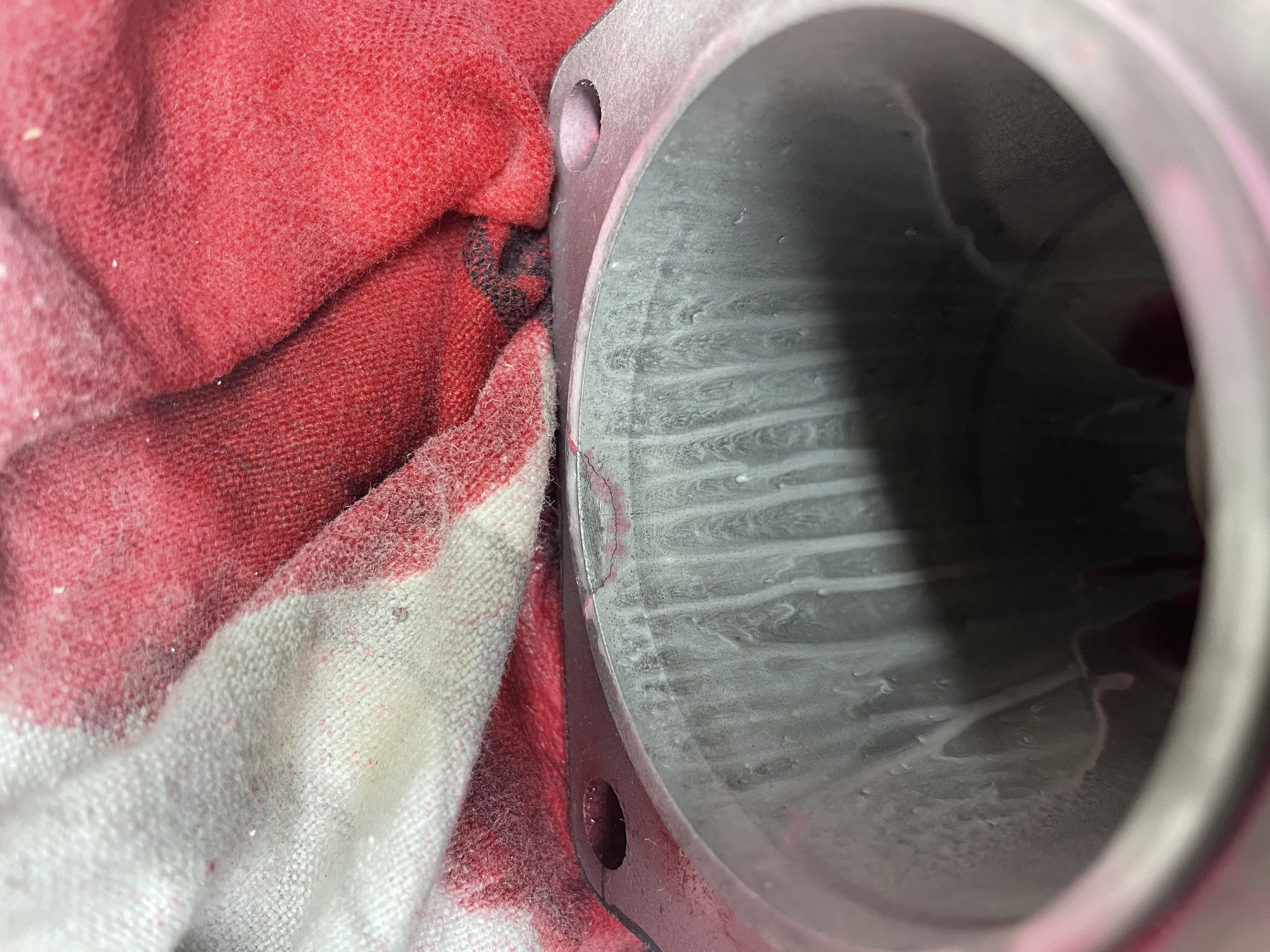

Meridian have told me they can line the barrel for £130, but in the meantime I have done a dye penetrant test on the barrel with the only crack being the smaller one at the top, see image.
I’m going to speak to meridian again about getting the barrel welded & bored like you mentioned.

A repair as Michael suggests should be quite an easy repair for them to do, and hopefully at a lot less cost for you. Just make sure the outside of the spigot is dressed back too.
Regards, George.
