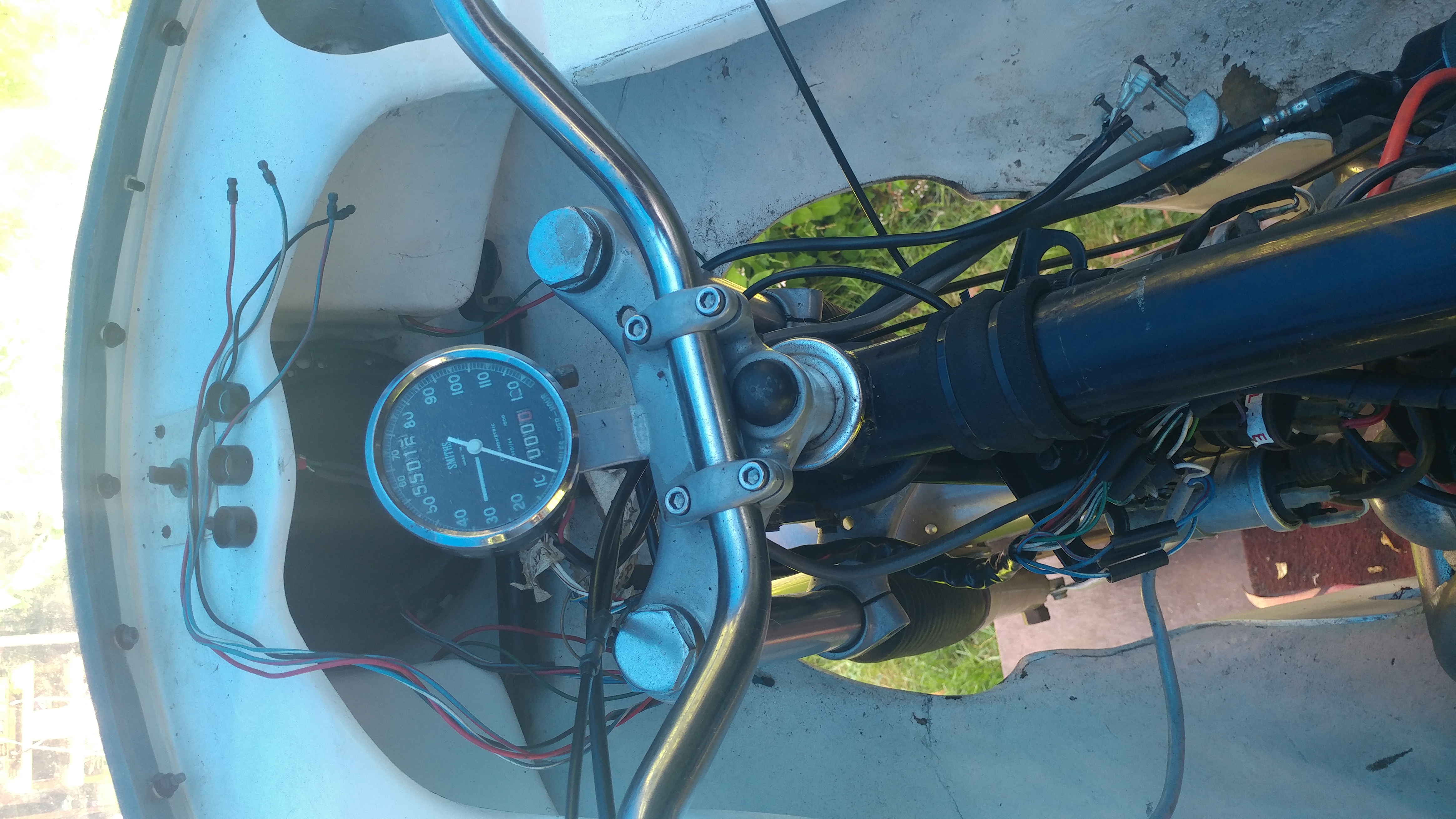

Info or tips on a route for wiring and connectors to a 74 mk2a Interpol with fairing would be very welcome. Thanks.

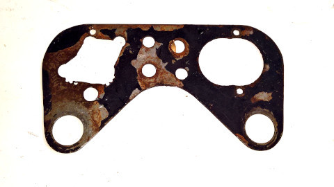

Assuming the plate merely…
Assuming the plate merely shields wiring below both from wet and from sight then I can think about sourcing one to simplify things further, or get creative and like your idea of gluing cable ties. There are two almost glovebox like recesses that I can't see any obvious purpose for, except perhaps stuffing your gauntlets before issuing a speeding ticket? Thanks.
This is the plate.
Just a piece of 2.5mm (12 gauge) steel plate. I hacked the hole on the left to fit a tacho; originally had blue light switches etc. there. All police equipment had been removed before I got it. Can't remember why I didn't fit standard Commando speedo/tacho holders - perhaps they hit the fairing.
Thinking about it, if you're handy with fibreglass, you could build a nice instrument console into the fairing and hide all the wiring in there while you're at it. And some covers for those recesses would make them useful.

Thank you Stan for photo. I…
Thank you Stan for photo. I also saw one online today for €90 but.. I will go with the creative route, no pun intended. I'll have a bundle of half a dozen bullet connectors which can live beside the headlamp shell protected by the fairing, which incidentally didn't come with the bike. The small bracket for the speedo did though, and looks well fabricated so could be 'original.' I have had the bike for 15 years and everything is now mechanically A1, I think but have only recently passed my test so it's time to find out!?

Mine, also '74 Mk2A, direct from Somerset&Avon, had a steel plate attached to the fork top nuts that supported the speedo and idiot lights. Looks like someone tried to neaten it up by fixing the speedo to the fairing bracket and moving the idiot light. Nothing even remotely subtle about the wiring: 4 wires into the headlamp shell and 2 wires to each indicator lamp.
You could do a nice job with some PVC sleeving and glue-on cable tie supports but it's a blank canvas for you to play with.
