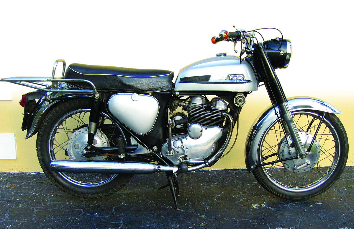

I too prefer the Hella bar end turn signals. Each side has both front & rear lenses, so no need for 4 turn signals for front & rear. I had them on my /2 BMW & loved them, and were standard fitment on my Electra as well. I think the electra was the only Norton with a Hella part from the factory?
Anyway, the units fit insside the handlebar & when tightened up, expand outward for a tight grip. The genuine Hellas have a small rectangular bit, that fits into a small notch you cut in the bar which keeps them from rotating. The replica ones dont use the notch feature.
The single wire from each lamp gets fed inside the handlebar to the center bottom of the bar, where you drill a small unseen hole & file the edges smooth & the wires from both lamps exit the handlebar at the bottom & can then easily end up inside the rubber grommet on the headlamp where all the connections get made. Nice & tidy.

Well that is different Skip, the Stag look!, won't work for me as I have very restricted access and have to fold the mirrors away. I also have the habit of leaning the bike against the wall as I don't trust the side stand and heaving the bike on center sets off the bad back.Must get the frame stops welded up and the side stand extended. I also like BIG bright rear indies as there is real risk of being ended by texting dozy cagers.Helmet mounted antlers with christmas tree lights might?? get noticed. Possibly.

I was looking at those indicators at Bristol, and was wondering if the view gets obstructed by the rider at all?
